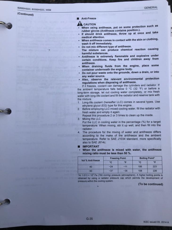

I was looking for some clarification, on flushing the radiator and refilling.
On page G-34 of the service manual on line 4 It says to fill with clean water and cooling system cleaner, etc etc.
On page G-36 on line 6 it says When the LLC is mixed, do not employ any radiator cleaning agent….if mixed sludge may build up.
I don’t understand how it says to use a cleaning agent at first, and then it says don’t use it if I’m using a LLC. Does it come from the factory as LLC, if so should I not use the cleaning agent? Is there a way to tell if a coolant is LLC or not? I don’t get it.
I also have a question about what percentage I should use to mix. On page G-35 It says it must be under 50%, and shows a 40% info box.
So whats the best percentage to use? 40%? Is there a graph of different percentages people use to gauge the ratio?
On a side note a 1/2” flathead screwdriver worked to remove the drain bolt safely. I ended up damaging the drain bolt tip a bit originally with a 3/8” screwdriver. I ordered a JIS #3 screwdriver as some had said and it wouldn’t grip well enough on my damaged bolt head and proved unreliable. I managed to remove the damaged plastic drain bolt by pinching it with my fingers just past the grooves. It came out without any problem and replaced it with the new OEM bolt.
See attached pics of the manual for reference.
Thanks!

Sometimes Kubota manuals are worded very poorly. In this case I believe they are saying :
If using a flushing / cleaning agent, do so by mxing with water only, not with the old coolant or newly replaced coolant.
Don’t mix coolant types
Concentration should be max 50% and min 40%
I have never heard an oem refer to 2 year interval coolant as LLC as in your manual. My last 4 Kubotas came with standard green coolant, which was replaced with a longer interval coolant (HOAT is my choice)

Thanks for the replies that clears things up a bit. I'm going to use the Kubota LLC brand to do the refill.
