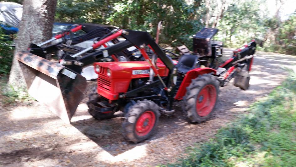

Took the plung on an L225DT with FEL and backhoe w/ about 50 total hours.
Story is seller's father-in-law bought it new, installed a spetic tank and parked it.
Little rust here and there (leaky roof) and missing a few lynch/hitch pins.
I'm going on the assumption it's never been serviced.
Guessing 15 gal of UTD, 2 gal of 15-40, plus filters should be enough to change out the fluids.
Planning on installing a ROPS.
Any words of warning on getting an old tractor preped to work?
Thanks,
Mac

Boy, that looks pretty nice, but I think you may have been duped. Looks like a repaint at minimum based on the darker color and the painted grille. Still a very nice tractor for the age, a whole lot nicer than mine.

Thanks Karl,
Pins/bushings were tight and dry (in need of grease) and tires old but showed little use... I'll do some more digging. Maybe it is a referb. So the grill around the headlights should be a contrasting color?
I'm no collector, so as long as I get some use of it I'm happy.
Mac

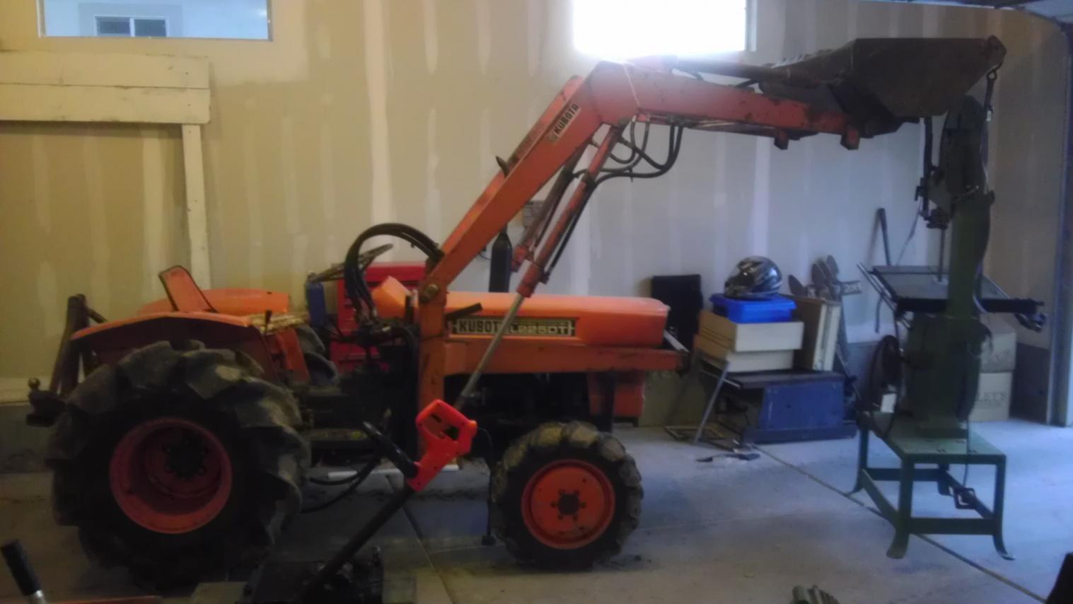

i have an original L225DT my dad bought new in 1976. The little grill around the headlights is chrome on mine and the lower, main grill is Kubota orange. That bucket on yours is aftermarket and it looks like the kind you find on refurb'd Zennoh L2000's. I'd be willing to bet the clock as been reset on the hour meter when it was "refreshed". Also, the L225DT came with smaller diameter rear rims with big fat tires. The attached pic if my Kubota. Notice the rear tire and 1200 loader that was OEM.

yes that is definitely a gray market (Zennoh) tractor. Mine has a 2spd PTO. The gray market tractors had 3 and sometimes 4 speeds that weren't offered by the factory in the US. Still a great tractor and as long as it was cared for you'll love. Other than my dad exploding the front diff overworking it, we've had zero issues with ours.

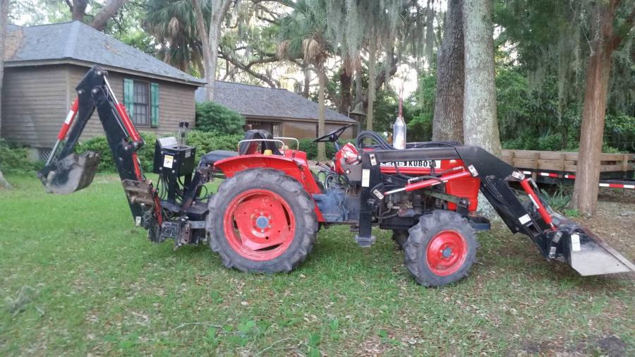

Pick-up it up this weekend.
I sent Dad and his buddy to get it after finding it on CL 600mi from me.
Definitely a gray market (Zennoh) with a 4 spd PTO, cartage type oil filter, decompression knob... and recent L225 decals
Runs well. no smoke, starts easily.
Doing fluids/filter now.
Thanks!
