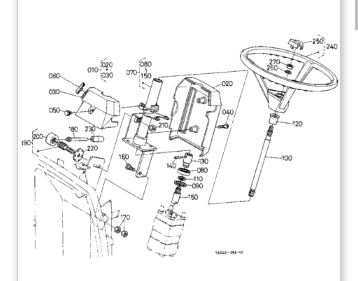

Does anyone have a diagram that shows where the shuttle shifter's safety switch is located for a 1999 L3600 GST?
Remove bolt 050 and I think you'll find your switch under cover 030. You do know there's also a PTO safety switch and apparently another lock out?

Thanks- yes I know there is more than one. I have to jiggle / hold down the shuttle shifter for the safety switch to start the engine. So. I am pretty sure thats the one.

My tractor has almost identical switch and location, I just had to adjust it in the last 2 weeks. My switch was held in by a Phillips head screw. The location of the switch was fixed but was able to re-bend the switches lever so it started making contact with the shifter again.
