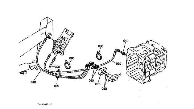

I will only have it front mounted. If I run a kubota snowblower, what hydraulic equipment will I need? I don't have a spot for the snowblowers hydraulic hoses to hook up and I don't have anything to control it.

You'll need to add a spool valve to control it, fairly easy to do. ;)
