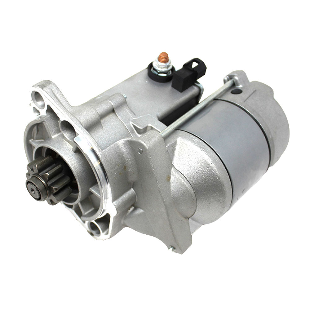

It doesn't have one!
Gear reduction starters don't use a solenoid like older starters.
Just replace the starter.
And if you want to roll the dice (cheaper price)
