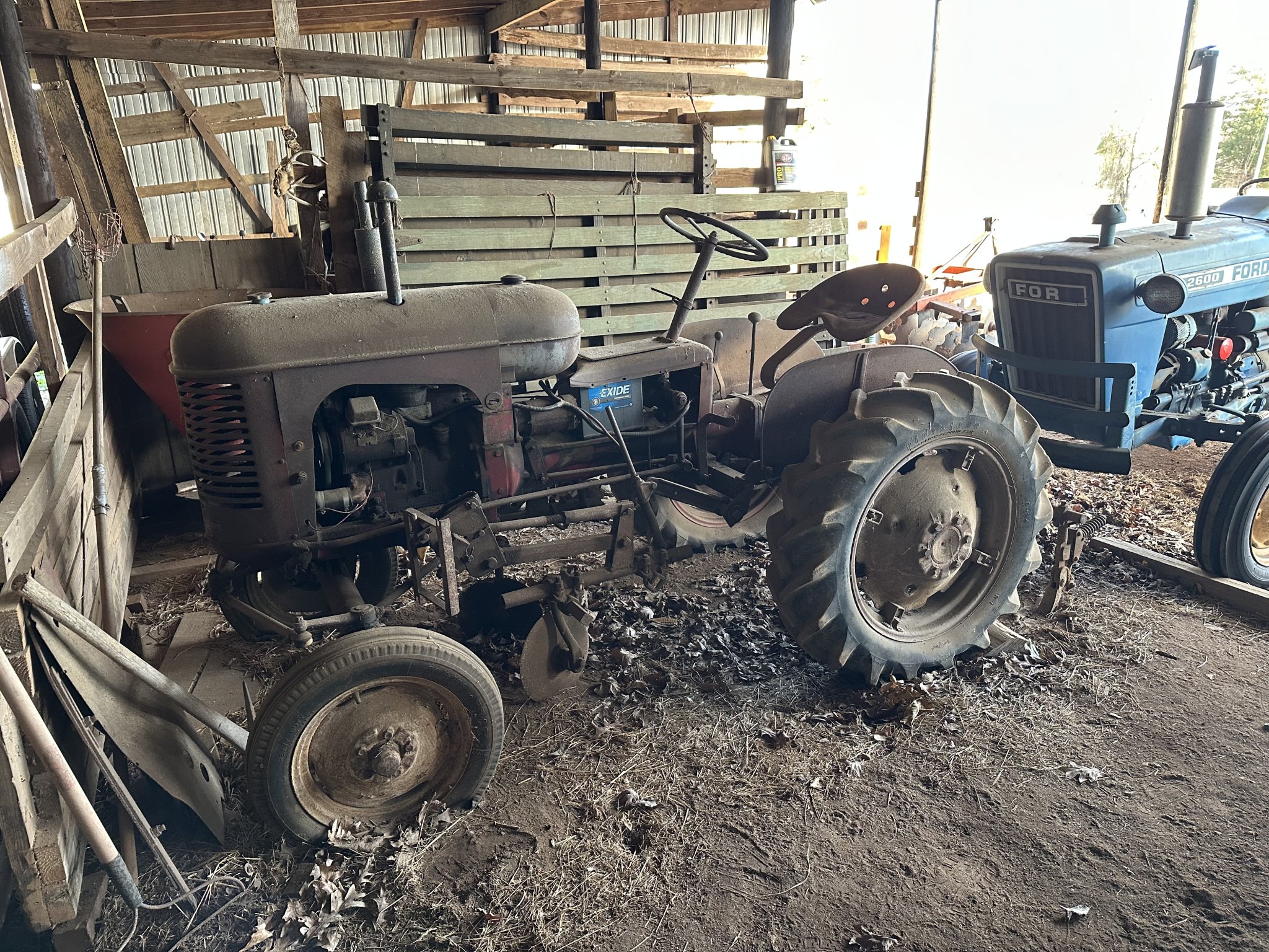

From the looks of the tires (if they're still the originals) the tractor certainly hasn't seen much abuse. That will be a cute little parade tractor all dolled up. Or even used and kept in its original work clothes as is!! If mice haven't found a way into it, it probably won't take too much effort to get it running again. Most people I know would be proud to have that in their tractor lineup!!!

Well I have decided to dig in a bit and at least get it running. I may decide to go as far as keeping it for a little garden tractor if it's not too involved. Drug it out a bit and started a little dismantling. I will drag it over to the house in the next week or so so I have access to water, compressed air and an array of tools to see where it takes me.

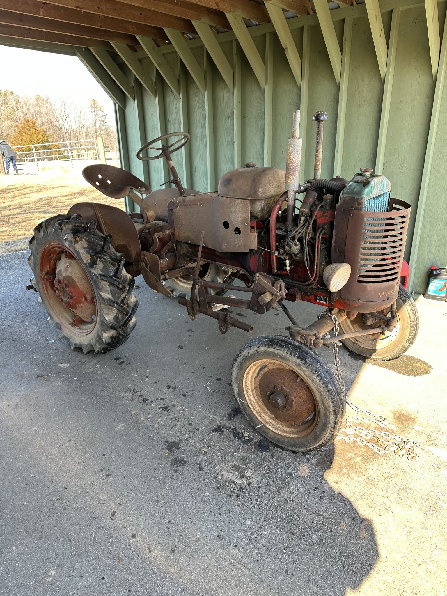

Update, I lubed it and was able to easily turn over the engine with the hand crank. I have cleaned the tank, fuel bowl and carburetor and am now waiting for new gaskets for the carburetor as once I cleaned up that I have some bad fuel leaks. I also put a new battery in and it is turning over fine just need to address a no spark which I believe is due to the points as they are in rough shape so I will order a set as well. Hopefully after these last two items and can get it started and moving under its own power. WooHooo

It's alive!!! Man, once I reworked the carb, put new points and a distributor the darn thing fired right up. Purrs like a little kitten. I took it for a little spin and everything works as it should. I could not be happier. I have about $160 in parts for the battery, distributor cap and points. Money well spent to see if it would run again. Not bad for a 74 year old tractor. :)
