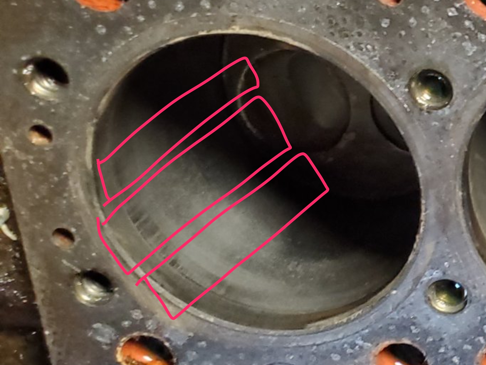

Ok. I took the top block off. There are a lot of black soot inside the chamber. Here are some pictures. Would you please help me to understand what the next steps are. Thanks.

Is there any obvious issue that you can pick up from the pictures? The cylinders seem to be firm, not much give. One of the cylinder tops has some scorching.

As one of our most respected techs, you need to take lugbolts advice. Pictures aren't perfectly clear but I can see vertical scratches on the cylinder walls which means dirt got in where it shouldn't have and the pistons and rings did the scratching. So from this point... 1, turn the engine over by hand to make sure all pistons come up to the top of the deck equally to check for bent rods. 2, disassemble and have a pro measure the cylinders for taper and wear. 3, if you're lucky you may get away with honing and a re-ring. From the sound of the way the PO maintained it you could be in for a major overhaul.

(The visual inspection of the cylinders do not reveal anything out of the ordinary, IMO. Checking for full cylinder travel is a good idea (to check for bent rods) but that would also be only cursory, not definitive without removing the lower sump and pulling them out.)

First thing, you should check the accuracy of your compression test gauge. Especially after looking at the pictures, I would be very surprised if you only had 100 PSI compression plus the fact that you get 100PSI on all 3 cylinders throws up a huge red flag.

I took the top bock off, and found that there is lot of soot/dirt buildup on the rings. Hope this is the reason that I have low compression.
Like these vertical scratches?!?!

yes I see evidence of engine dusting. It is obvious.
