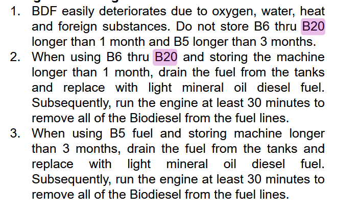

so our retired farmers club (our morning meet up group for coffee and pie at local diner) consists of our group of over the hill farmers. We talk / argue / fight over all kinds of things prior to starting our days work. non of us overly educated / some days our table is full and counting years of experience we often get near 1,000 combined years of farming experience across the group. It amazes us.
today the topic was delayed / missed maintenance on our equipment.
what kind of maintenance (preventative/seasonal/other) is most often missed by your hired help / family members?
seems like we are seeing a lot of fuel issues these days as bio-diesel is creeping onto more yard sites. given we get petroleum only diesel delivered to our yards I never thought this topic would kick up such a hornets nest of hate. I just didn't know as I rarely ever get exposed to bio diesel.
So Kubota says no troubles using up to B20 but:
- replace fuel filter every 200 hrs
- replace all fuel lines every 2 years
- If using up to B5 drain fuel tanks and replace with fresh every 3 months, and if B5 to B20 is used then the tractors tanks should be drained every month! so an extreme keep your fuel fresh approach is needed. Must be hard for guys that don't run a tank of fuel a month or so.
our local dealer e-mailed me the following clip and I had no idea. no wonders so much fuel related problems are surprising guys.
I got schooled.
