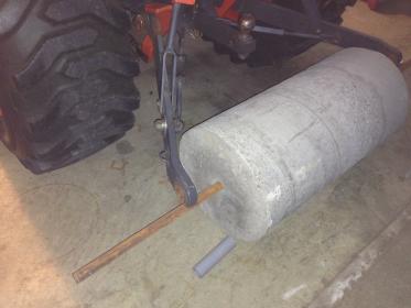

In the mean time, I've finally (I hope) attached some pics for ya'll to browse and give me some info/suggestions on, if you feel the need. I know it would benefit from a thorough cleaning, so that's on the list as well.
