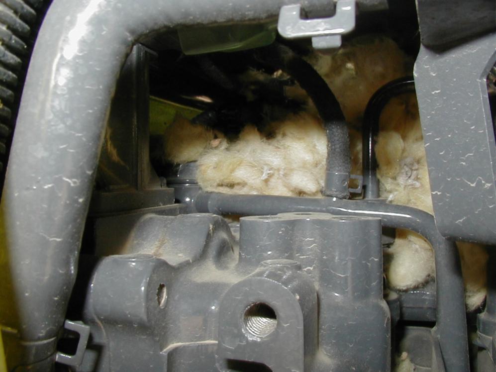

Stopped by the dealer and talked to a tech who said I can get a fitting and hoses and gauges to do the check. Went to the hydraulic place and found out the threads on the relief valves are British 1/2-14. They made me a 0-5000 PSI test line for $56.00. Get home do the test according to the manual and the highest psi I reached was @ 50. So I'm with Wolfman about the special fitting they use to check this. If there is no special fitting and the test I did was correct the next step the manual says is to inspect the Charge Pressure Relief Valve.
