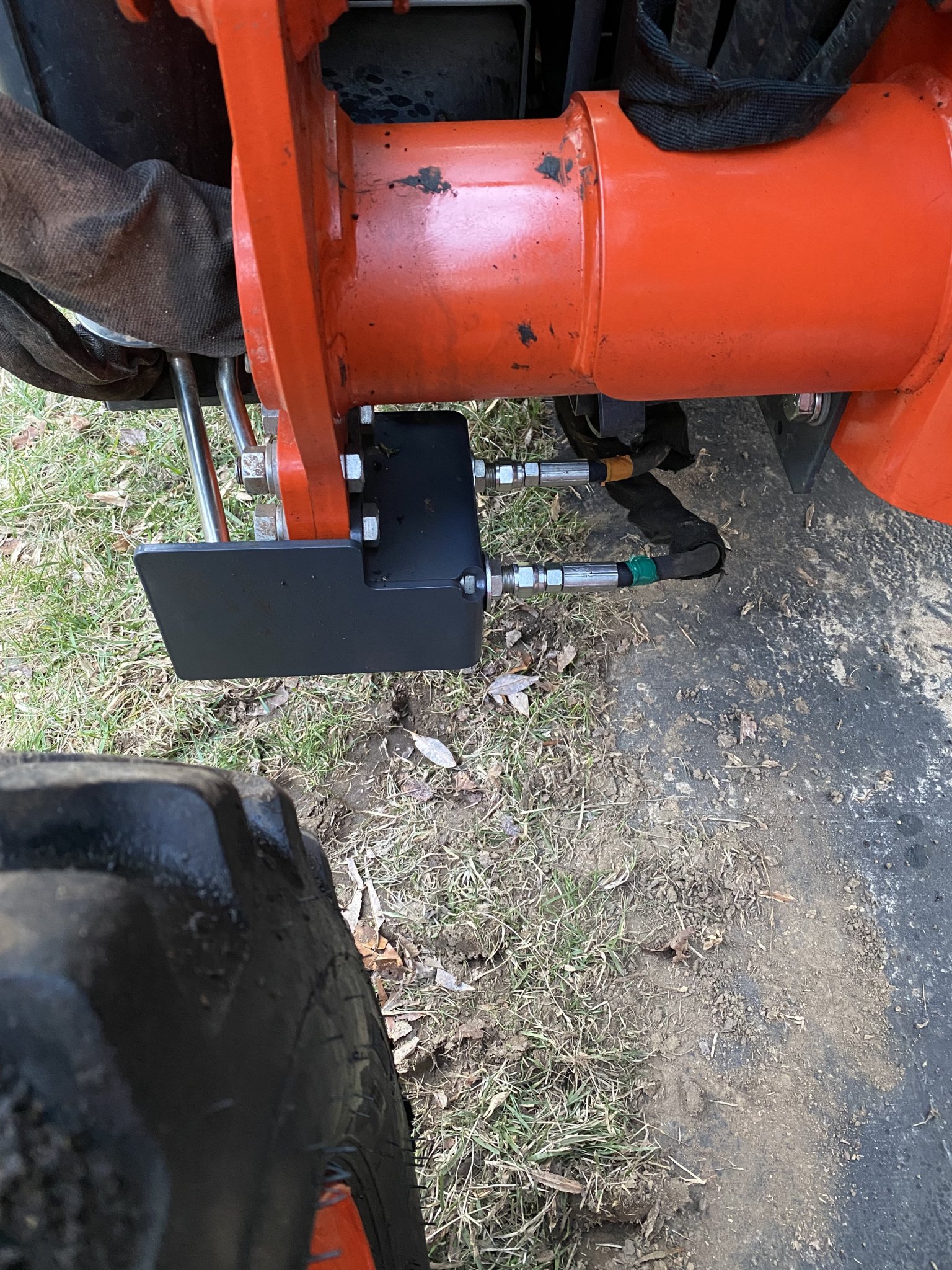

I have a Factory Installed 3rd function remote on my Grand L. The hydraulic lines come off hard lines under the cab near the right step. The lines are in a vulnerable position and constantly being hit by branches and debris. Does anyone have a suggestion to protect or reroute the hydraulic lines to the rear of the tractor?

You should probably contact: Specialtyrepairsandcustommods.com, in Bay Roberts, NL, Canada.
1-709-786-3348.
This husband/wife team makes and ships, all sorts of very high quality custom upgrades, specifically for Kubota tractors.
They are first class folks!

Looks like it would be easy to bolt on ( so you don’t have to weld) some angle iron to the bolted on brackets that are there now. And sandwich piece if expanded metal or … to let the debris come out.
If you have the ability to weld up a piece, you can make a cover to bolt on.

1st ,I'd add 90* adapters between hoses and 'the block'. If left asi is ,I can see the hoses failing between the wraps of tape and the sheathing. Might take a year or two , depending on actual use,but they'll fail for sure.
2nd, yes, say some 1/8" sheeting,bent and bolted as required.

It is difficult to see from your photo where the lines are running to but is it possible to replace the hard lines with flexible lines and do a complete reroute?

Have you seen any aftermarket shields? If so please point me in that direction. I’m anxious to install them. These hydraulic lines are the heartbeat of the machine.

I’m sorry, I just saw the previous reply. They point toward the guards.
thank you.

Not cheap,...... but really good stuff!
Thank you. I am definitely going to purchase both. I’m surprised I got away without them this long. I’m waiting on replacement hoses probably $140 plus a week without the machine.

You will like dealing with that couple (Paul & Kathy Short) in Bay Roberts, NL.
