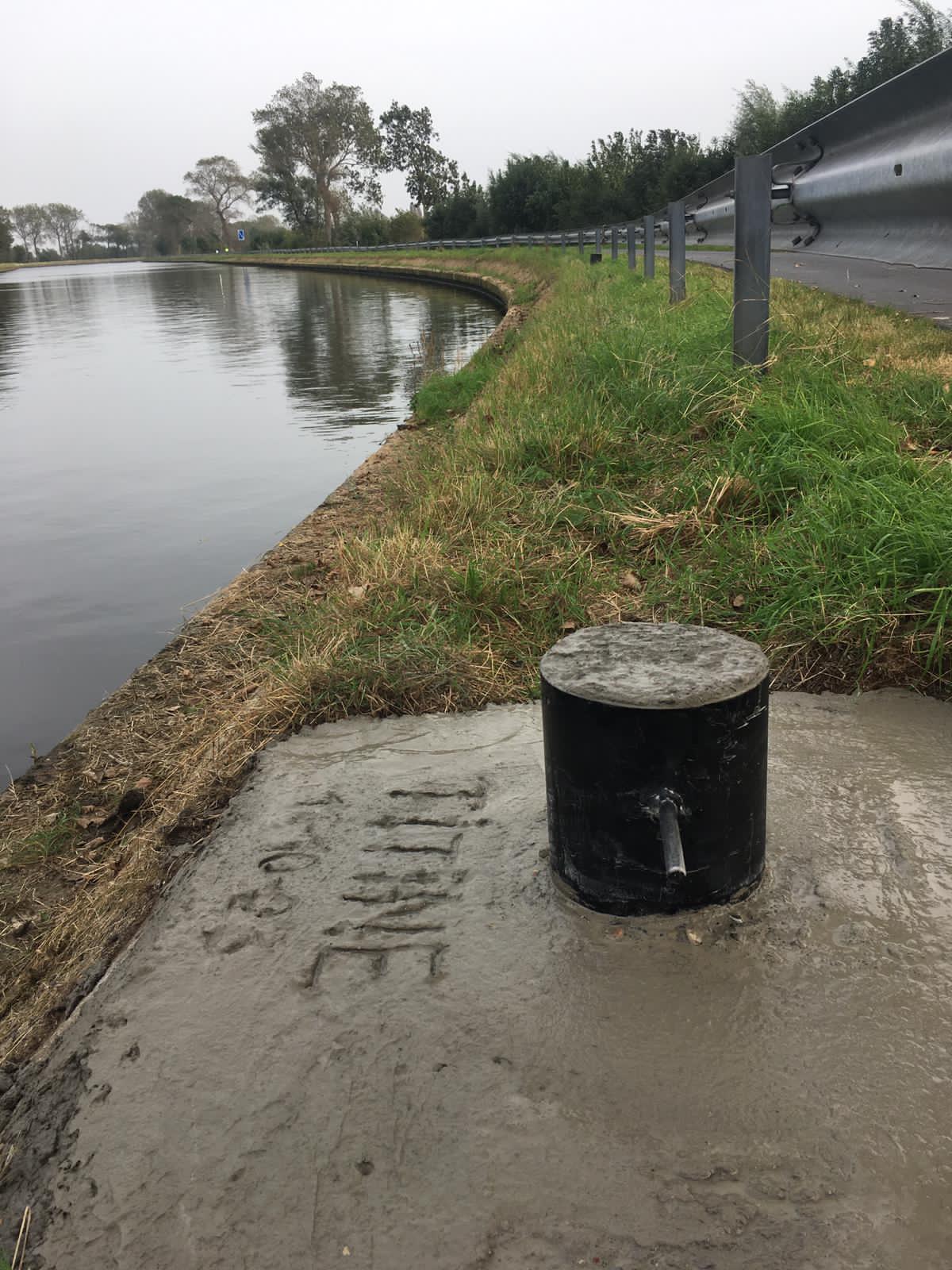

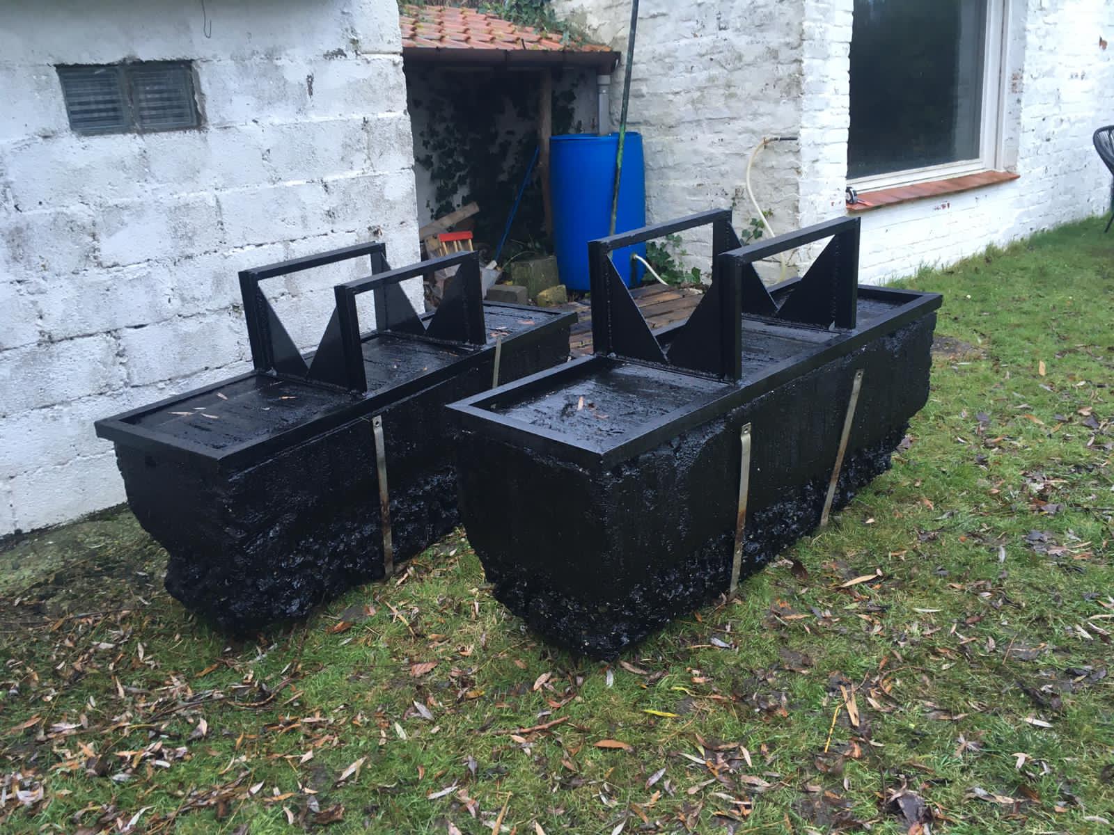

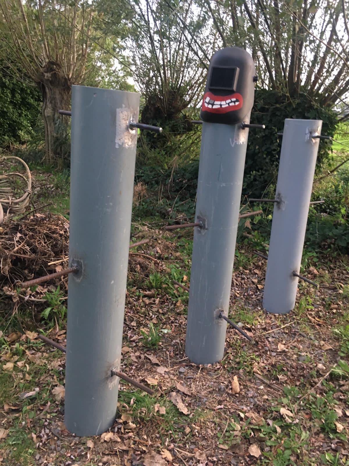

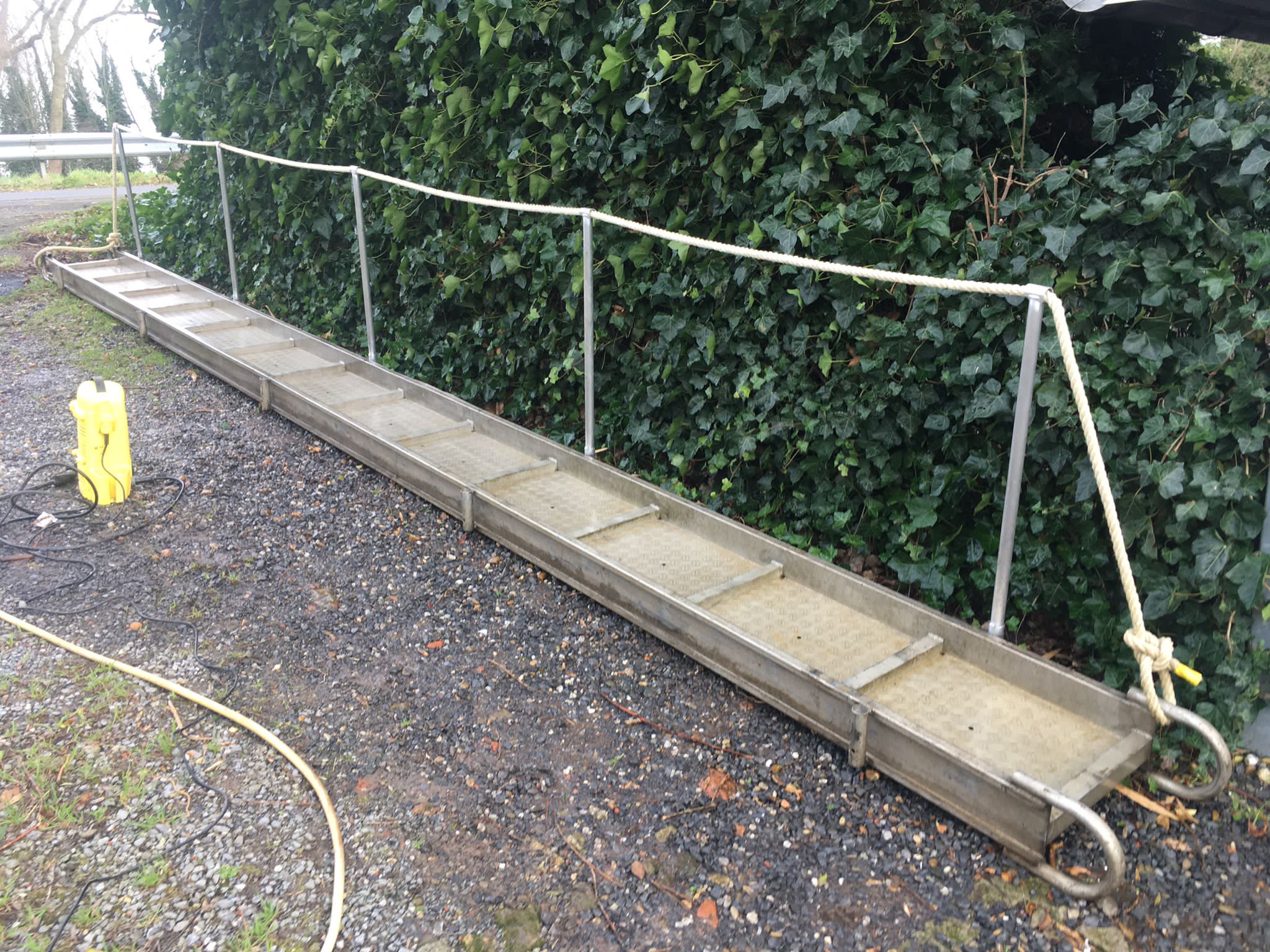

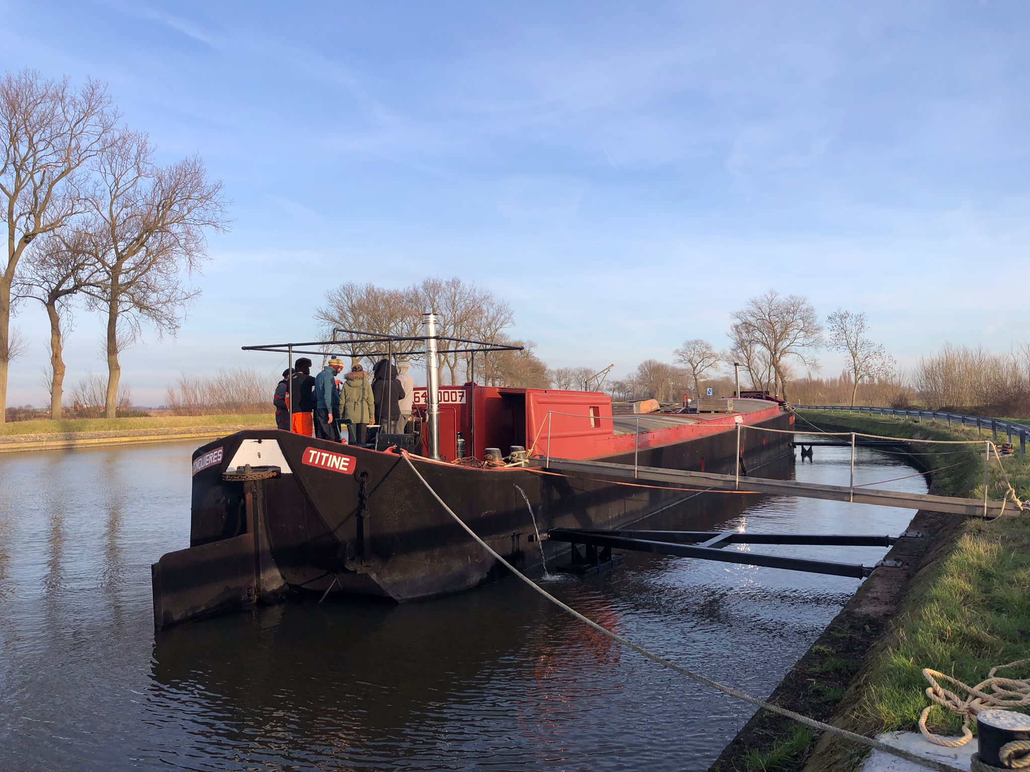

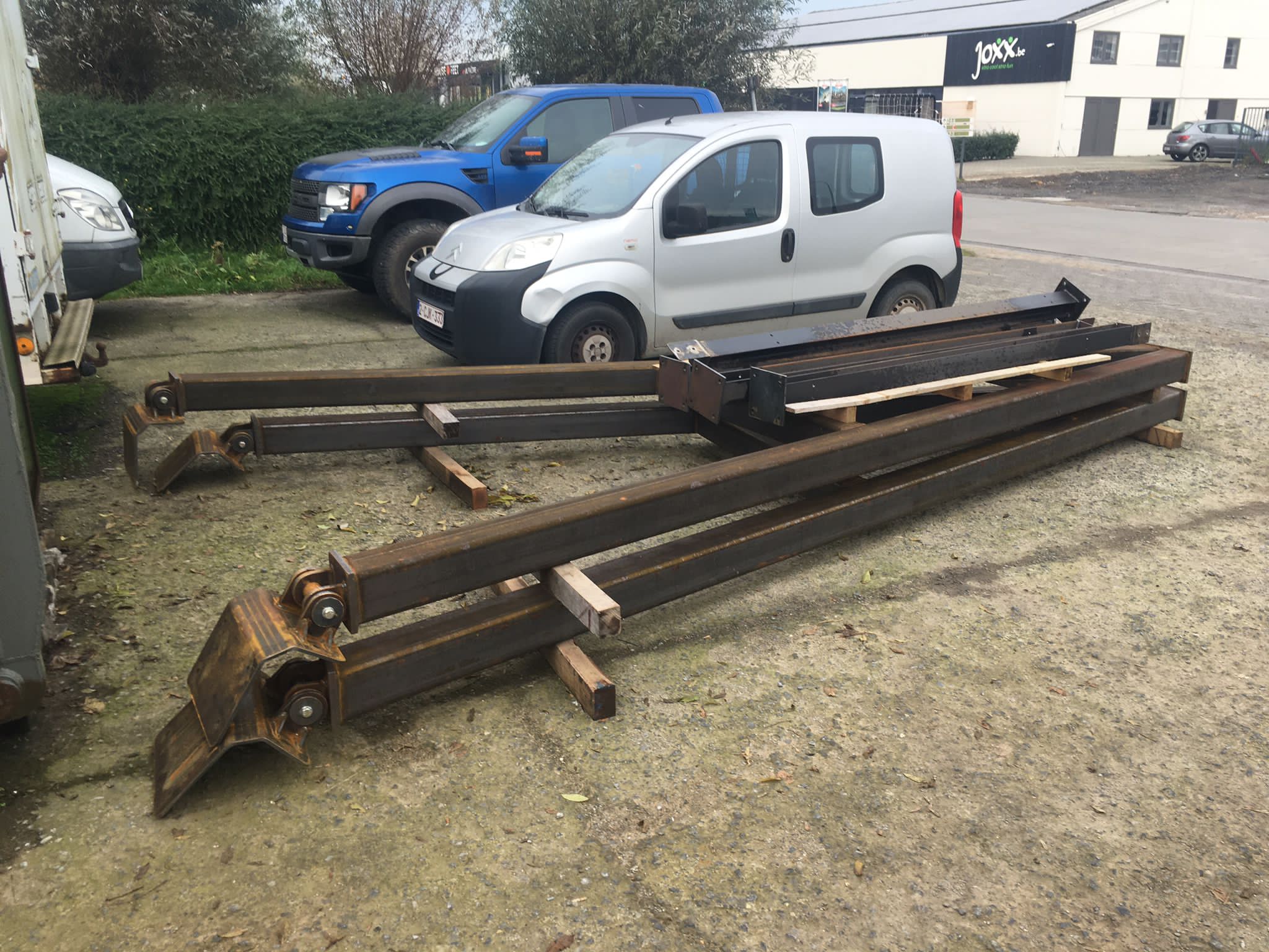

My brother lives on a 100-year old, 130-foot long, 150-ton (metric, empty) barge. After years of moving from one place to another, he finally managed to obtain a permanent mooring (i.e. the mooring place is permanent, not his stay there).
However, that mooring came with nothing at all, so we had to:
1) fabricate mooring bitts, install them in 5'-deep holes filled with concrete
2) fabricate outriggers to keep the ship away from the embankment, where the water is too shallow. Each one weighs half a metric ton without the (carefully calculated) floats made with foam recovered from a scrapped dock
3) source (from a ship breaker 150 miles away) and adapt a 27-foot gangway.
And this is the end result:

That's really neat! Not knowing anything about the setup, how are the utilities handled? Thinking about power, water, heating, wastewater.
Power: the mooring is getting its own power meter: just plug in and you're good to go. Alternatively, the ship is also equipped with a diesel generator (no Kubota though...) and storage batteries. Solar panels are "under consideration" but would seriously harm the ship's looks.
Water: deck and hatches run-off is collected and stored in a 1,500-gallon tank, then filtered.
Heating: pellet-fired central heating with the furnace (which also produces hot water) in the engine room and a wood burner in the lounge.
Wastewater: the ship has a dry toilet (no flushing - waste is stored in a ventilated bag and dries odorlessly). All other wastewater is 'grey' and just goes overboard. Environmentally-responsible detergents and soaps are used.
Leaks: this thing was built to be run aground for loading/unloading (300 tons) and did so for more than 50 years... It's built like a tank - no, actually better: how many 100-year old tanks are still in daily use?
