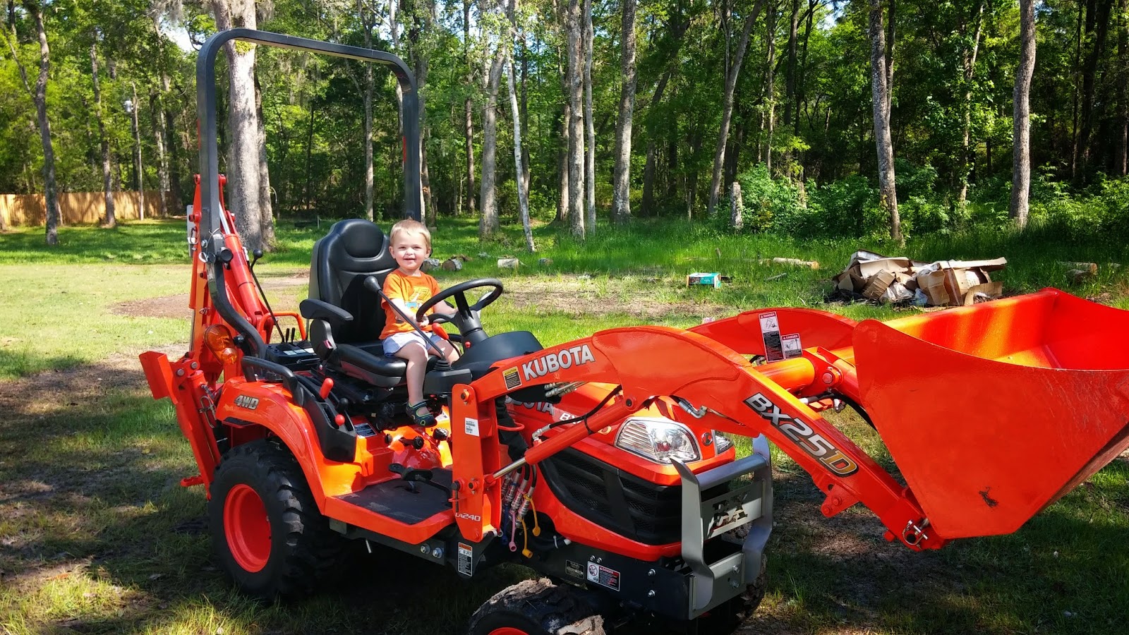

The next day i drove out a little west to a dealer in Macclenny and Bought a BX25d with 0hrs on it, R4 tires, 12'' bucket, thumb, 3pt hitch for under $17k out the door.
They were so nice, gave my kids frisbees, hats, and HD straps for my trailer.
Very impressed.
I've put a few hours on it now, its extremely helpful and fun lol.
If i had one con; Its a little light. Digging with the backhoe takes some technique not to lift the tractor off the ground instead of digging.
I may ask this in another forum, but the manual essentially says 'take it easy for the first 50 hours'. no specific numbers like, "don't exceed this rpm" etc... any tips or good threads to read?
My boy loves it to!

Welcome to ORANGE!
I think the "take it easy part" is a natural man thing, you will take it easy, due to the fact that it is expensive machine and you are not sure what it can and cannot do!
It will do damn near anything you cam think of, it may do it slower than something bigger but like eating an elephant, one bite at a time!
On the backhoe, first get "better" at digging, there ways to dig that will not lift the tires off the ground and depending on your soil you may need to scrape rather than dig! I would get your rear tires loaded, this will help a lot all the way around.
Maybe more importantly, teach that young one "how" to do things as he gets older.....let him make the bucket go up and down - teach him how the hoe moves, set up soda botttles and see if he can knock them down, by age ten he will be BETTER than you! And he will be lightyears ahead of anyone else using a piece of equipment!
If you did not get the MMM, go and buy one of the undercarriage shields for the BX, only real problem with this series is the underside Hydro pump fan can get beat up if a stick finds it's way in there.
Also get a toothbar if you plan on doing a lot of digging and scraping with the loader side!
best of fun !
14,620
3,457
OUTSTANDING !!!! Yep like he said just take is slow till you find out what this little beast will do and its a bunch,, As far as break in,, like a man told me,,, run it like you stole it,, And that munchkin is gona be your best buddy :D
