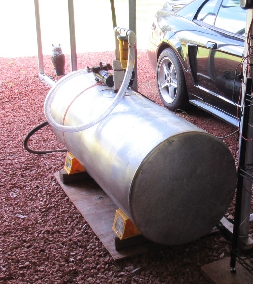

I have a 100 gallon aluminum tank off a Freightliner truck. I can't remember what I paid for it at a salvage yard. I use a 12V pump, hose, and nozzle off eBay that was about $65 and I upgraded the nozzle to an auto shut off model for another $30 ish. I have a solar panel on the roof connected to a charge controller and a deep cycle battery to power it. I also have some LED lights and a Wyze cam connected to it.

What did you use on the tank for the fittings for the sight gauge. I have a meter on mine and a spreadsheet that I keep track of how much I put in and take out. I also use the spreadsheet to tell me how much weight is in the tank so I can figure how much fuel I can add when I take it to the station to "fill" it. The L3901DT won't pick it up if I fill it.

Super set up, just watch the PVC parts as the diesel on the inside and sun on the outside will make them brittle over time.

It's in the middle of a barn with 3 sides enclosed so no direct sunlight on the PVC. I think worse case if it gets brittle and breaks it will just fall on the ground letting me know I need to replace it.

If you ever want to replace it, they do make schedule 80 threaded PVC. Usually you can find it in the irrigation section of the hardware store.

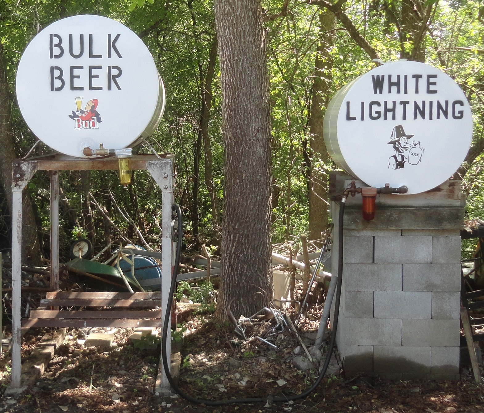

When the price of diesel was extremely low a few years ago, I added a second bulk tank for off road diesel.
500 gallons total capacity. At that time, they were both filled to the brim with $1.39 per gallon....tax and delivery included.
My neighbor and I finally drew the last 5 gallons out of the pair this winter. I guess all good things to come to an end. :cry: Now we have to decide when we want to fill and how much again. It was sure nice while it lasted, though!!
