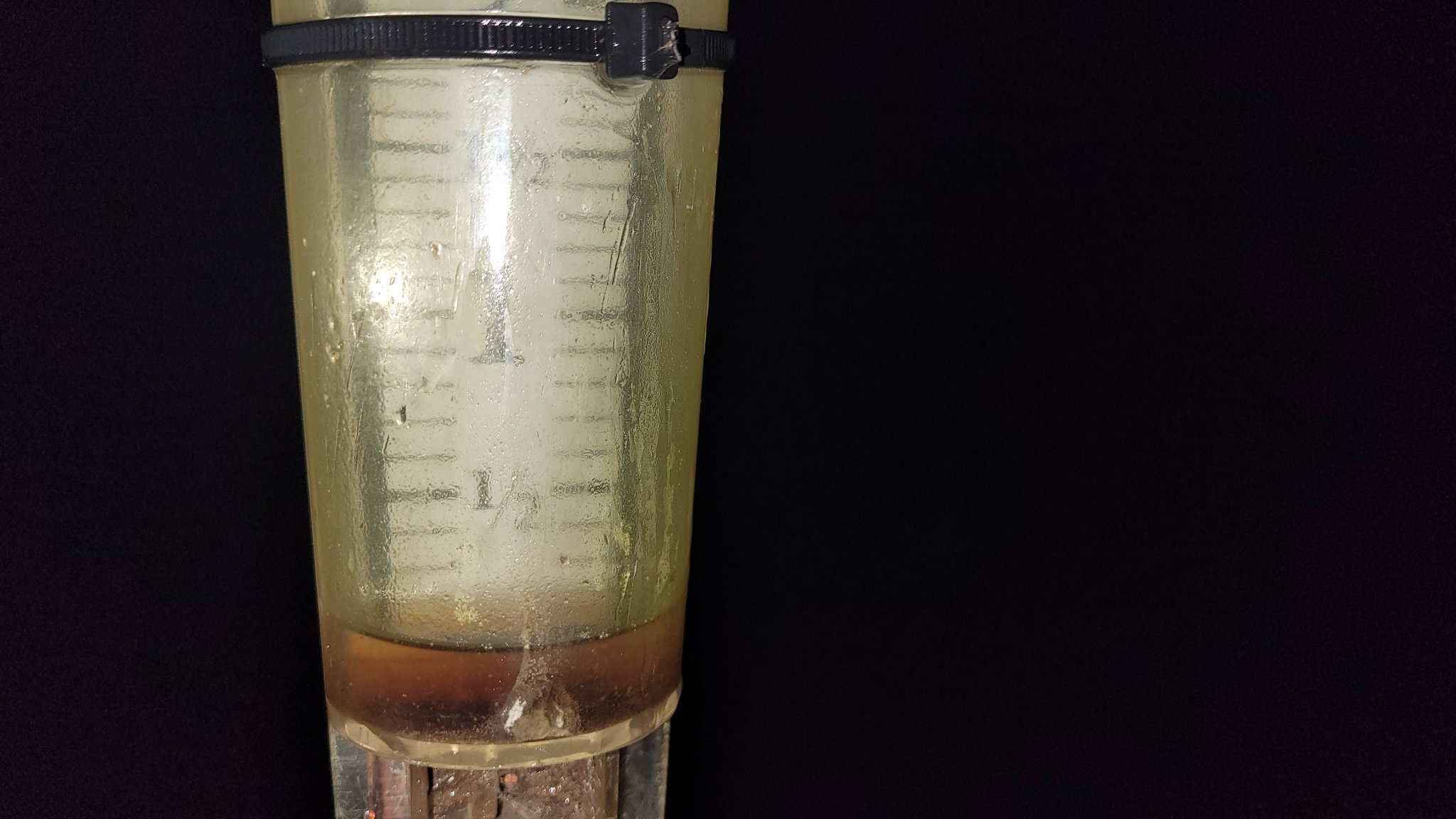

Ok we have had a light rain for a bit over an hour!!! Looks like 2/10ths so far, and what used to be dust, lol.
I'm really happy cause I was suppose to put hay out today, but too busy with other projects. I'm really hoping this rain perks up the grass.

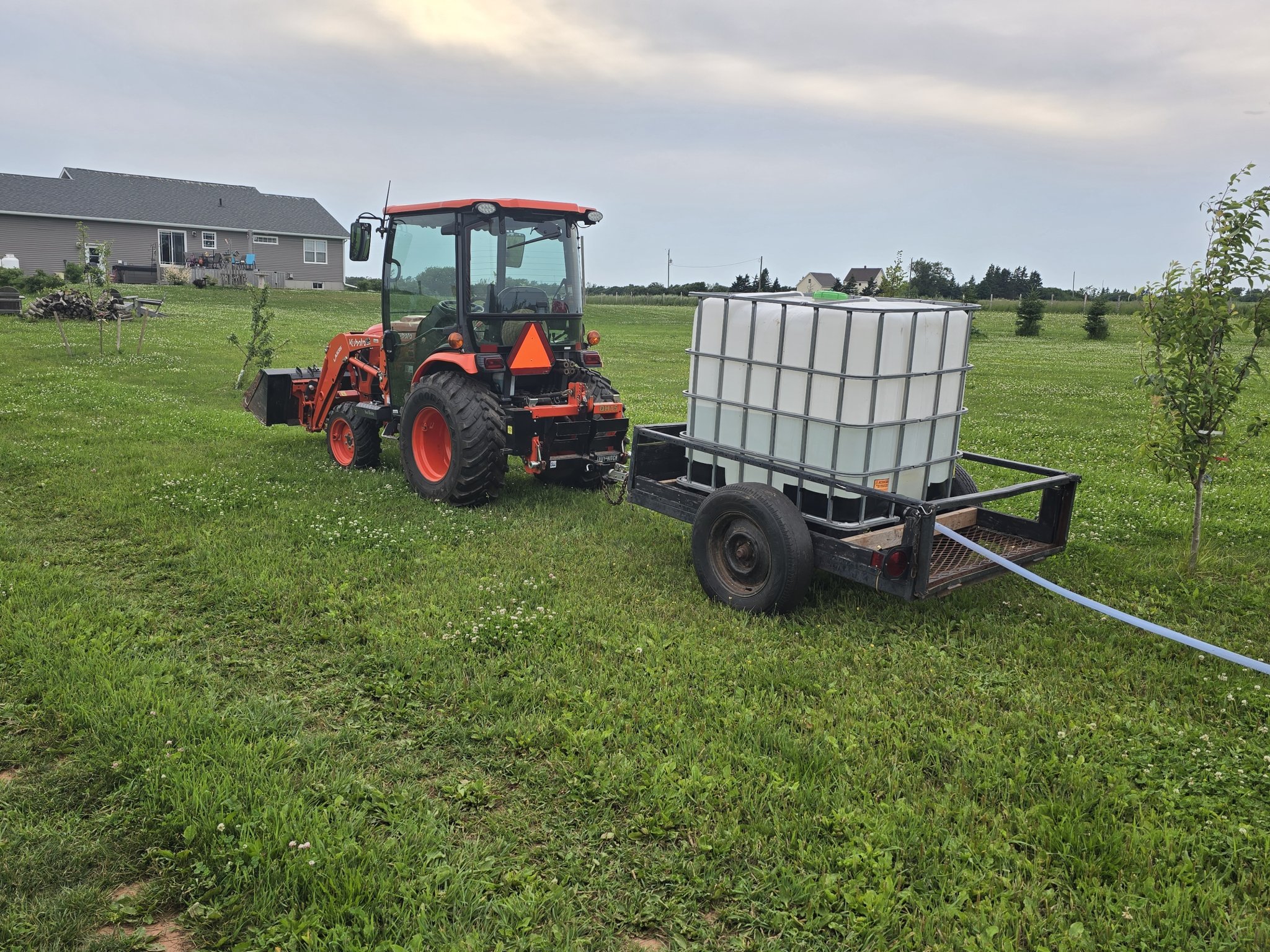

Shocker! Watering trees. We're supposed to get some rain from whatever is left of Beryl Wed/Thursday but I'm not holding my breath.

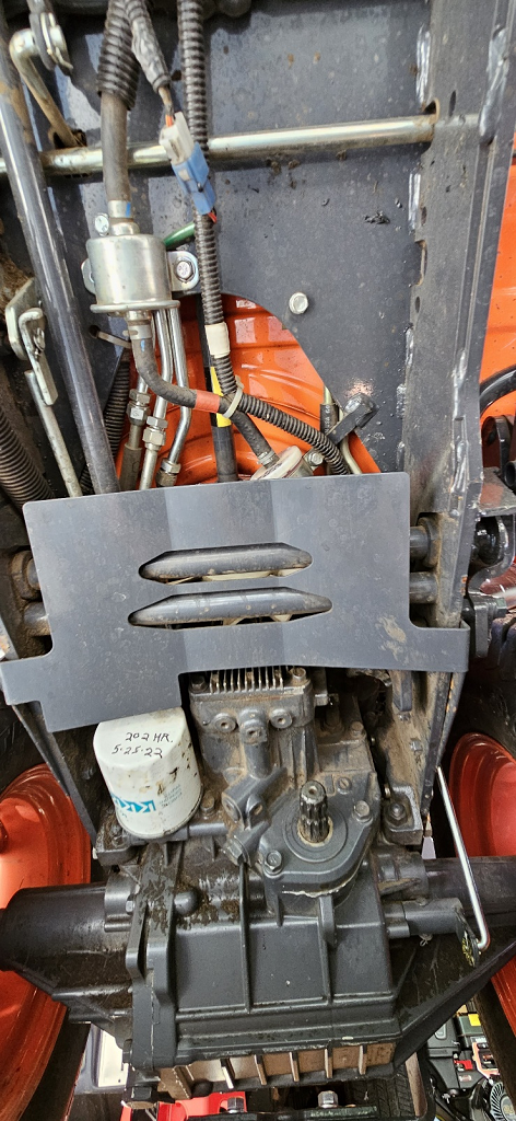

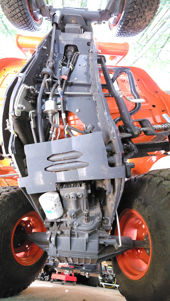

Here's my BX2370 underside before:

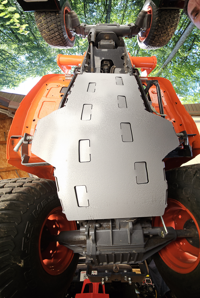

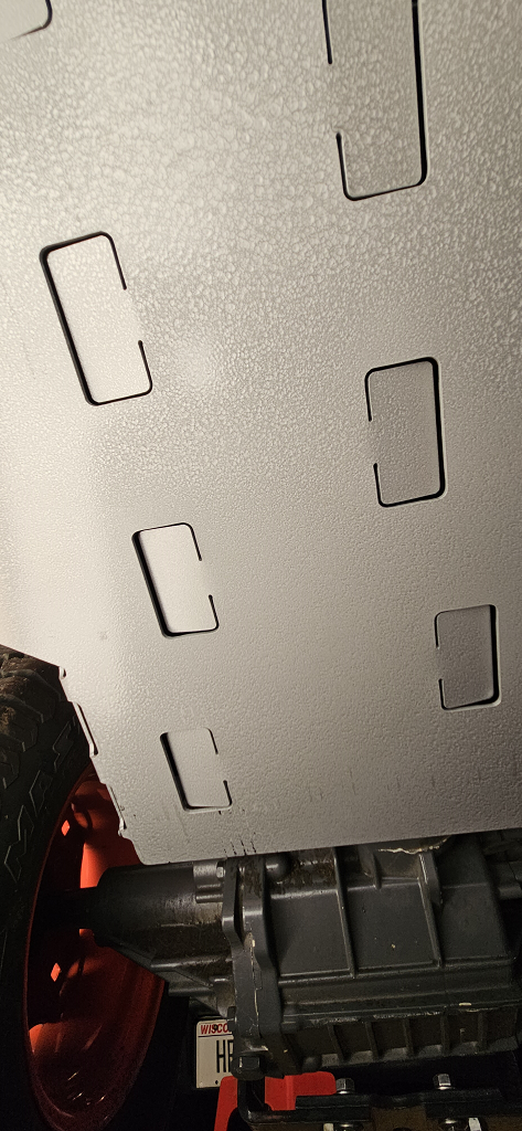

and after installing the BXtreme underbody armor:

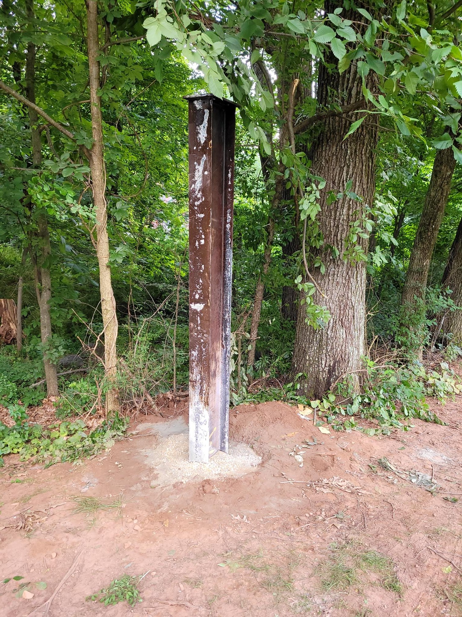

Progress on the antenna tower today :)
Drilled the hole for the 1st I Beam anchor point, set the beam with the tractor and then filled the hole with quick setting concrete. That 18" auger made quite a bigger hole than 18"! I didn't get to use my extension here as I hit a serious rock at 4'. Command decision was made - 4' was enough. I am going to plant large rock against the beam to supplement the ground support.
The white marks on the i beam are from the Ospho. Will wipe off that powder residue before I paint the beams.
BTW holding that 400lb bean out like that was a tension convention time. I should have switched back to the ballast box before moving the beam into position.

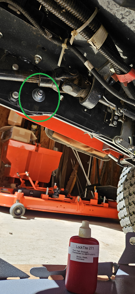

I was a bit baffled why the mower deck lift wouldn't lock at "Top" with the BXtreme armor installed. The instruction sheet mentions a gold adjustment bolt behind the left rear tire (the right side does not have a matching bolt). I marked the side facing me with a black marker to keep track of the starting position and one turn was all it needed. After cycling the up/down a few times it loosened up and the bolt could be set one flat spot "tighter" (5/6 of a turn from starting). Really easy.
I also used Red thread lock on the bolts so they don't back out on me (a common problem in my world), Blue (medium strength) is probably a better option, though I don't plan on taking off the mounting bushings.

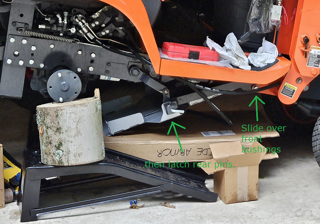

The mower deck should protect underneath so I’ll wait. Didn’t think it was possible to have that plate installed along with the mower deck. May leave it on next spring when the mower gets installed. Was it fairly easy to install that plate with the tires on the ground or should I lift the tractor?
With the BXtreme armor, only the armor or mower (one of the two) can be mounted at a time because the armor plate uses the mid-mount mower lift arms to hold the rear of the plate in place. (The front section rests on bushings you install into existing holes in the tractor frame). Installation is quite easy, put a washer, bushing, and second washer on a bolt, put the bolt through a hole in the frame, then add a washer and nut and tighten. Repeat for the other side, then slide the armor over the bushings and lock it into the lift arms after you lower them, then raise the lift arms and set the mower height dial to TOP.
(washers and nuts that hold the bushings)
(slide over front bushings, then latch rear pins)
(than raise mid-mount accessory arms to raise the plate like you'd raise the mower, then use the dial to lock the plate in the fully up position TOP)
I had to adjust the bolt by the left rear tire to get the mower dial to turn to TOP with the armor on because the armor wouldn't allow the arms to raise quite as much as the mower deck allowed.
According to what I read, with Bro-Tek a similar area is divided into two sections and the rear section can stay in place, the front section needs to be removed when using the mower.

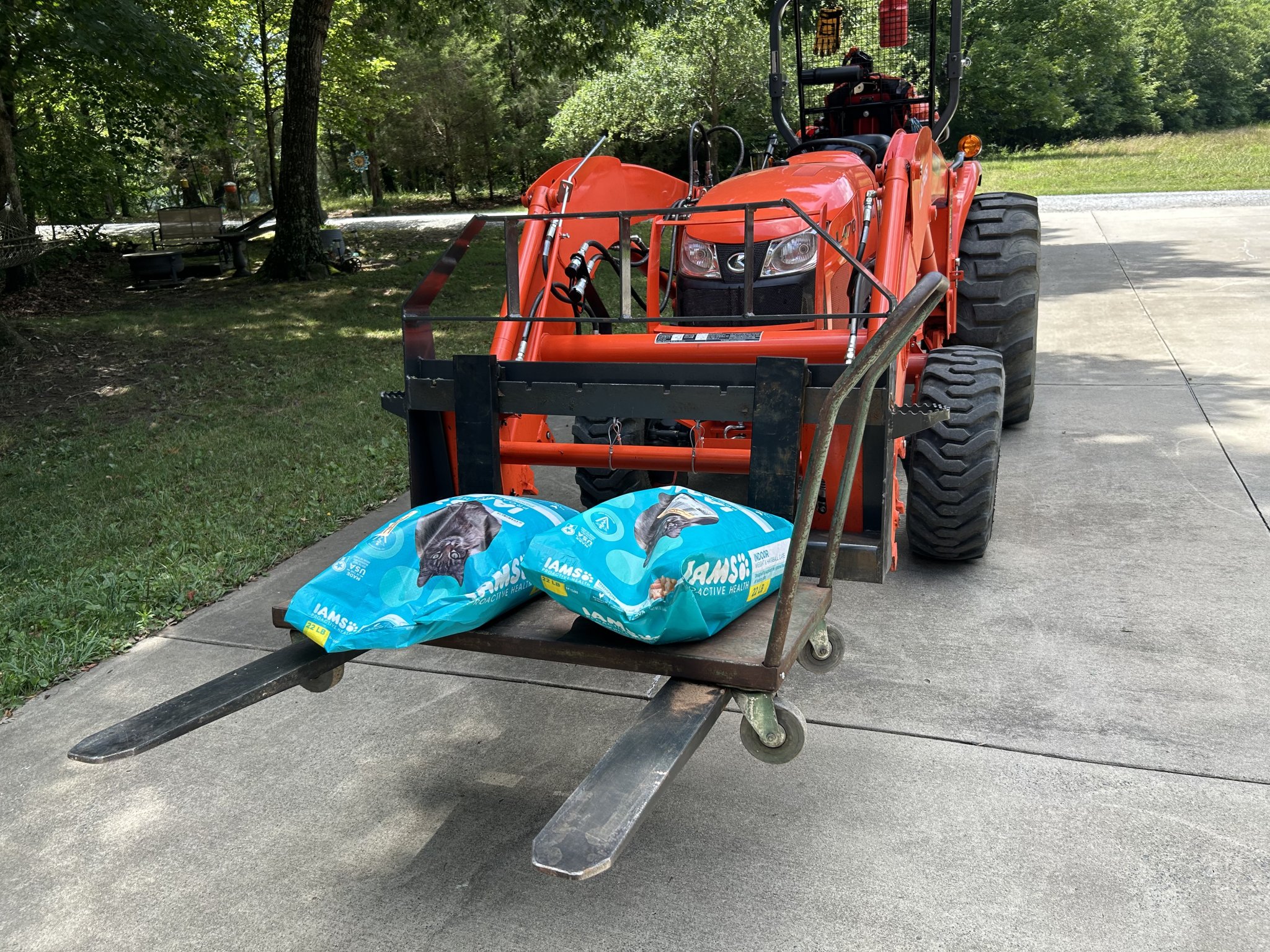

Started the day with the forks on and the tractor just happened to be the most convenient vehicle available at the time, so used it to move a whopping 44lb of cat food to the chest freezer at the storage house. The overkill was almost comical, but it worked.

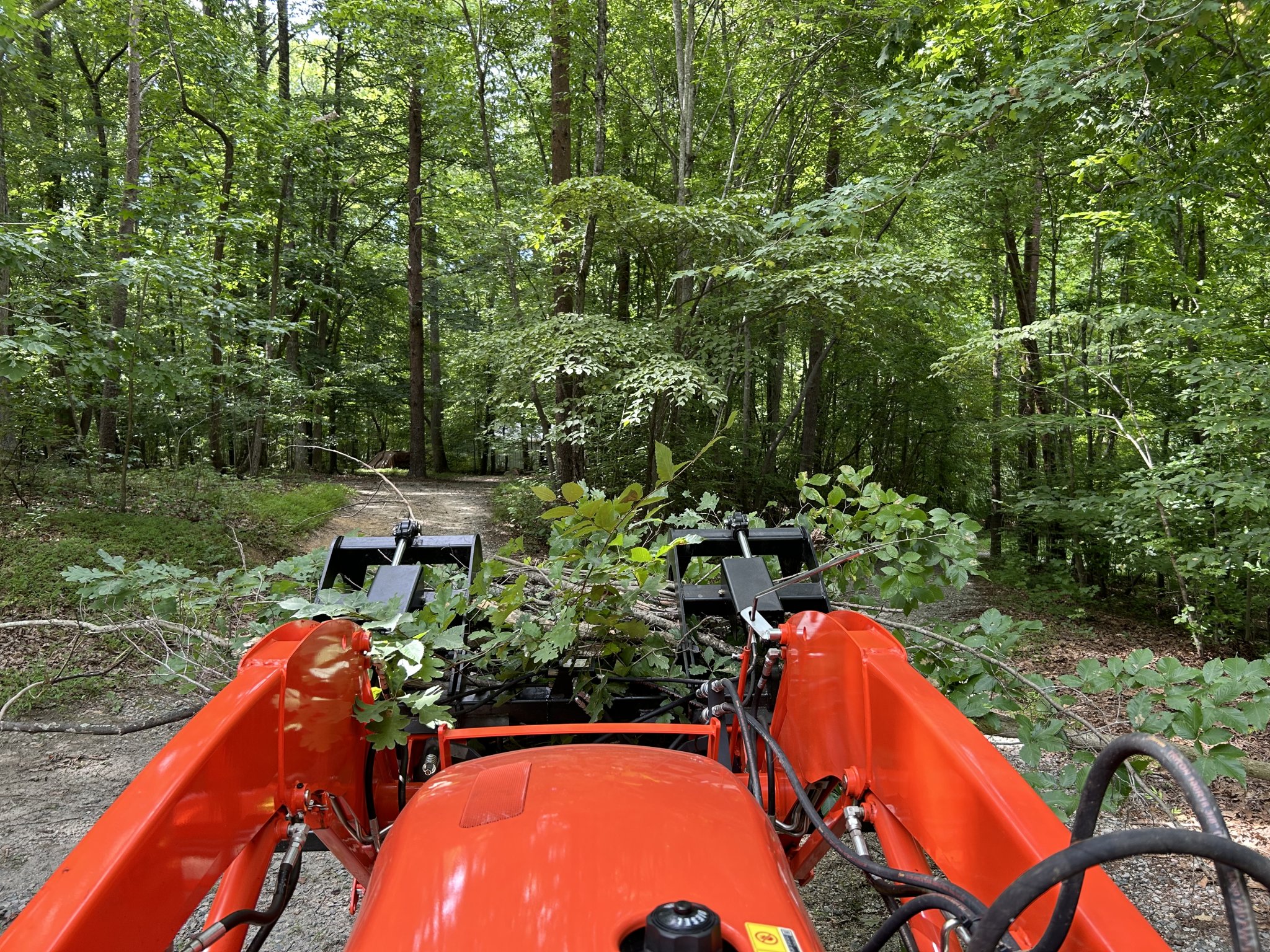

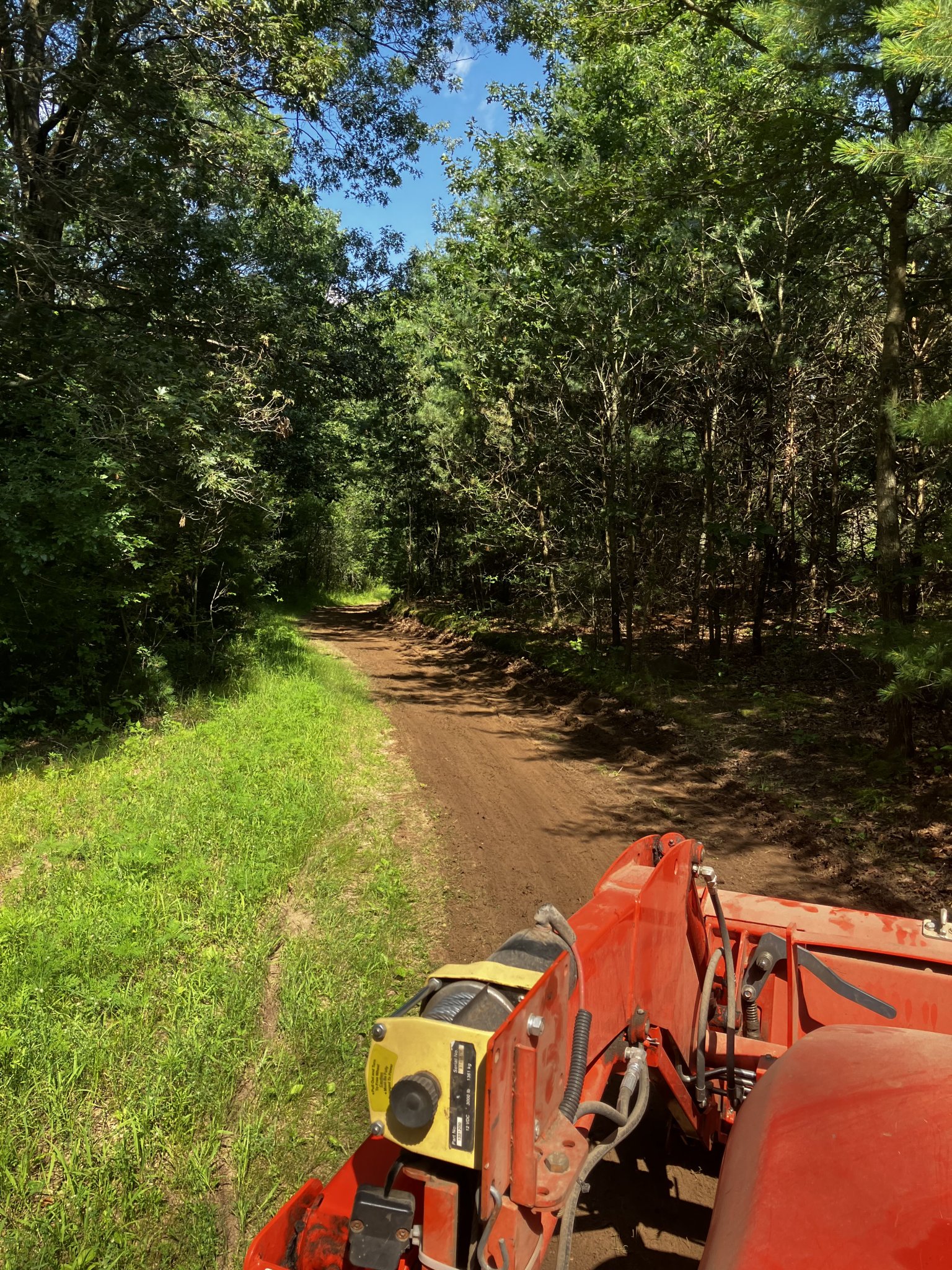

After that, trimmed up the dead branches along the driveway and a few live ones that were encroaching a bit much. 3 grapple loads later, it was quite a bit tidier. (The pic is part of the trail to the brush pile by the shed, not the driveway.)

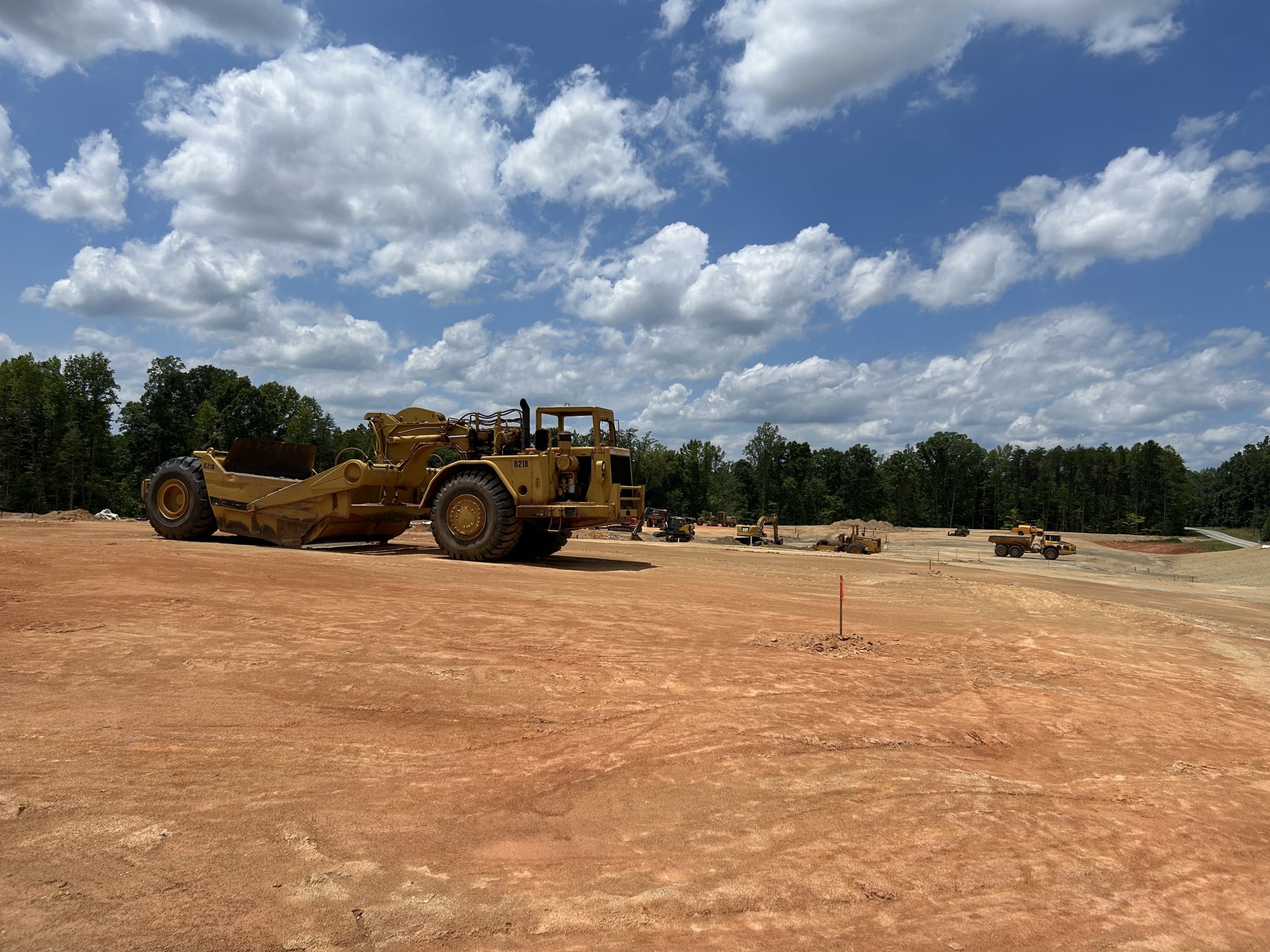

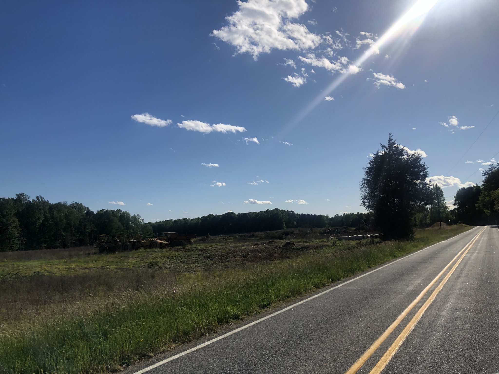

Later, after work had stopped for the day, stopped by the new development directly across the road. Looks like they’re about done with the initial grading Everywhere there’s a pipe sticking up, there’s a house going up… about 200 of them. I am SO looking forward to it.
This is what it looked like before…
I suppose some think it’s an improvement. 🤷‍♂️

Not me, I'm not thrilled with my one new neighbors house beside us. That's why I keep watering those trees 😉

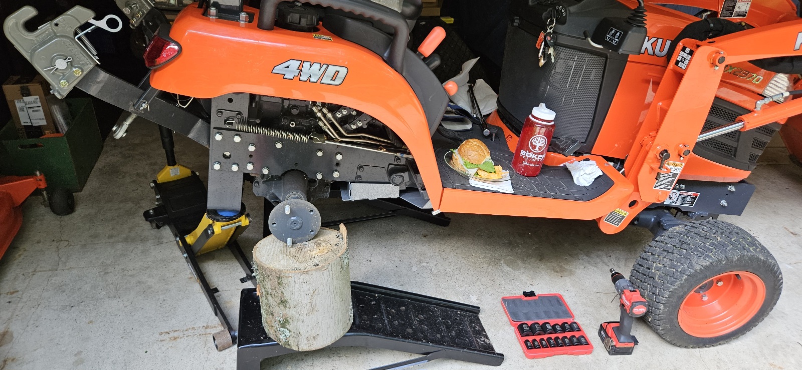

Rear remote is getting installed.
Rear remote hydraulic installation came to an abrupt stop when the Landpride kit wouldn't quite fit.
The extension pipe needs to be removed and needs a short nipple on the far side to match the nipple on the near side, but that's not in the kit. Dealer sent an inquiry to Kubota on this situation, which is the nice thing about having a great dealer.
Where's a good place to get quality 1/4" Pioneer style hydraulic parts?
