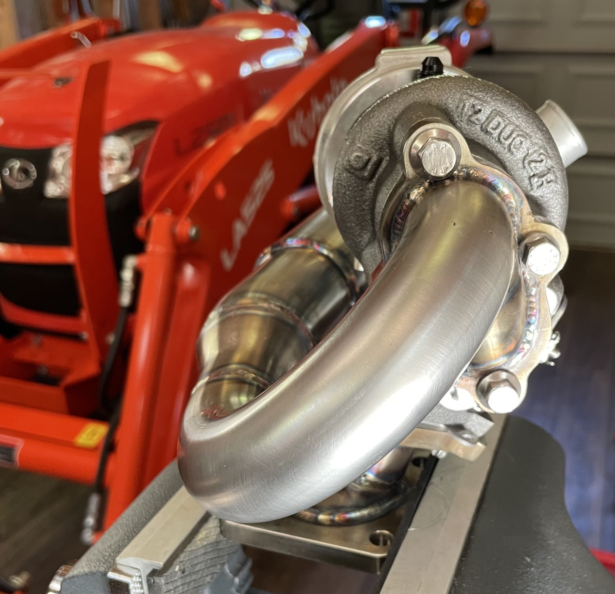

Couple recent Turbo pics;
Mike

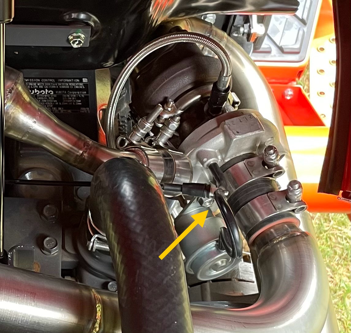

Looks like the EGT plug is in a different location?

That is an amazing piece of artwork Mike! It sure makes a difference using smaller diameter pipe coming out of the turbo. Mine is functional but not pretty. Making that sharp u-turn is a biotch.
Getting close to doing some tuning on my setup. Problem is, I don't have a good feel for where the fuel adjustment screw is on my engine (D1305) in a B2650. There is NOTHING on the internet. I might end up calling every dealer I can find to see if anybody can help me.
Keep up the good work!
Good eye.
Yes, Lawrence decided to move the EGT location…I’m not sure why, he didn’t ask. We have had one issue with probe interference with new location, while other guys had no issues whatsoever. He is either going to lower the EGT hole or return it to the original location for current/new Turbo Kits in production.

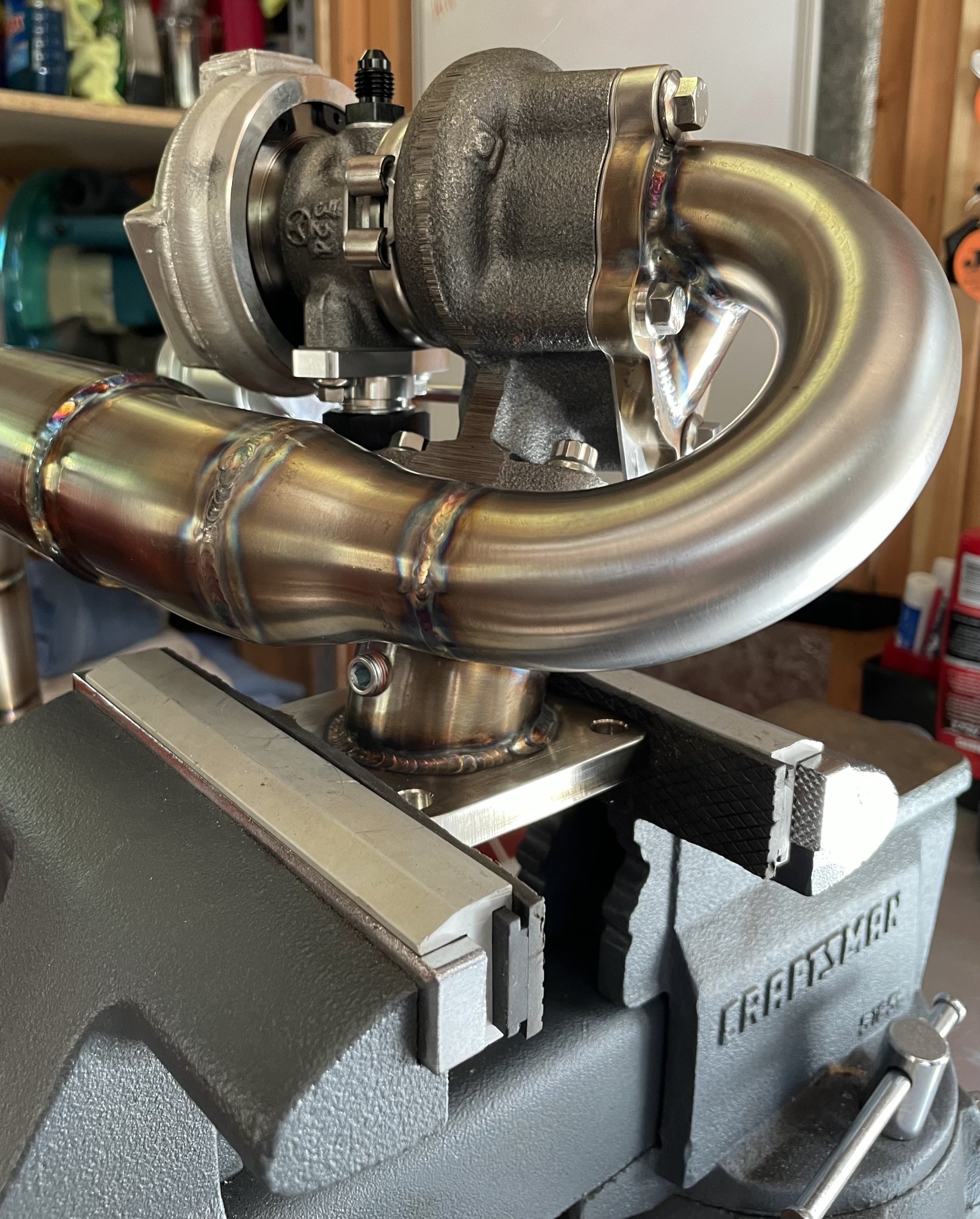

I am not sure what I am more impressed with.
The turbo work, or the cleanliness of that vice!!!!
Impressive on both counts!!!!!(y)(y)(y)(y)(y)(y)
Yes! I can tell you that the shop, the vise and the Turbo work are always that clean!
Thank you!
Lawrence is a master at his trade!

Thank you!
It took us some time to find the correct radius/bend for the Turbo exit pipe. It was trickier than originally anticipated.
Im not sure about your engine but, the set screw will be located somewhere on your injection pump. And, will likely have a security cap…which might help you locate it easier.

Hi Mike,
Question: On the S2T turbo kit, is there a fitting for the boost gauge to read from, or where is the best location to install the boost gauge fitting? Thanks!
I recommend adding a vacuum “T” fitting between the Turbo compressor housing and boost actuator.
Edit: We do include a vacuum T fitting (hose and hardware) if the optional gauge kit is selected. However, we are still lacking installation instructions for this option. :(
