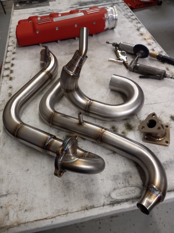

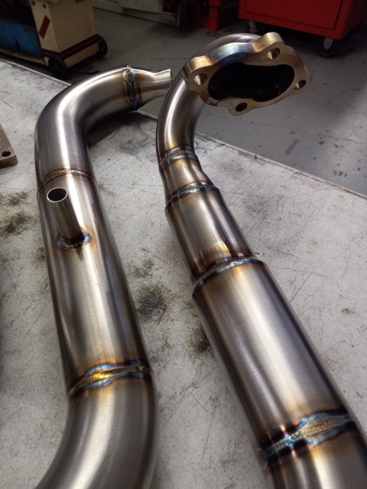

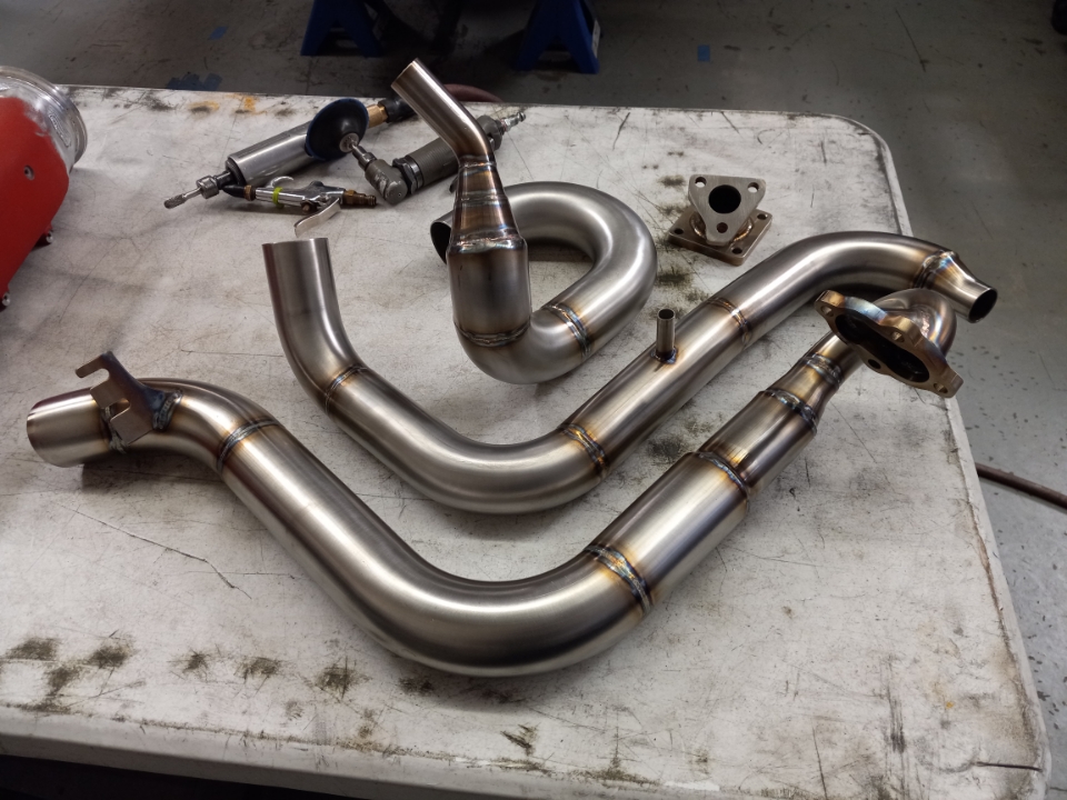

Here’s a few pics of the Turbo pipes along with….the new downpipe;
The new downpipe flows the same as the original pipe but, offers better clearance and easier installation.

Looks good Mike! Are you still selling a lot of kits? I made it through my first season with my turbo mod and had good luck with it. Might make some fuel adjustments next year to improve performance even more. I just about have my turbo instrument pod complete. I'll post some pictures when I'm done.

Very nice! :love:
A mini expansion coming off the turbo's exhaust port. Again, very nice!

Thank you!
I’m really really happy with the new down pipe! But, should I be ‘butt-hurt’ that guys are now getting L2501 Turbo Kits that a better than mine? It doesn’t seem fair.
We’ll be ready when you are. No worries.
