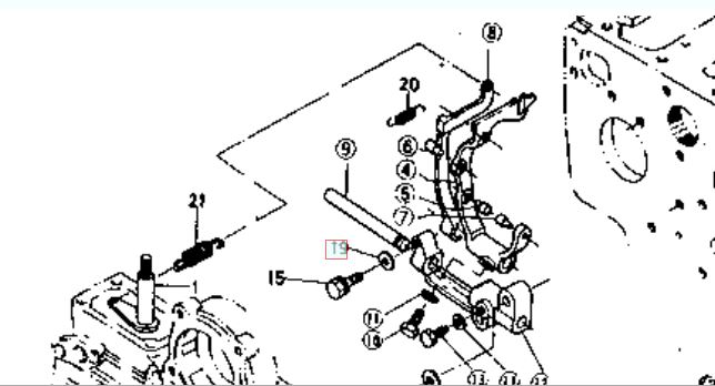

First you need to clean off everything around the injection pump and injectors.
Use air, brushes, and brake parts cleaner, no dirt, grease, flaky paint, or debri left behind.
Then use 2 wrenches and take off the lines at the injector and the injection pump, start with the front one and work back.
If you do not hold the injector or injector pump holders when taking off the lines you run a high risk of twisting the lines and breaking them.
Once all the lines are off, remove the side cover, you do not need to remove the speed control plate to remove the injection pump, but in this case you need to remove it to check the spring and movement of the throttle arm and governor, so remove the speed control plate lift gently as there is a spring attached to the arm, tie a piece of string to the spring (if you were to drop the spring into the bottom of the motor you would require tearing the motor down to get it back),
through the side cover remove the large spring off of the linkage and let it come out the front with the speed control plate.
Unbolt the injection pump and lift up, the rack in the pump must be forward to pull the pump out of a slot in the block.
DO NOT take any of the pump apart till you check in, because there are three to six parts you do not remove and if you do, you'll have to send it in to get it professionally rebuilt.
You are removing spring 21 (large spring) not 20 (small spring).

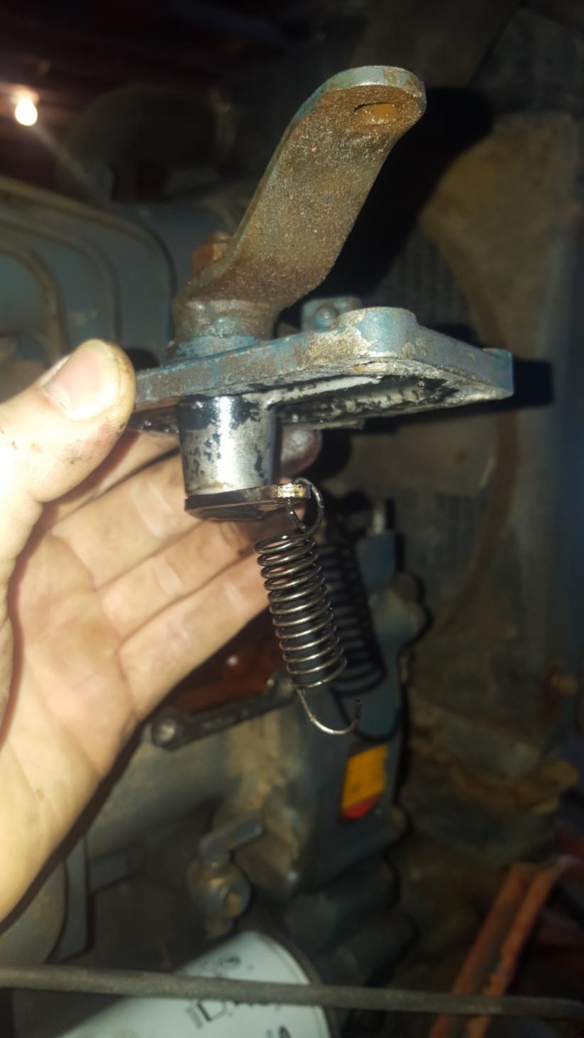

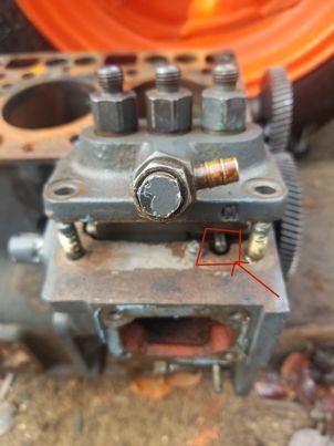

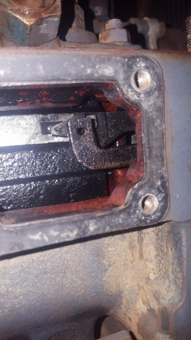

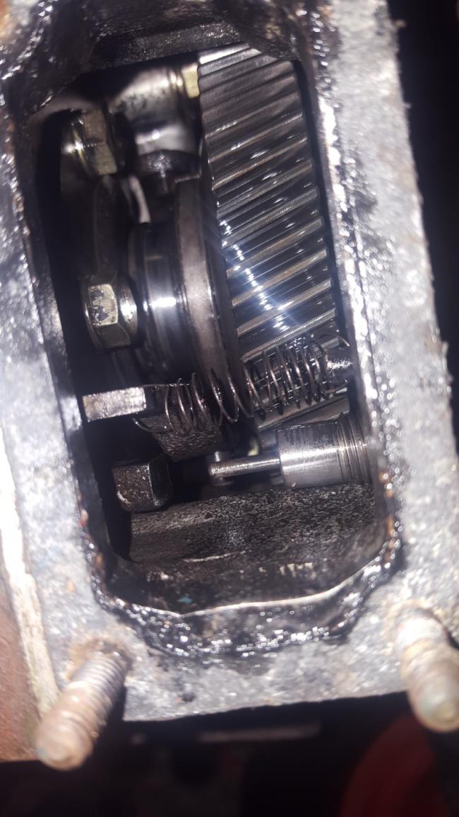

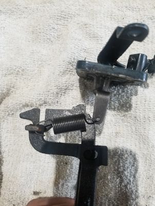

So I finally had some time to take the side cove and throttle plate off with the big spring. Everything moves freely. The small spring that moves the linkage that moves the pin on the side of the IP seems loose and stretched out possibly. Is that linkage arm suppose to move from left to right (back to front) smoothly with the throttle arm? Because it does not.
