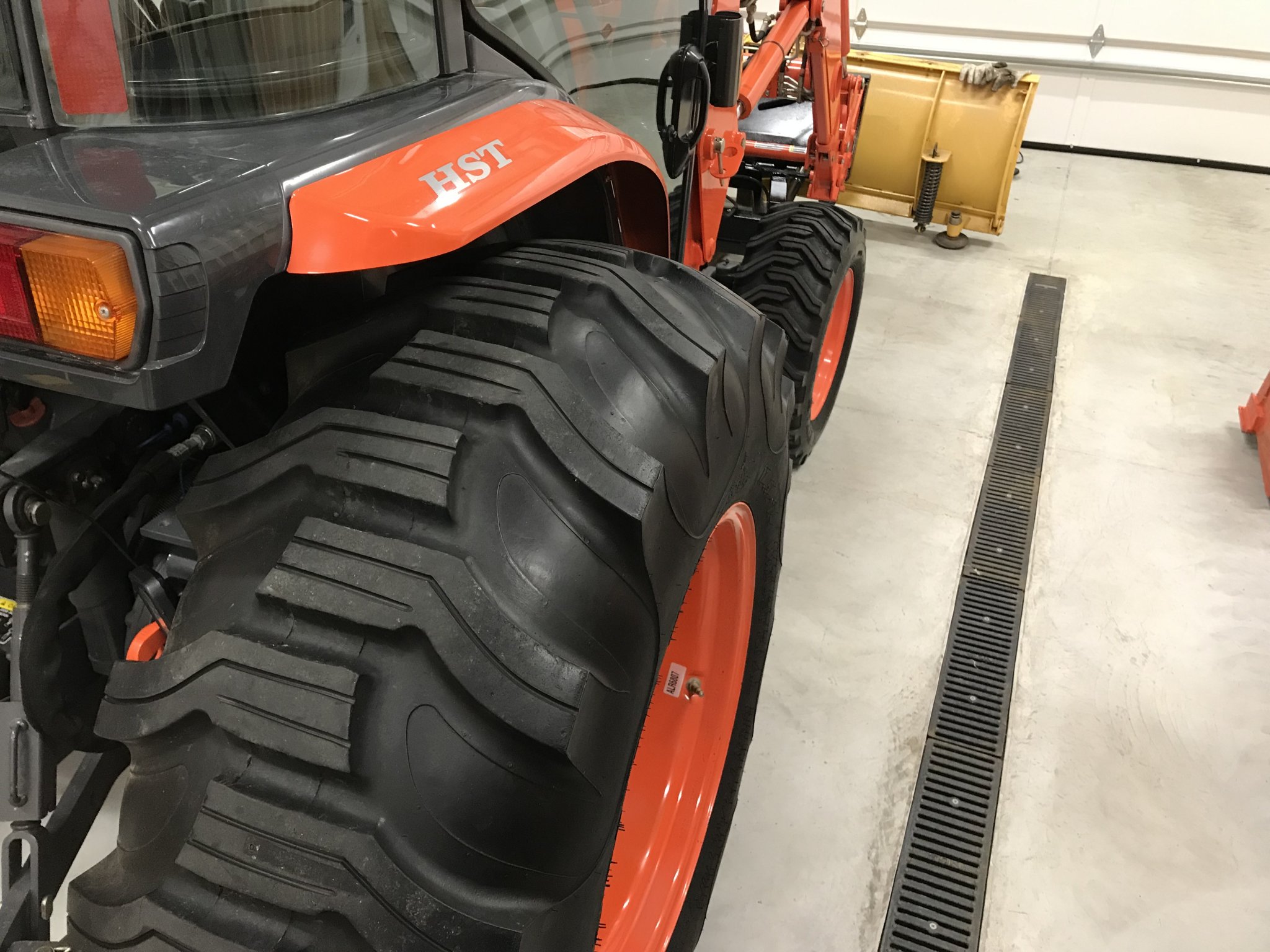

View attachment 52729 View attachment 52730
Chin, You did a nice job on those grooves. OEM? Noticed the long groove goes straight thru the entire lug. I like that . Have you used them in the snow? like the double groove on the wider part of the lug

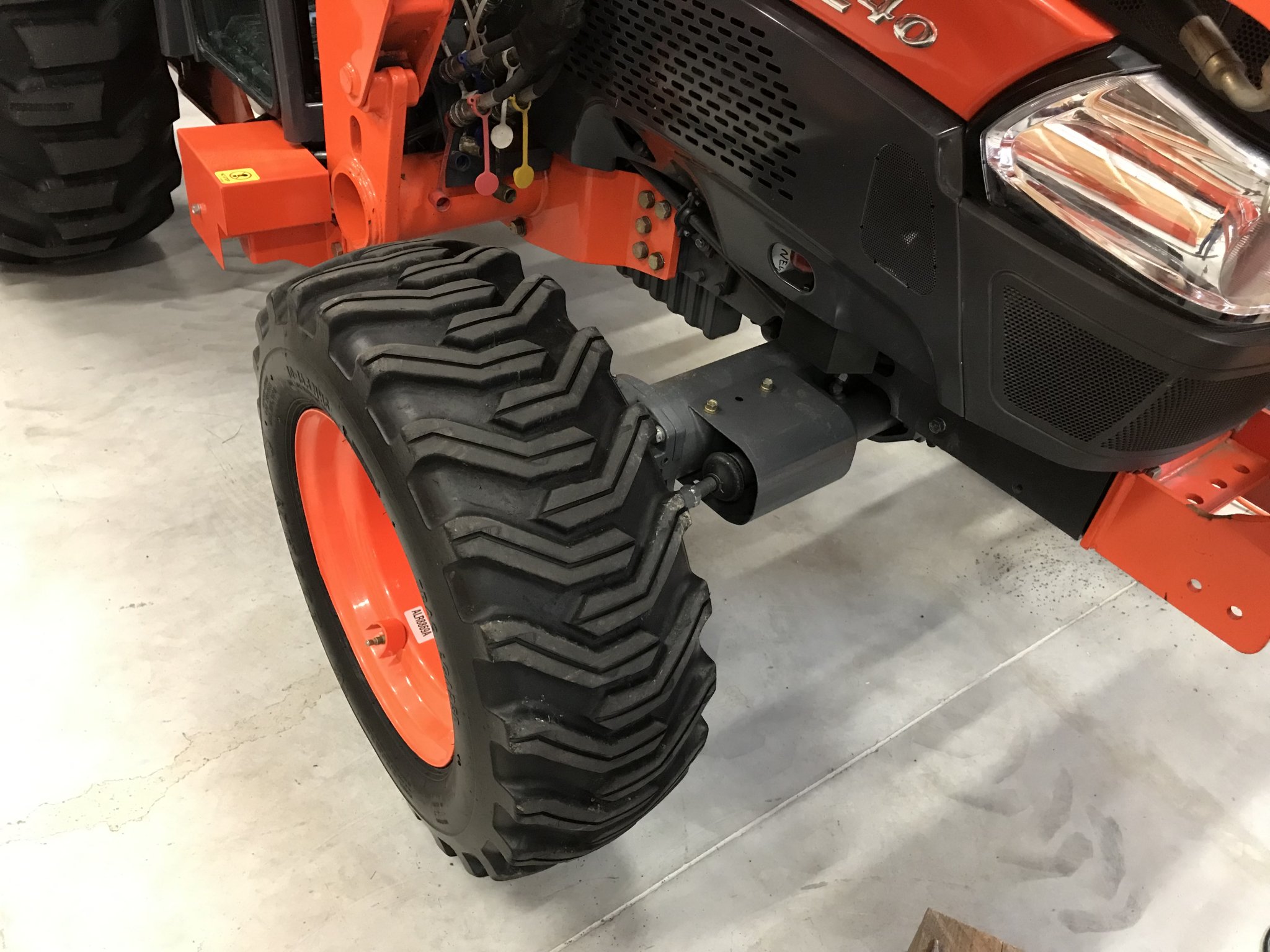

Been using them on the L3200 (sold) and more recently the L4240. Scroll down to post #652 in the link below for a short story:

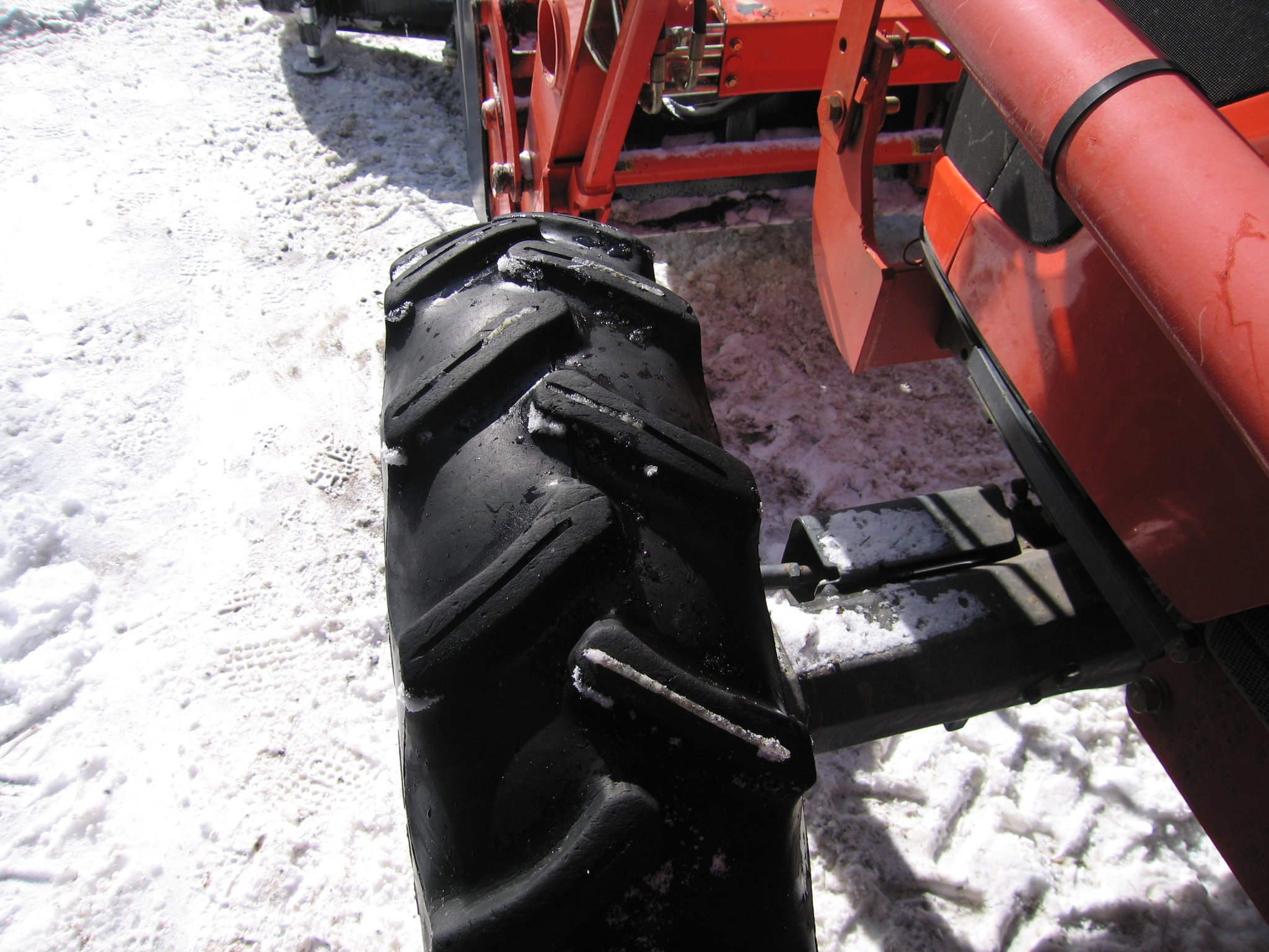

For some help steering when plowing snow or turning in slushy conditions. I tried out a single groove on the worn R1's, I did not want to risk breaking off a lug with more grooves
It helps up to a point until the wet/slippery factor tips in favor of the wet.
Then and in truly icy conditions, I put on the front chains. Once winter hits, rears are always on:giggle:
