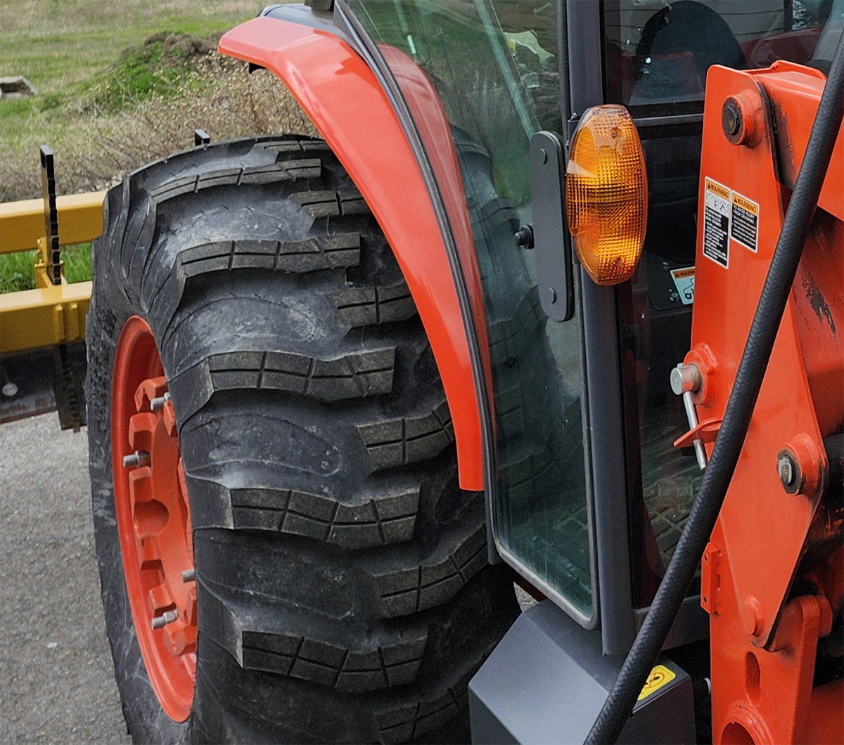

The R14's have a center lug that makes riding on pavement more enjoyable than on R4's.
When it's time to replace the tires on the MX I'll be looking at R14s for sure, assuming that they're still around. I took some design cues from the R14 tire when I grooved the MX R4 tires. The grooved lug is better able to mold itself to the terrain compared to a solid lug.

How long did it take to cut the groves in the lugs like you did ?
If you're asking me probably three to four hours for all four tires, but I did it in stages.

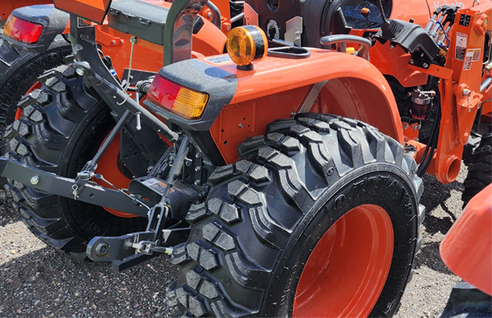

When it's time to replace the tires on the MX I'll be looking around. I took some design cues from the R14 tire when I grooved the MX R4 tires. The grooved lug is better able to mold itself to the terrain compared to a solid lug.
The tires in the top picture are not r14, they are the new r4 tires.
5,854
7,207
Oops .... here's the R14 tread pattern. Sorry about that. :giggle: I grabbed this image from an online tire retailer so assume that it's correct.
