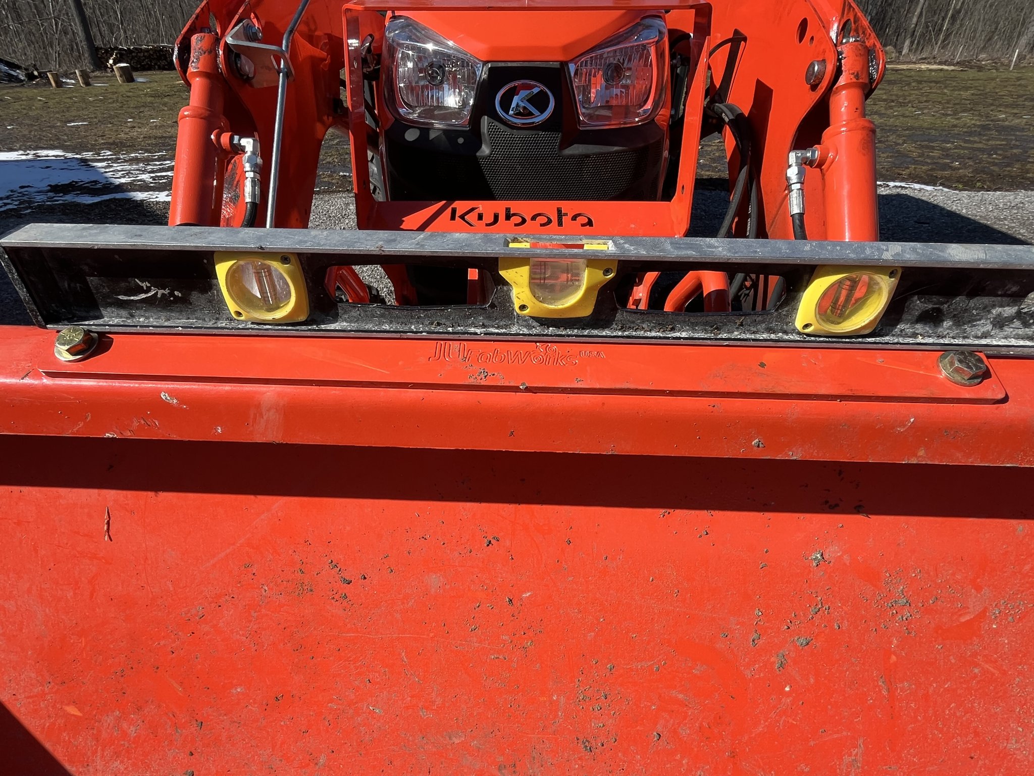

I have an LX2610 with approx. 170 hours. The tractor is no longer under warranty. After moving some logs, which the loader handled no problem, I noticed the loader seems bent. I made sure all the support bolts are torqued to specifications, a couple were only slightly loose. No welds appear to be broken but from inside the cab you can clearly see the left side is slower to lift and faster to return to ground. Attached are a few pictures on level ground. The closer to the cab the more level the loader arms. What else should I check? How best to determine the exact problem and how to repair? Thank you.

How level were the rear tires (the whole tractor) when you placed a level on the bucket?
If I was to get too particular, I would never stop repairing non-problems.
If I parked my LX2610 on what I presumed was level and flat ground, and got the level reading that you pictured, I'd be as happy as I am eating bacon. Which is very happy.
5lbs less pressure in one back tire would give you worse level results.
You might have bent it, but the next day you'll bend it back.
It's not a problem. Until it works badly or stops working altogether.

Ok, good to see the "don't sweat it" statement. The back tires are level and equally inflated. It's different than it used to be before hauling a few logs. Was concerned if there may be a broken pivot pin or something else that would lead to bigger problems in the future.
28,697
5,121
Ouch, you torqed it really good.
So I would say the loader didn't handle it without any problem, as that's clearly a problem!
That is not an easy repair.
You could try lifting another log with the balance off to the high side and see if you can torque it back into plane.

Check the OP's level pictures, Sir. That is not several inches high. It's less than 1 inch.

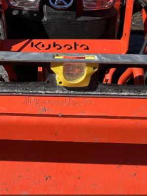

In the two pictures the bubble seems to be much further off on one picture than the other. Why the difference? One picture says leave it alone, the other says we are off too much.
If you decide to twist the frame it I'd loosen the mounting bolts prior. It could be the loader has been off a bit for a long time and the bolts were not tight enough and the loader moved and made the difference much more obvious to you.

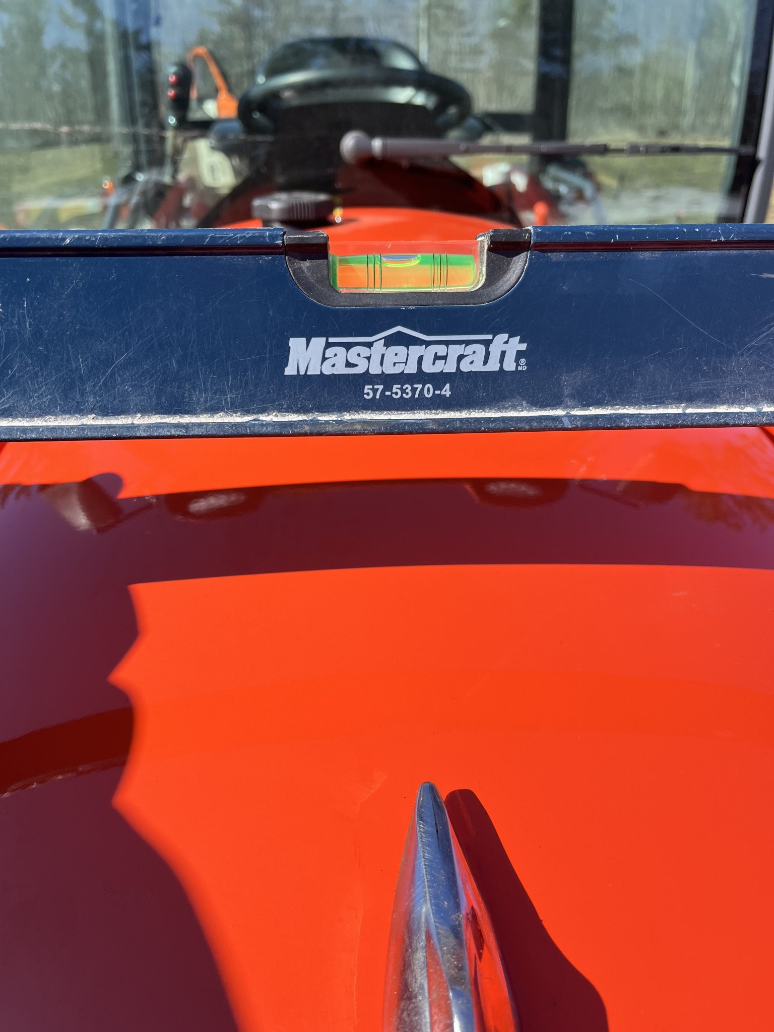

It appears that the first picture is the level of the bucket. Have to zoom in to see the bubble is way off.
Second picture is back over the hood so I assume it is on the loader frame somewhere. There the bubble is zoomed into and level.
I originally thought that the second picture was just a closer picture of the level in the first picture but it is definitely not the same.

Look back at the first picture and zoom in on the bubble of that picture.
I think your opinion will change
