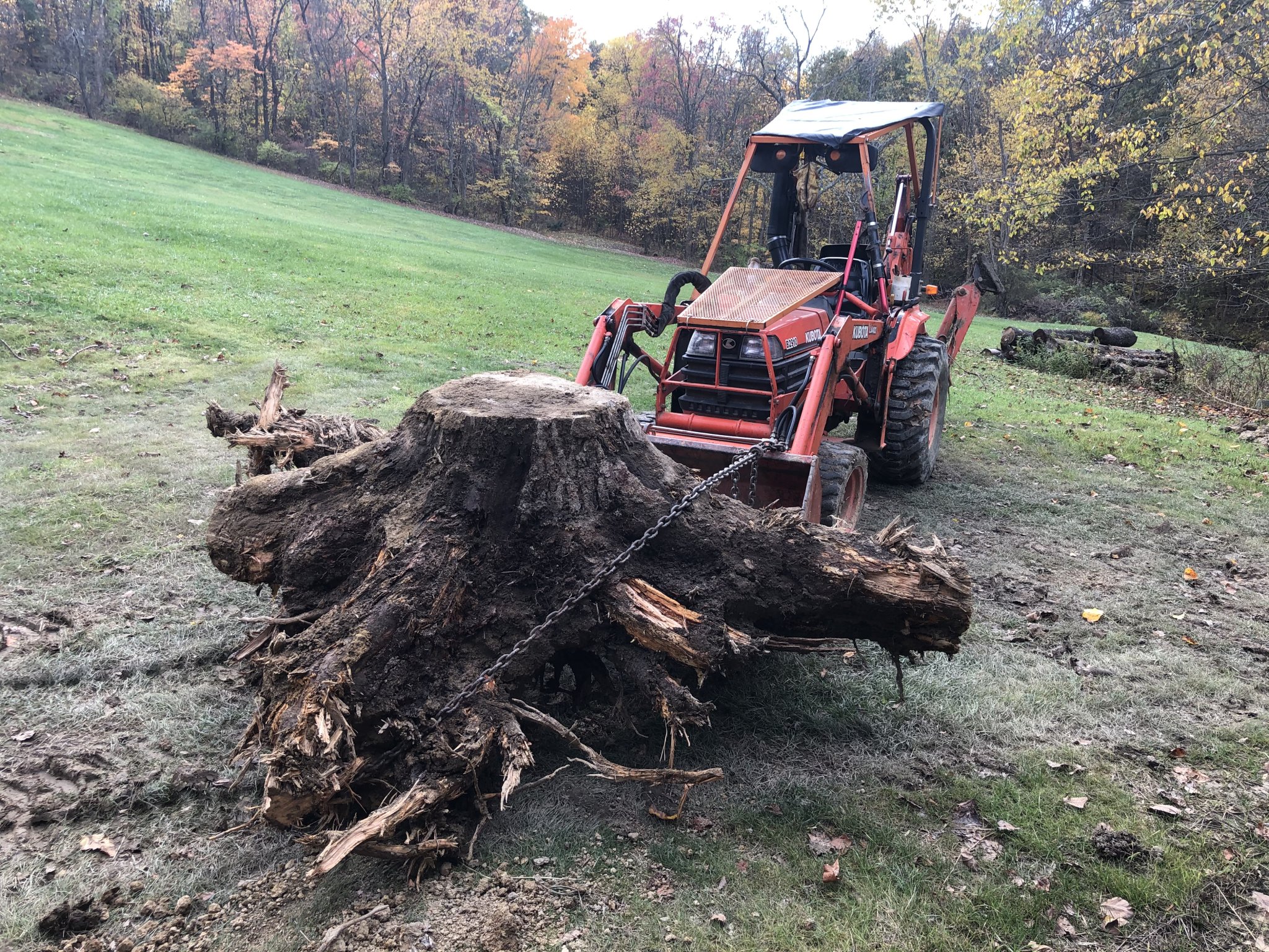

Here’s one example. I could only lift this stump about 3 inches off the ground, but it was enough that I was able to move it where I wanted to dump it.
And for the naysayers, yes I did dig it out with my three-point-hitch backhoe… :ROFLMAO:
Using that 3pt. hitch backhoe......it took exactly 3 weeks?;)

Is this a LA535 FEL? Curious what size logs you( @FarmtoLake ) were carrying (i.e length, diamter, species)
6,638
4,198
No, but probably a day.
We use the tools we have…
AND the tractor has yet to break in half...👍
Sure beats a pick and shovel!
