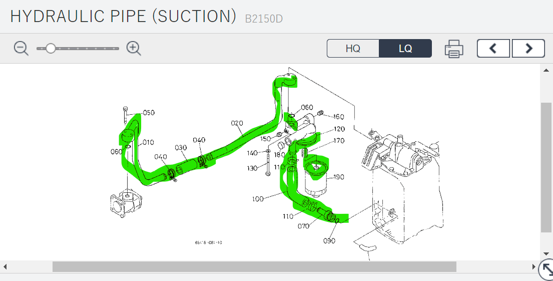

First off you have a B2150D not a B2150dcd.
Several options to what's going on:
Leak in the suction system.
Leaks in the suction side can present as wet spots and nothing more (look at all the green locations.
Weak / worn pump.
Wrong hydraulic fluid, that tractor should be using UDT or a good UDT substitute.
Bad / malfunctioning pressure relief valve, this is normally associated with all around weak hydraulics.
Plumbing done wrong to the loader valve.

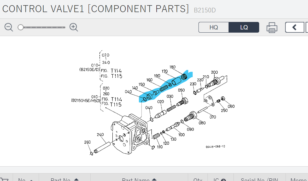

There is two on that model:
Blue is the main, and yellow is the accessory.
