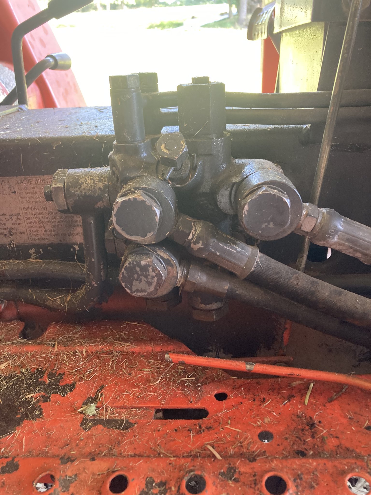

Unfortunately there is no easy way to hook a gaugecand valve to ypur particular pump. Could you explain exactly how you measured the pressure and exactly what numbers you got?
I connected a pressure gauge to the quick release on the valve body that controls the front end loader (it’s the only place I can connect a pressure gauge). Zero pressure at an idle. When revving the engine the pressure goes up and when I let off it falls back to zero. At 2000 rpms I have about 1500 pds of pressure.

Unfortunately that does not tell me much. Post a picture of the gauge hookup please.
It sounds like your pump is toast but it would be nice to confirm that before throwing more money at the problem.

I’m using the joystick on the loader to test the pressure
Thank you - thats helpful. With that arrangement you have two relief valves between the gauge and the pump. May be grasping atvstraws but it would be nice to get a pressure reading with them out of the circuit before cindemning tje pump. A new OEM pump is $1300!!!
You can easily eliminate the loader relief by moving the gauge to the hose supplying the loader valve. Just disconnect that hose at the valve and connect the gauge directly to the end of the hose. Start the tractor and read pressure at idle and full engine RPM.

This valve has 3 hoses running to my loader valve.
