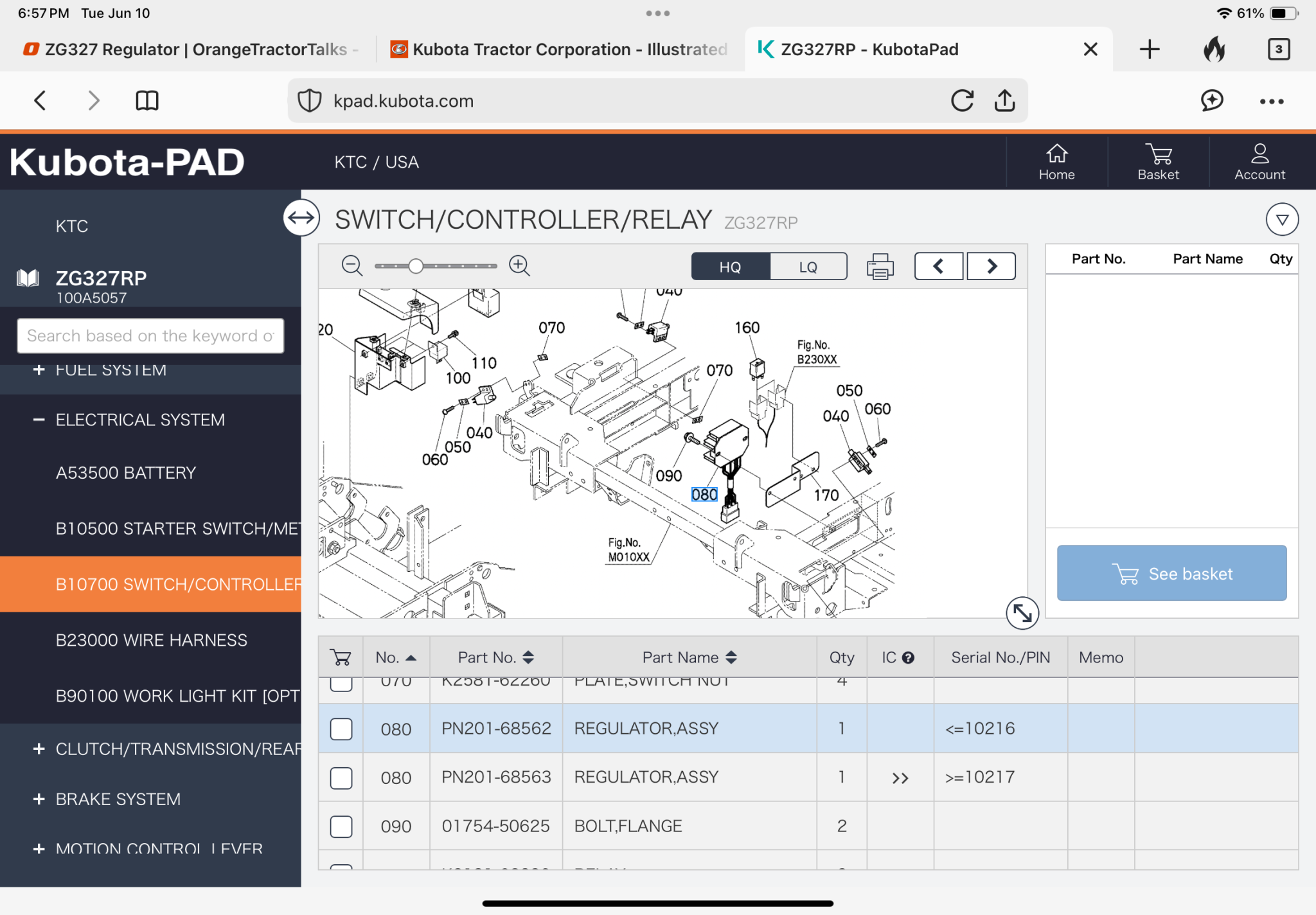

Not sure where it is on the mower but look at illustrated parts lists here
This is where the voltage regulator is shown but you will have to look at the frame sections to find where it really is. It may be a jigsaw puzzle to put together where it is located.
I would suggest you remove the battery negative battery terminal before you start work, remove the old one, install the new one, put it back together and then replace the battery cable on the battery.

MANY thanks to both of you. It was right under the seat as suggested. Also, the photo of the illustrated parts breakdown pointed me in the right direction on where to look for some other pieces/parts to replace some worn/aged items (discharge chute, etc.).
One note for future readers who might be tackling this project... There's a linkage arm of some kind that sits right in the way of the path of the socket for removing the regulator. It was a simple thing to simply disconnect one end of that arm and move it out of the way. You CAN remove/replace the regulator without doing that, but the socket won't sit straight on the bolt head, and you run the risk of rounding the corners of the flanged head.
