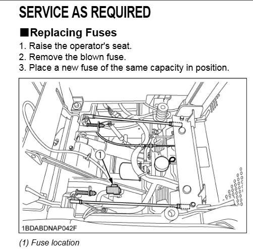

I'm not sure, but believe, there's a blade fuse, but have forgotten where.
Does this sound like a blown fuse? And where to see it?

I checked the little plastic fuse box, under the seat. They are all good. None blown.

I'll try to get down there and pull them and check

The two you highlighted in yellow, I can't see them. With the seat pulled up I can't see them and from the outside, they appear to be behind the gas tank.
I took a headlamp and flashlight and just can't visualize them.
I can't get on the ground and look up.
I'll try again tomorrow. Sorry to seem inept. Things that were simplistic are difficult physically after a stroke. I change my blades with one hand. I have that process down.
I don't understand why I can simply see the fuse boxes. 🥴

Yes, the most recent diagram is the one I found, easily. They were all good. Both visual and ohm meter tests.
