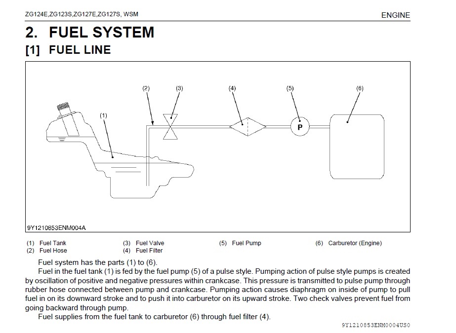

When you were having to add gasoline to the carb did you ever think to check the fuel pump?

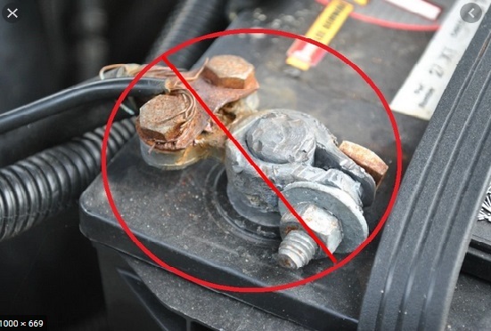

Are you stating the battery is brand new? What about the battery cable ends?
Any like this one:
You need some basic electrical equipment to solve your problems in an organized logical fashion.
A 12 volt test light and a cheap multi meter.

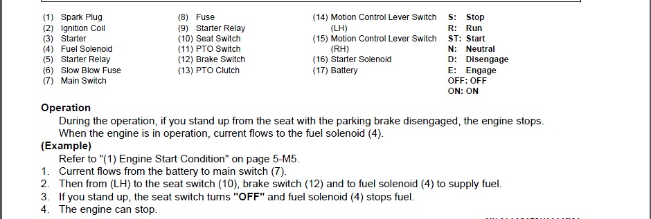

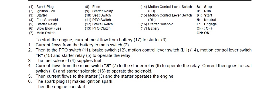

Your machine will have a complicated OPC (Operator Presence Controller) system.
If you don't have any experience diagnosing these systems it might be time for dealer's help.
