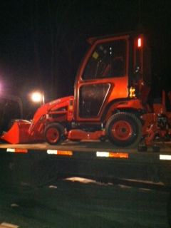

Marvin from Barlow's pulled into Lil' Rhody with this new BX25D, and off went my good 'ol BX24. I enjoyed 800 hours on her, served me very well but her time had come. polar vortech, 30 below windchill, and 18" snow, meet heated cab. I'm very fortunate to have this and appreciate all the tips on this forum. can't wait to bolt on all the fun stuff and get to work.

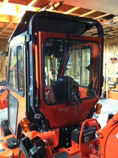

thanks guys. only thing I'm going to change for now, I've got some rear lights on order and I'm going to swap out the switch box that powers the accessories with Curtis' molded top radio/speaker/switch box. the one I ordered takes up a significant field of view whereas the molded panel seems a bit more integrated.
Jetman, the heater is on a double pole, double throw switch for High/Off/Low settings as I understand...yet I couldn't notice a difference between the High and Low output. How's yours? BTW, thanks for the inspiration to go cab!
I had asked my own questions here on the noise level that the cab produces, so a little app on the iPhone measures 90dB at 2500RPM, 70dB at idle. quite tolerable given the advantages in comfort. you hear a bit more whine of the hydraulic than the open air. I really like the fit and finish, there is a lot more of a sealed-up feel than I anticipated. the flexibility of popping off the rear glass, the rear wiper, the doors. all seems very well executed in design.

The heater fan is hi/lo, and I can feel a difference, but like you said not night and day. But if you get your tractor working and she is warmed up you will see a deference then. I have mine on hi all the time unless one of my grandson's is standing in front of it. He will feel the heat.
During that cold snap last week I did tape off my radiator screen to block off air and to get it warmer. Just a thought if it gets really cold again. This did not send my temperature up hi, and I still had plenty of air to cool the engine.
Block off all the open air places in your cab , big point is under the seat.
I have been out when it was zero at night and just having some place to climb in and get my fingers warm , stopped me from getting frost bite! If your windows fog up just turn on your over head fans in the console, seams to do the job keeping the fog down for me. I also never turn my engine off when outside , because a warm place makes me want to work outside longer.
Yes I love the overhead console and how simple it makes wiring up the cab. I did replace the overhead light which is junk, Sorry Curtis that is the way I see it, because mine did not work . You know how I feel about junk, it wound up against the wall HARD.

jetman,
looks like your switch/stereo console is mounted approx. in the middle of the ceiling. I thought it might be designed to tuck right into the front of the ceiling? when you did the install did you follow their precise instruction or was there room to put it where ever you wanted? my reason for looking at the molded console is I thought it would really tuck up tight to the front. my current switch box is at the top right, bolted to the front lip but taking up windshield space on the top right.

My console is installed on the roof where I can tilt it open , so that the rear glass wall can be removed..
You would have to come up with some kind of brace to hold the console if and when the roof is tilted to the open position to use the backhoe. If you tuck it in tight, how would you support the rear end of the console. Now you may want to build a support for the rear console so you can move yours more forward than mine. You could tucke the console up tight to the front, only if you never plan on opening the roof or you don't plan on making a support bracket.
If I knew what I was doing I may have done that to. I only had two weeks off from work so I was in a hurry to complete all my add-on since I didn't know how long it would take.
I looked at all the pictures I could find on Google before I did this to get an idea what others did and why they did it that way. I searched every picture of a BX25D with a cab on the internet before I started this project to get all the ideas I could. I never had an idea of how to do any of this kind of stuff before.
Curtis does not tell you in the instruction where to mount it. It is your choice where to mount the console, and that is why they give you so much cabling wire. They don't even tell you what to mount it with you have to figure that out.
My dealer wanted $750 to install my cab , so i did it myself, but it took me two weeks to do it. I did it right as you can see the wiring is very neat and my cab installation was per the book. Some times you have to make changes so things work well for your use of the tractor.
I used elevator bolts with rubber washers and self locking nuts to hold my console up. Curtis recommended to me to us double sided tape to hold it up. I wanted nothing moving in my cab or someday falling down so I did my way, built to last.
I hope that answers your question. If you need better pics let me know and I will provide them.
I plan on in the future to make a cover to hide the wires behind and paint it dark gray like the inside of the cab. That job is not an important issue at this point because it will not be put in a show or magazine.
