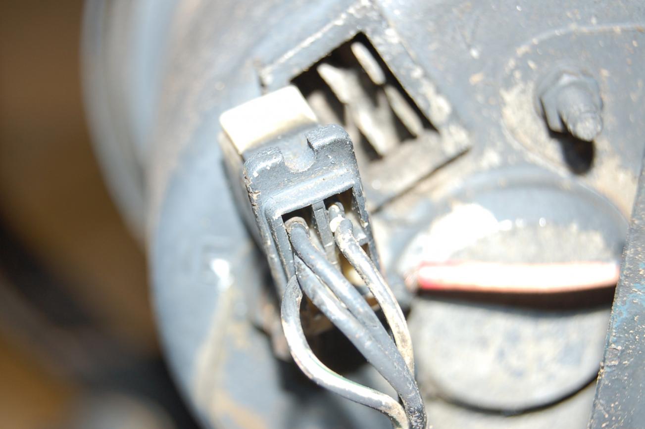

I just got done rebuilding my wiring harness covering and I too have a 4 pin alternator, however one of the right pins is not used I cannot remember if its upper or lower looking at the backside of the alternator, I am very new to the L 1500 world (2 weeks) but I do believe and L 175 alternator would be the same? Look at your wires on your actual plug I think you have two whites with tracer colors and then two ground wires connected to one pin. Hope this helps.

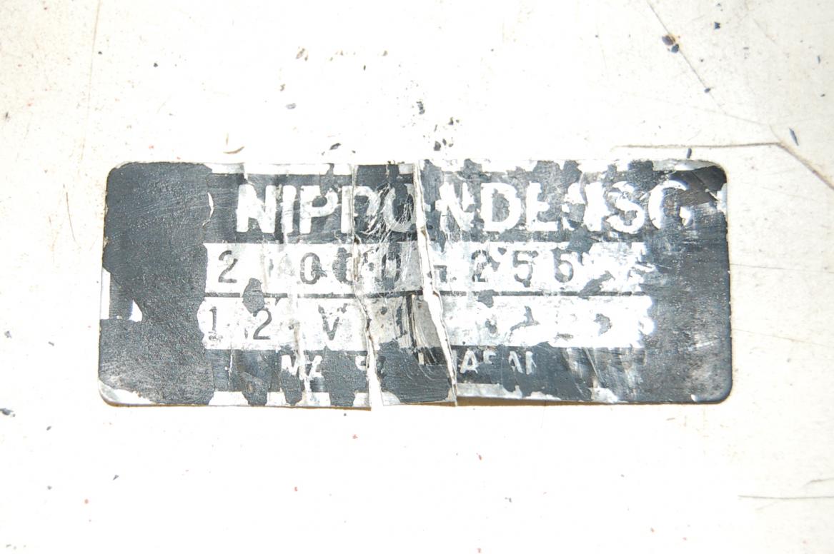

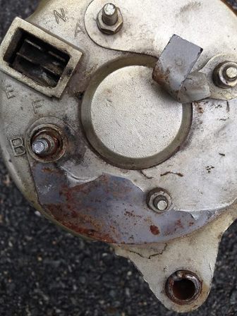

Here are some pics of mine, and the label
(why don't people invest in masking tape before they slather paint on everything?)
cleaned up as best as possible.
According to my parts books, the number for the
L1500 / Z750 is 15221-6401-2 and
L175 / Z750A is 15221-64012
Again a newbie speaking but seem to me, Same Thing,
Go to KUBOTA tell them you need an alternator for a L175?
Comments from the long timers?
NIPONDENSO is huge, makes almost everything electrical for Japanese motorcycles,
should not be hard to match-up / find.
