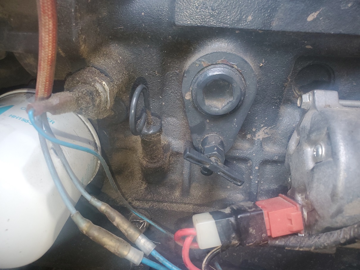

Manual just says to open it. I tried to open the petcock gently with pliers and it was not moving. Noticed the nut on the end of the opening for the petcock. Tried taking that off with a fair amount of force and it would not move. Afraid to apply any more force. Can someone tell me how to open this.

I ain't never had to use pliers normally just grab it by hand and loosen (to the left) the valve. IF it's stuck, prepare to break it off. Then you just remove the remnant from the block and plug the hole with a NPT plug.
14,565
3,323
If you can get to the lower hose just pull that off,, makes a mess but you aint gona twist the petcock off and have to get a new radiator

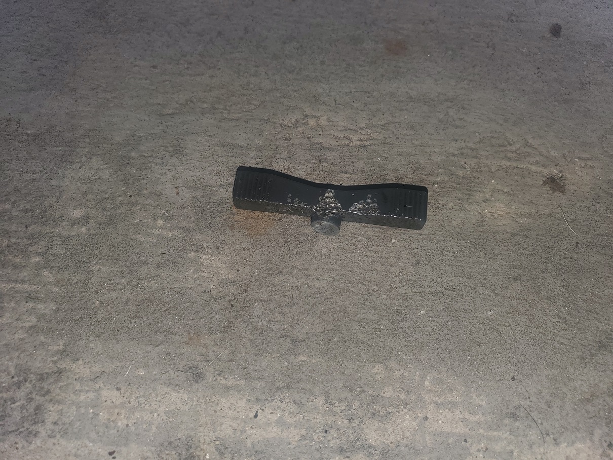

Welp....... Put PB Blaster on it a few times. Let it sit for 30 min. Went back and forth slowly with the pliers. Appeared to be making a little bit of progress and then snap. Put some PB Blaster on the nut. Used a 6 point socket and tried to get the nut off but it is not budging. Is that nut supposed to come off? Pretty sure it is.

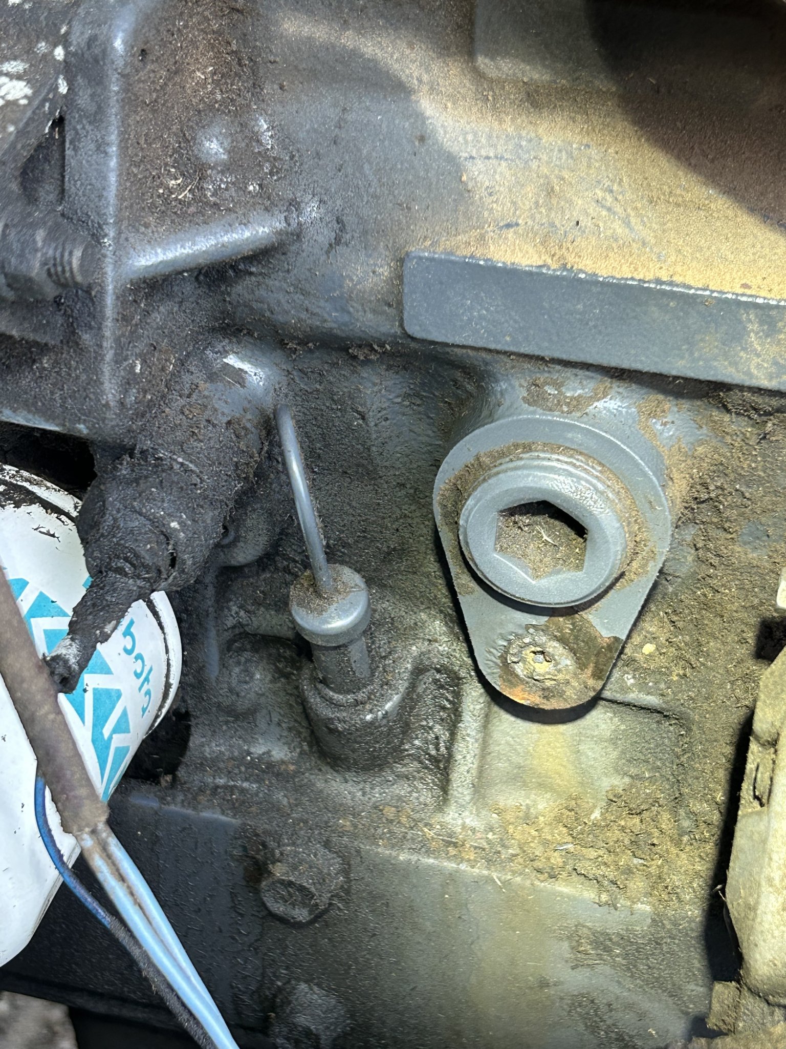

I would like to get all the fluid out so I want to replace that drain. Maybe a call to Kubota is in order.

replace the drain valve assembly.

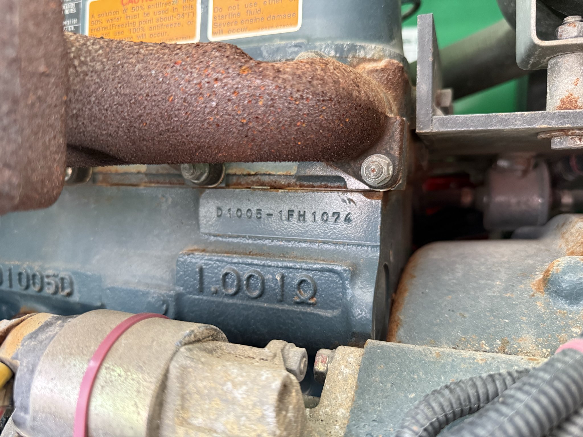

There are two different ones depending on the serial number of the ENGINE (not the tractor).
15841-73020 or 16871-73020
engine serial number is near the injection pump stamped into the block-usually directly below the pump. It will be something like D1005-8J045 or something like that, you're looking for the last of the characters post hyphen, in that example 8J045.
while you have the drain valve assembly out have a look-see at what the inside of the block looks like. Hopefully it's not rusty.
