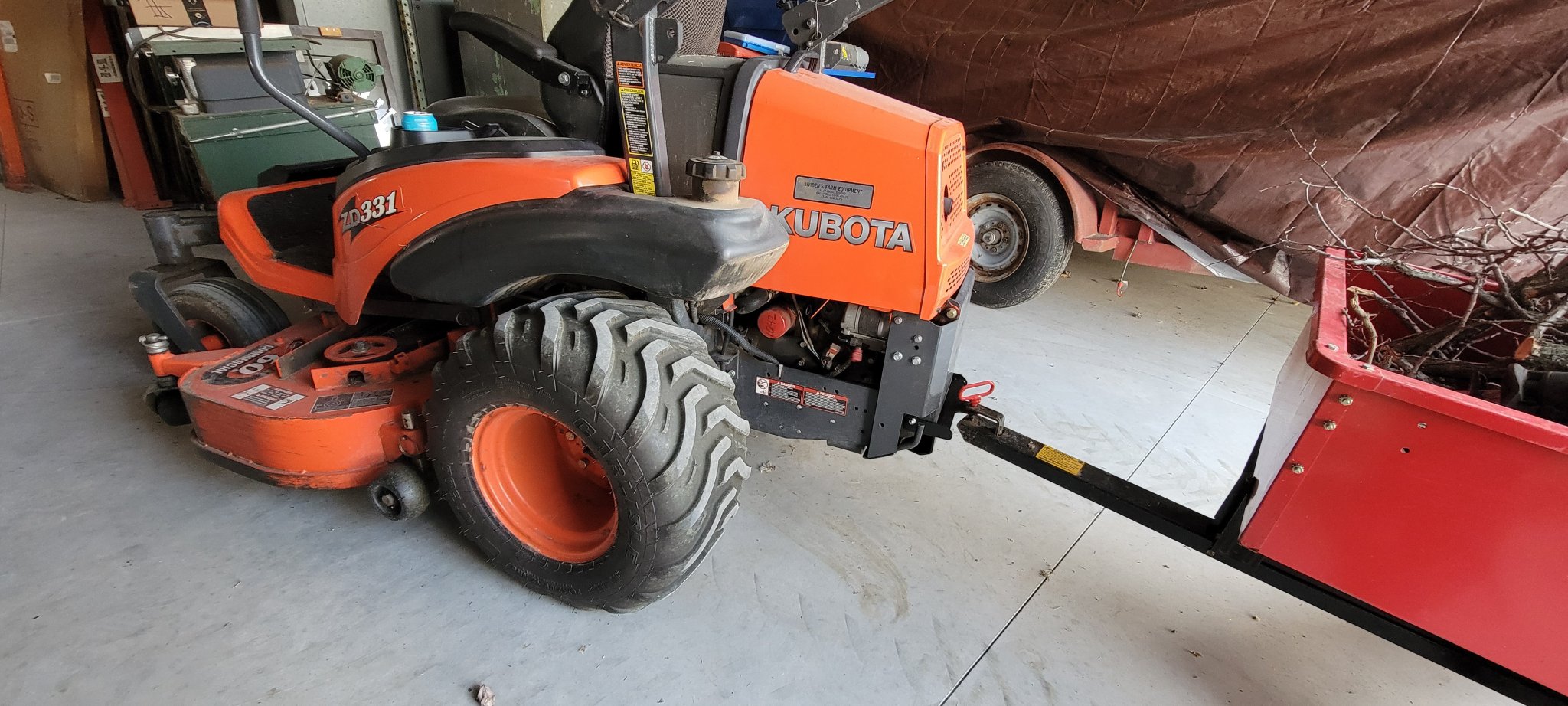

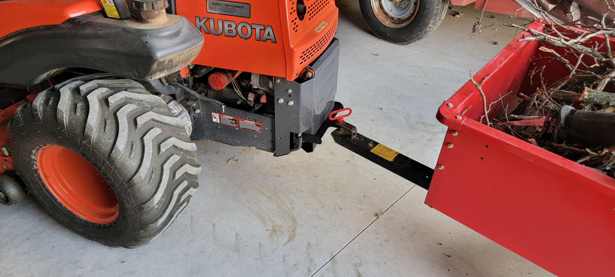

Made a few additions to my zd331 from the zd1211 catalog. This possibility may be common knowledge but I was unaware.

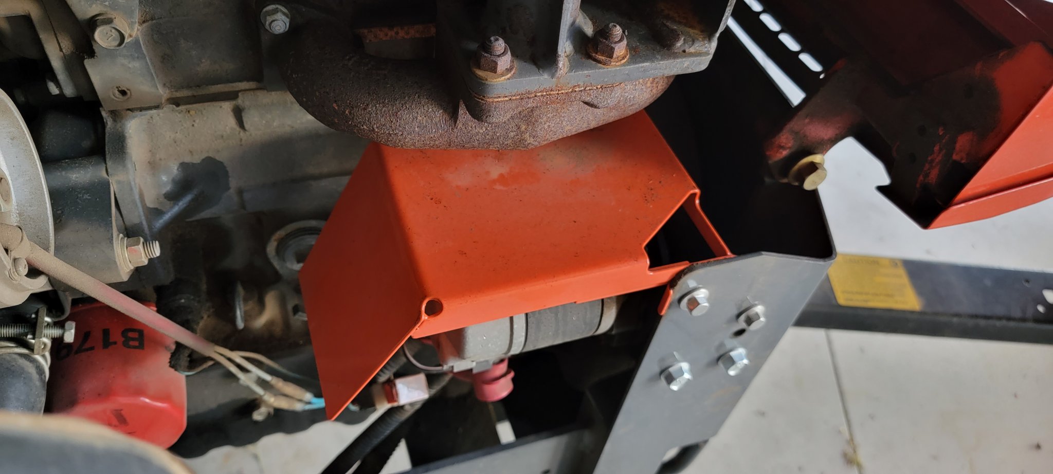

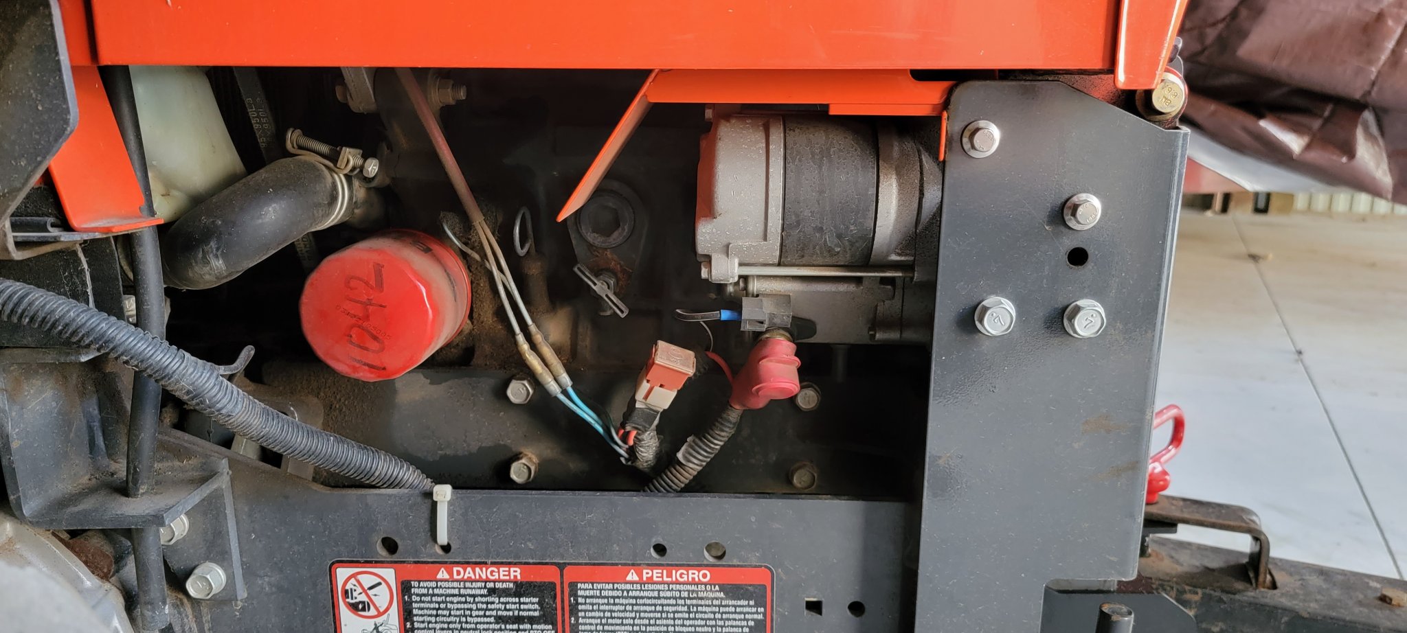

Started when I found this thread in 2021: http://www.orangetractortalks.com/forums/threads/zd326-starter-problems.46924/
Which said the zd1211 starter cover would fit the 331 and 326. So I ordered K3181-83253 from Messick's and SS Flanged M8-1.25x20 bolts from Amazon.

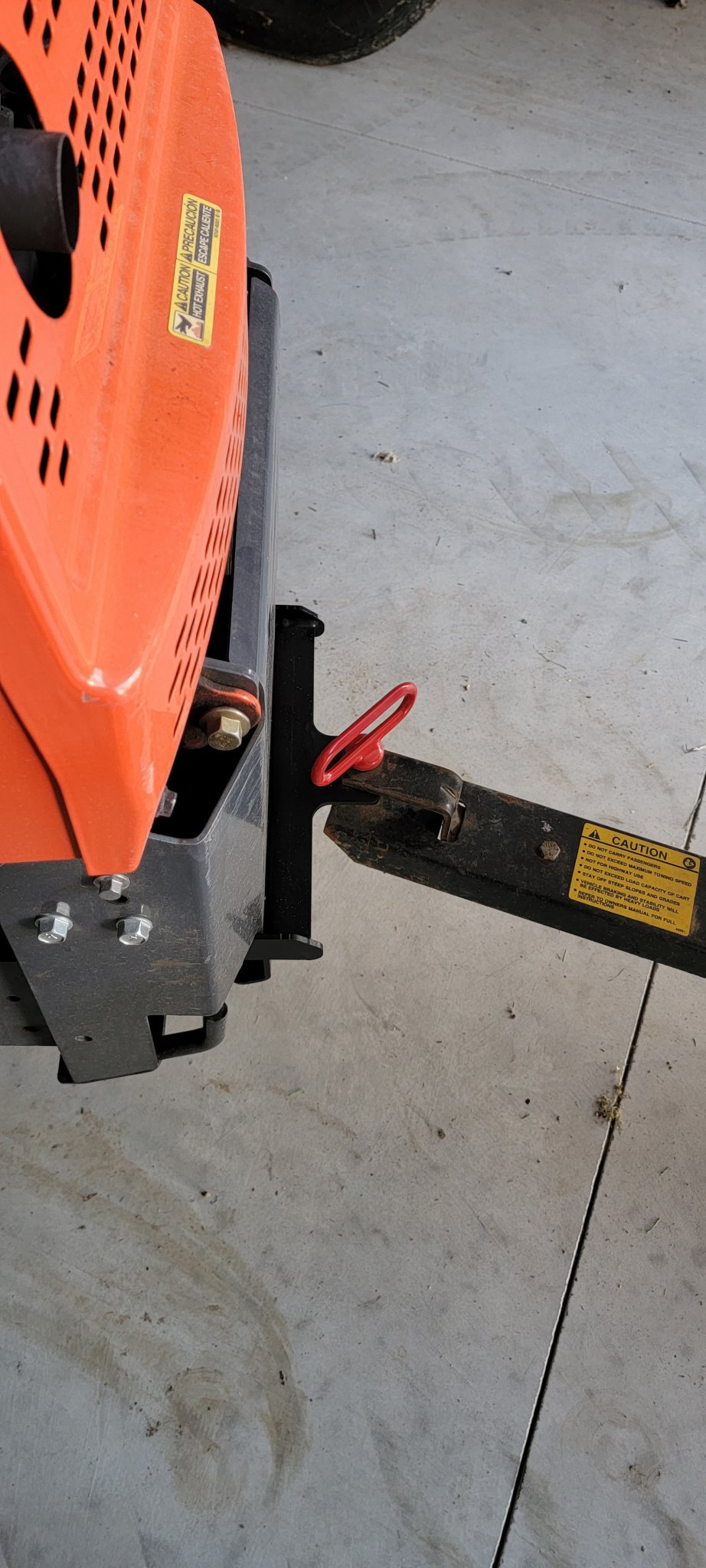

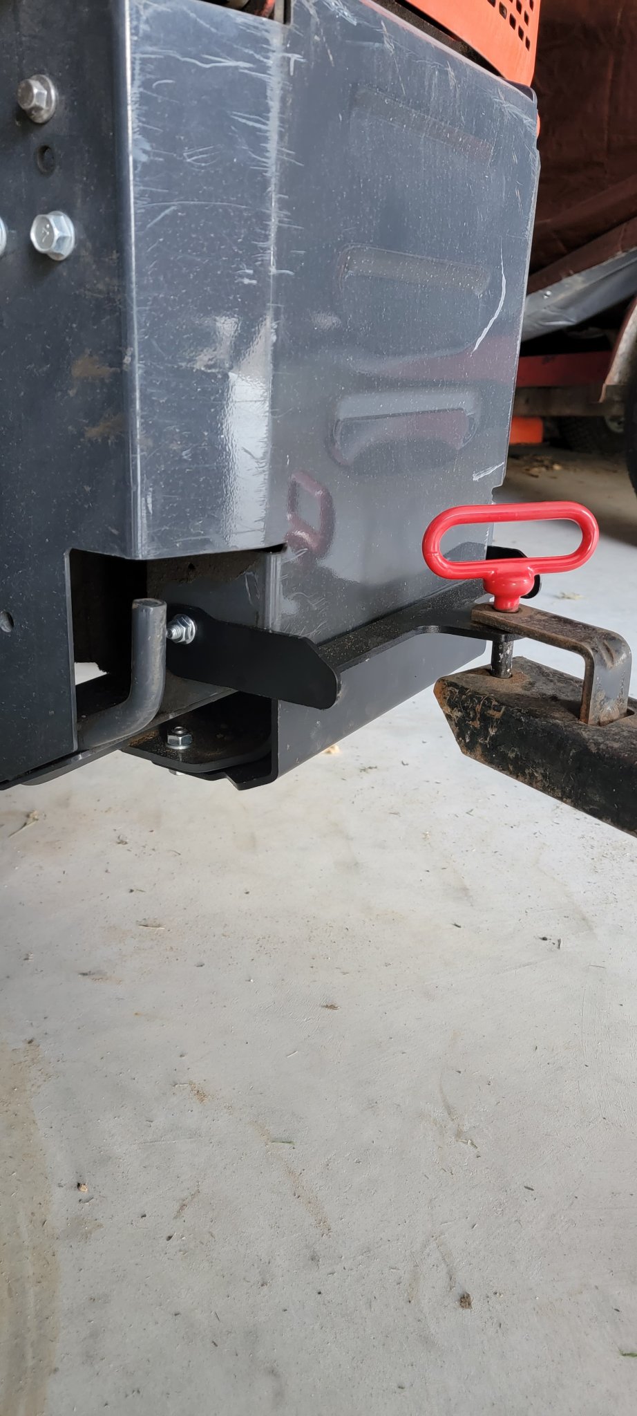

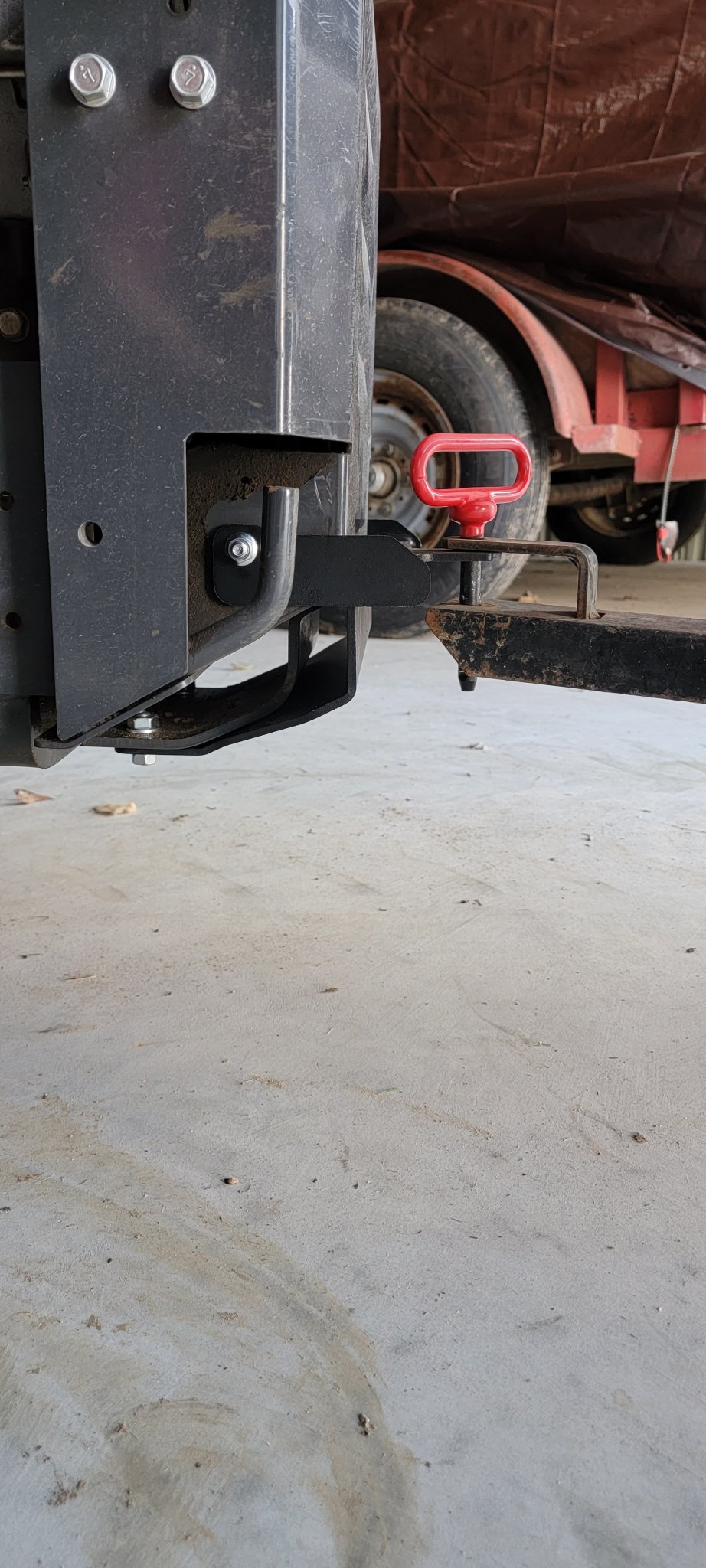

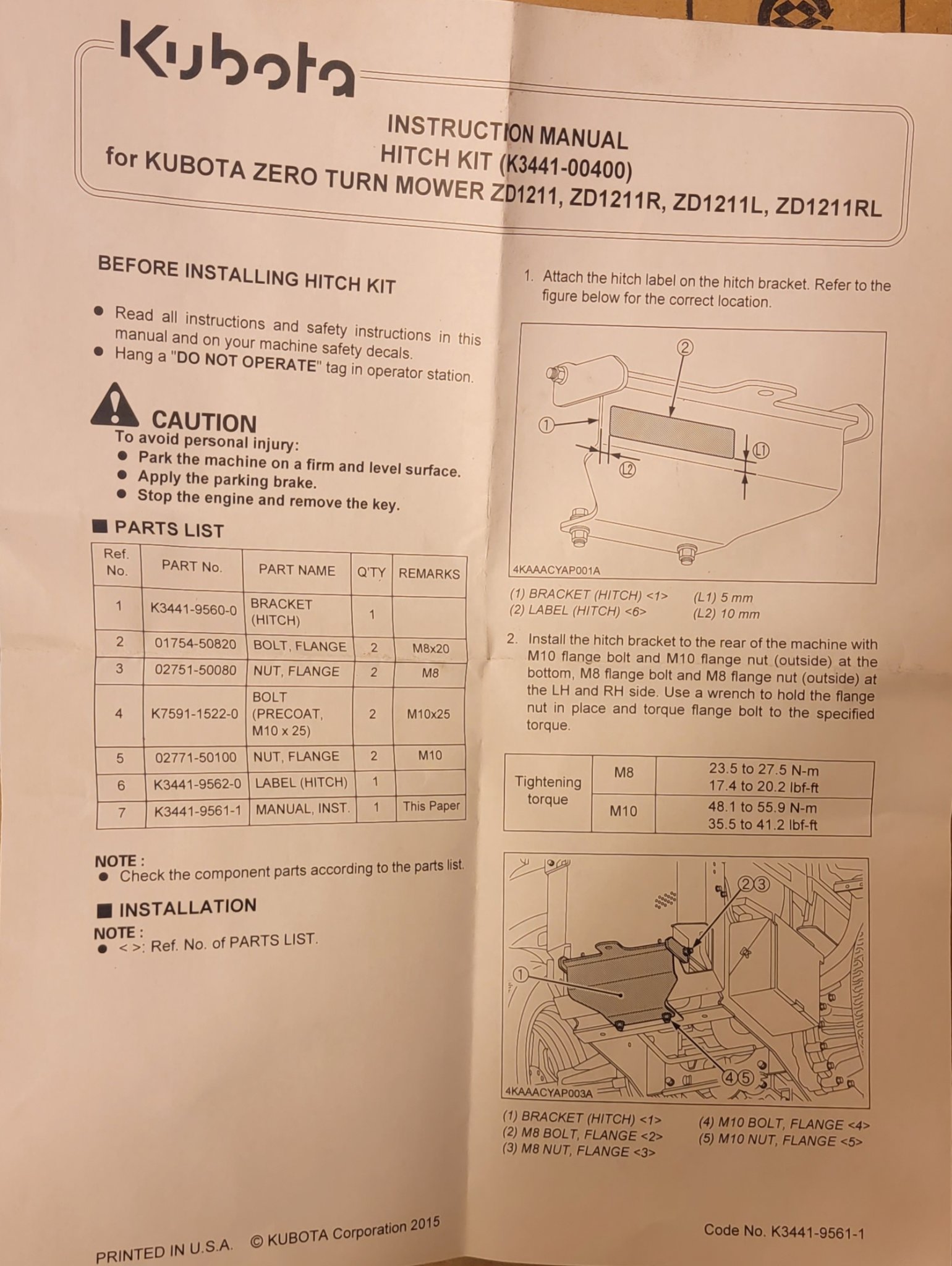

More recently I was looking for a hitch option and found the ZD3358 hitch kit. Looking at the diagrams it looked like it would bolt right up, was able to confirm that today. Ordered from Coleman Equipment.
