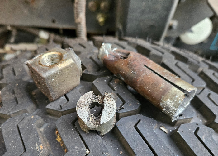

I can't find much reference to my problems with my ZD326 mower's anti-scalp wheels, so I guess I should tell all now.
When I bought this mower, I noticed there were no front anti-scalp wheels on the corners of the deck. The seller offered me a big discount for this and other reasons, and he said his dealer had told him he didn't need these wheels on Florida's flat ground. I knew what the parts for new wheels cost, and I figured it wasn't a big issue.
I did NOT notice that there was no paint on the tubes for the front wheel shafts. Somebody had used a torch to get the old wheel shafts out. It was either the seller or the old guy who died and left his wife the mower. I should have realized this meant there would be similar problems with the rear wheels.
I eventually realized I needed to change the height of the rear wheels. They were a little stiff, however. As in frozen in place. The shafts were stuck to the upright tubes.
For a couple of weeks, I have been trying to fix this. A three-foot pipe wrench didn't work. Air hammer. Machinist's sledge. Penetrating oil. None of that worked.
I eventually decided to drill the port shaft out of its tube with a cordless drill. I figured I might make it so thin, it would be easy to collapse it and get it out.
I blew up the drill using Silver & Deming bits to get the shaft out. I ended up turning the shaft into a pipe with about a 1" hole all the way through. I cut off the ends so there would be less metal to deal with.
Yesterday I started trying to split the pipe lengthwise. I used a carbide burr and a hacksaw, inserting the hacksaw blade in the pipe and reattaching it to the handle.
Today I decided to try heat before continuing. I heated the shaft to over 300 degrees, and I froze it afterward. I did this several times, and nothing moved.
I bought some sawzall blades and went to town. From time to time, I peeled the shaft shell away from the tube and used a hammer and punch to try to pry it off the tube.
Eventually, the shaft shell fell out while I was hammering the punch. I couldn't believe it.

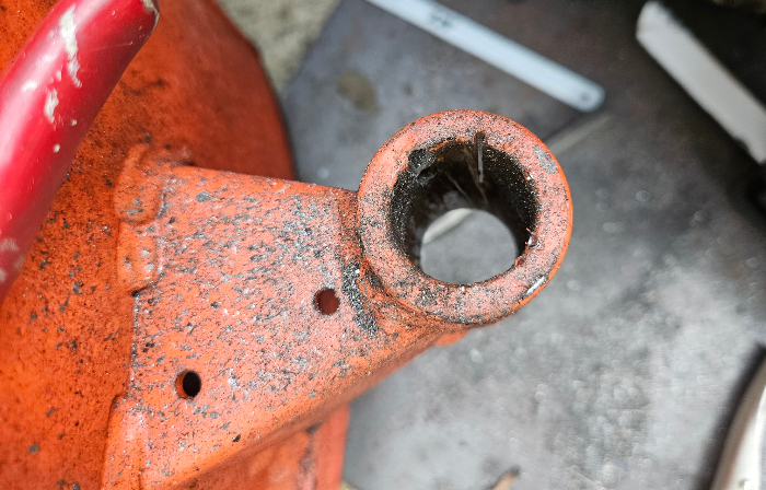

If you look at the photo, you may be able to see that the rust that welded the shaft to the deck is extremely thin. A film. It could develop in a season. It was unbelievably dumb for Kubota to make the fit so tight. There was no reason for it. The penetrating oil was all over it, but it didn't help one bit.
I cut into the deck tube a little, but it's nothing JB weld or something won't fix. Once I paint it, it will be fine.
The starboard tube was even worse. One of the horizontal adjustment pins was stuck in it. The natural things were to oil it, try to turn it with vise grips, and tap the inboard (small) end with a hammer. I got it to turn freely, but the hammer (mine or a previous owner's) mushroomed the small end of the pin. I decided to cut off the head and see if I could push it out backward, and it worked. After I ordered a slide hammer. Which I should keep anyway, because I don't have one.
I am now in the process of cutting the starboard bracket or ear or whatever off the deck. It is easier to weld it back on than it is to work on it while it's attached. I'm going to put it in my hydraulic press, and if that doesn't work, which I really doubt, I will find a way with the mill or lathe. If all else fails, I can buy a piece of steel, make my own tube, throw out the old one and the shaft, and weld the new one on.
Tomorrow, I should have the starboard shaft out OR I should confirm that it's useless to try, so I can get started on making a new one.
I really like Kubota, but every manufacturer has at least a couple of stupid engineers, and it looks like Kubota assigned theirs to anti-scalp wheels.
My yard hasn't been mowed in two weeks. I can't bear to use the John Deere again after using the Kubota. The new parts arrive Tuesday, so by Wednesday night, the yard should be back on its way to recovery.

I ordered front wheel assemblies. There may be some shaft fragments stuck in the front tubes, so I might have to fix that.
The front tubes would have been fine if they had been greased. They have zerks and journals.

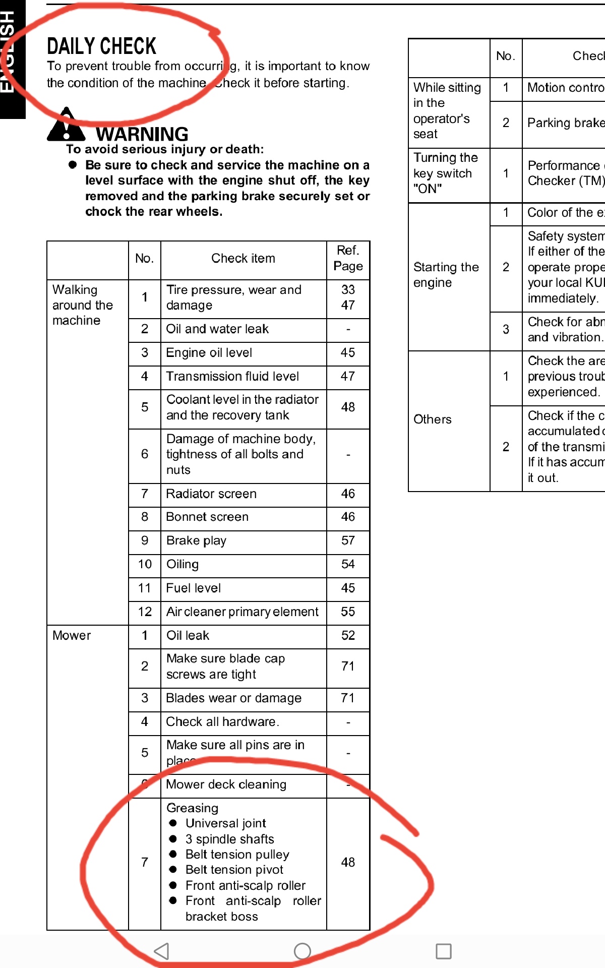

Has been mentioned already: what you encountered is absurdly incompetent operators.
I would suggest to consult the operator manual, section "maintenance".
I have the manual, and there is nothing in it about greasing or cleaning the rear shafts. You should have read it before commenting. The previous owner had no warning from Kubota about this problem.

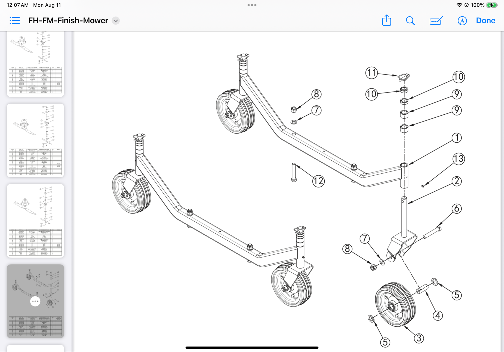

The front and rear wheels on my mower are very different, as you will see if you look at a parts manual. The front wheels swivel continuously and have zerks and journals for greasing to prevent wear (not galling, which should not happen in a moving part). The rear wheels never move except when the deck has to be removed from the mower or the height has to be changed. The bores have no zerks or journals, and grease isn't intended to prevent galling anyway. The correct substance is anti-seize, and in the case of the rear wheels, it would have to be applied manually due to the lack of movement, zerks, and journals.
For many pros, changing the height of the wheels might be a frequent procedure, but not so for homeowners or people who mow on flat ground, which includes a lot of America. Not so for pros during the down season. The rust film that locked my wheels was a couple of thousandths thick, at best, so it is obvious it could have occurred in one yearly layoff.
Removing the deck is rarely necessary for this mower because it has a maintenance jack built in, and the gearbox and the top of the deck are accessible through a hatch. That means it's not realistic to rely on deck removals to keep the wheels loose.
Compare all this aggravation to simply making the shafts slightly thinner, as other manufacturers have. It causes no problems, and it prevents galling. My old JD is 34 years old, has loose shafts, and doesn't have any shaft or deck damage because of it. Its shafts require no greasing. There are no zerks. Kubota could have done the same thing, and given that its competition was doing it in 1984 and possibly earlier, failing to do so in a very expensive 21st-century mower is inexcusable.

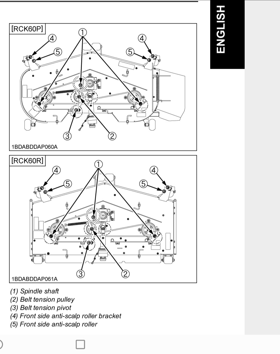

I see you are currently discussing the rear anti scalp wheels versus the front anti-scalp wheels. The non-mention of the rear in the service manual is not an engineering error,
The wheels in question are referred to as "front anti scalp roller" in the manual. The rear wheels are the wide cylindrical ones that are maintenance free.
So the greasing is included in the manual. As I would expect it from a Japanese company with top class engineers.
6,469
2,093
I think you may be mistaken, but it certainly could be me that is incorrect on what he is discussing!
But somewhere in post #1 he stated:
“I eventually realized I needed to change the height of the rear wheels. They were a little stiff, however. As in frozen in place. The shafts were stuck to the upright tubes.”
That statement lead me to focus on rears, even if he starts off discussing the front wheels.
I think he may have the RCK60P style deck in your diagram. I think you are referring to the RCK60R rear wheels as “maintenance free”? I agree with you that those should not be rusted on the rear.
Yes, you are right, I missed that.
Nevertheless your statement is very valid that any person reading the manual should have deducted that those wheels require greasing too, even if it is missing in the manual. So clearly lack of maintenance.
