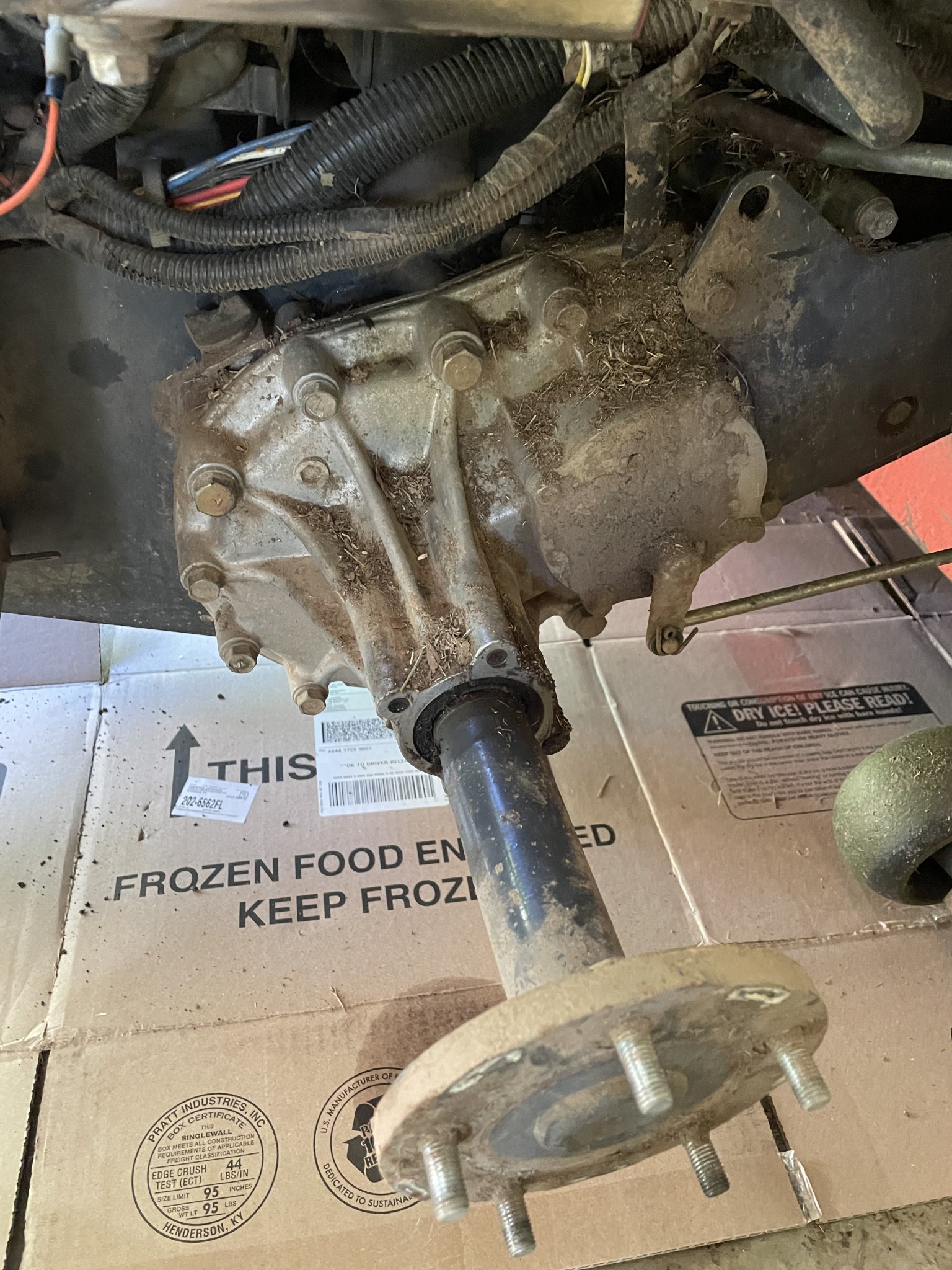

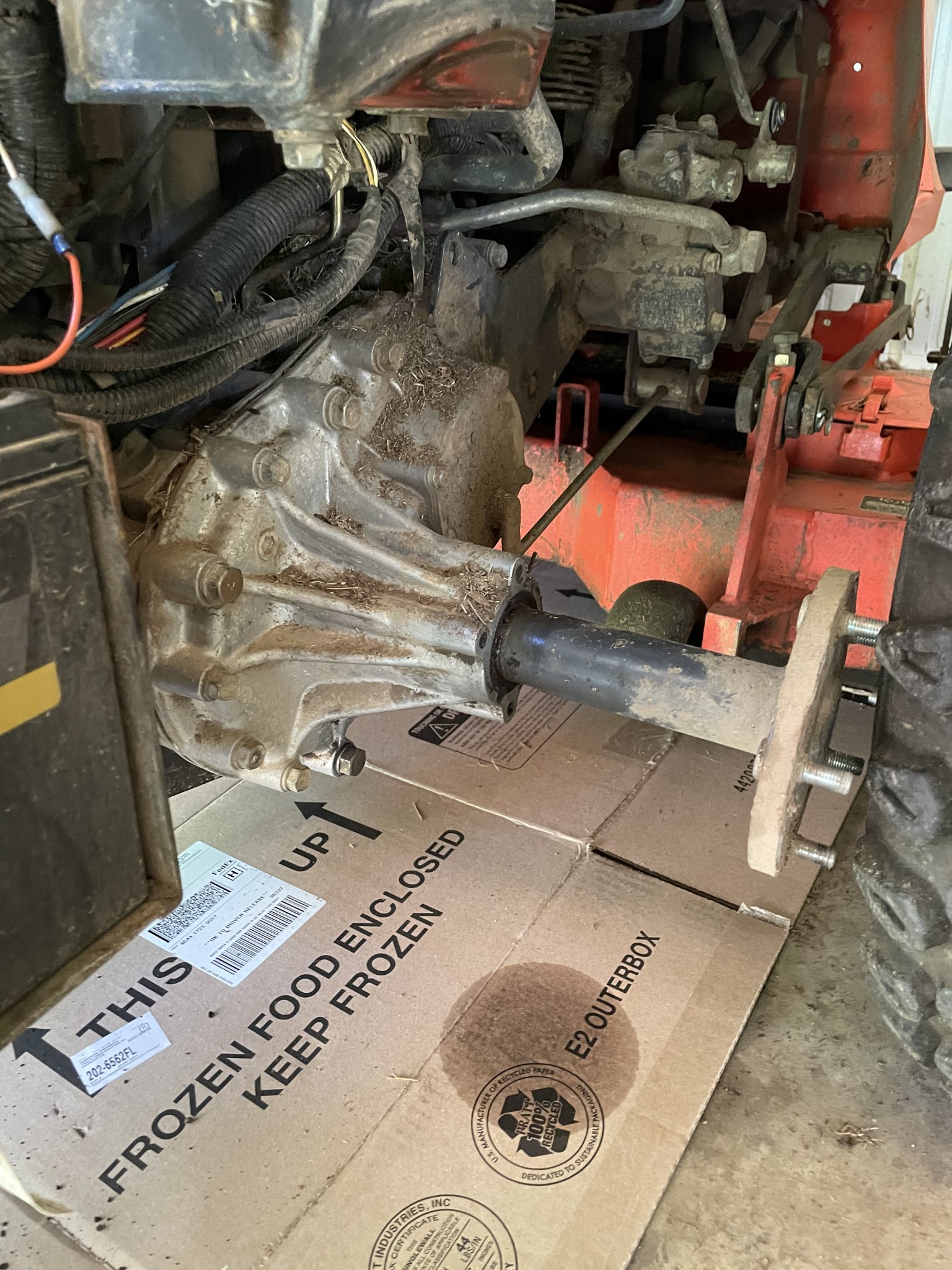

Thank you for your replys. I’ve attached photos as requested, but I don’t believe I’ve dug into the mower enough to be any help.

Drain the oil from your final drive into a clean container to check for metal shavings or chunks.

Is the final drive the one inside the rear axle case? i will look at the workshop manual. Yesterday I checked the fluid level there an it was hard to see, so I decided to check the left side level. The dipstick is wedged between the engine and fuel tank And I dont a
have a tool that is long enough and has a grip at the end.

Yes thats the case that the axle comes out of. Look at the far rear lower corner for the drain. Look at the rear upper side for the fill and dipstick (all in one). I use a suction gun to fill it. (Looks like a grease gun but has a hose on it about 1/2” diameter)
Its not too bad to check the level but about impossible to get a funnel into to refill, which is why I use the suction gun, and thats even somewhat messy.
