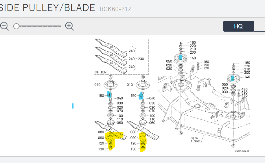

I'm seeing two options:
Most common is that the two washers (yellow) are damaged missing or improperly installed.
Second would be the key (blue) is sheared and and the spindle is slipping inside the pulley.

On my ZD thats happened occasionally, and its always been the cup washers. Perhaps you didn’t tighten the bolts enough the last time you changed blades? Or if they’re tight, its time for new washers.

yup damaged, misplaced, or missing "spring corns" or loose bolt are usually what I see on that style.
spring corns...for a good while kubota called blade washers "spring corn". Jinglish I guess. Dunno.
kind of an overcomplicated way to hold mower blades on but I guess their enginerds have it all figured out. Problem is, when an owner goes to change or sharpen blades, all those parts scatter and with it's overcomplexity, makes it a little harder to figure out how they go. I've seen them missing, washers on top, one on top one on bottom, missing "boss spline", etc. They will all go on in different ways but there is only one correct way. Review the parts diagrams for your equipment (specifically your mower deck, as you will not find blades and hardware in "ZD21", but you will find it in RCK60P-21Z).
good luck.
Oh by the way, 30mm socket....

I have had this happen on my ZD 323 when using non OEM blades.
For example, Oregon G-5 blades are thinner then the OEM blades and the clamping force of the cupped washers is reduced. The bolt will torque to the correct value. The fix is make sure blades are the same thickness as OEM blades.
