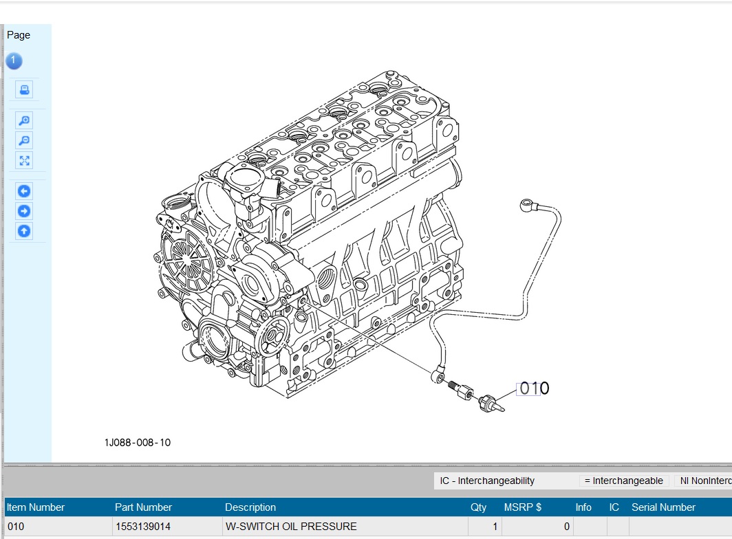

Looking on Kubota.ca web site I see the following for the oil switch
Messicks web site
Messicks
and Coleman's web site will have same info.
After entering model, look in engine section for oil switch.
