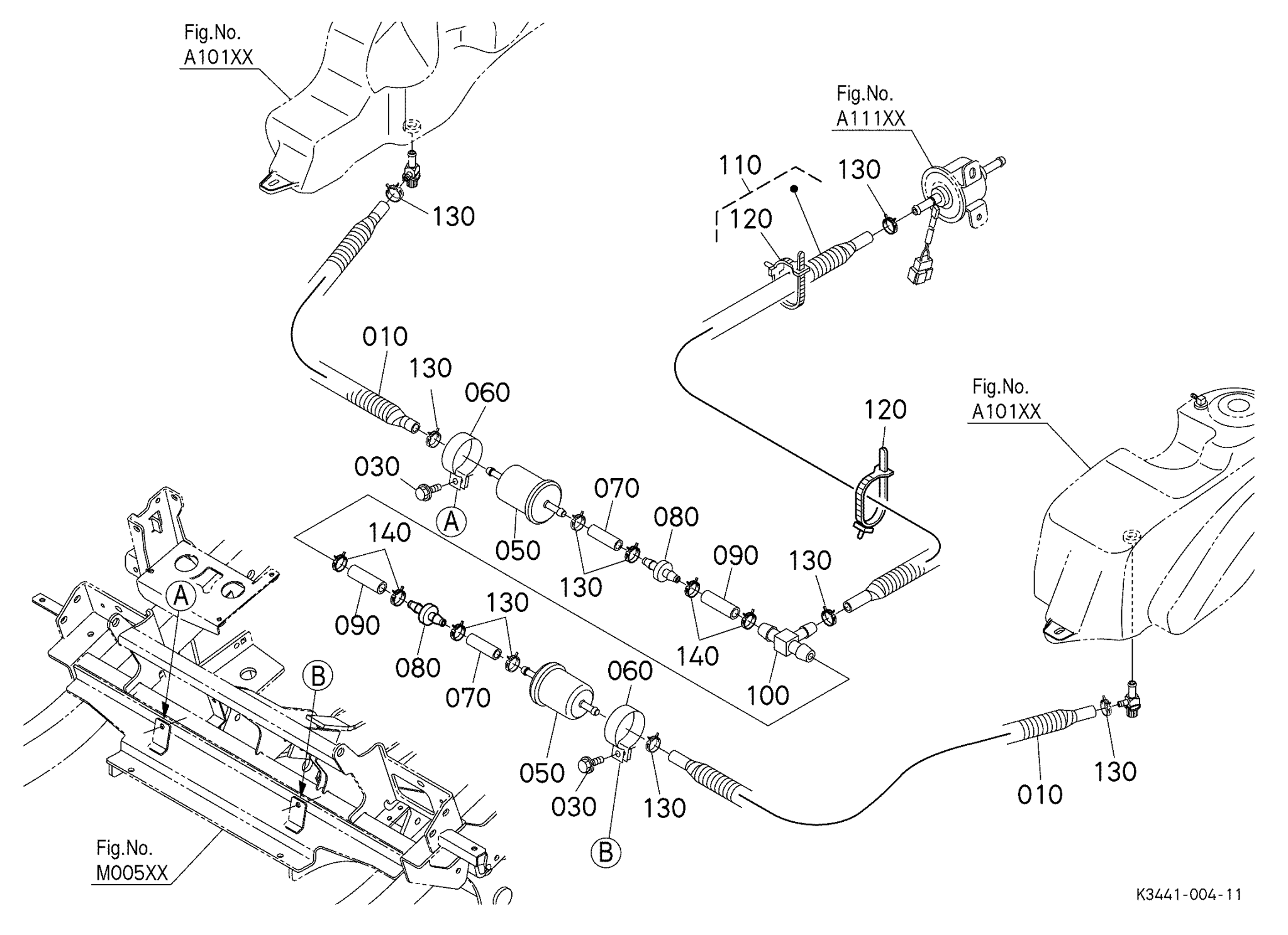

12,828
5,596
if this is what you have...
then running on a slope will drain the high side tank and engine will stop unless there's a lot of fuel in the low side tank to get fuel passed the tee fitting (#100). #080 are check valves.
test for this is run on level ground. can you do that 'forever' ?
