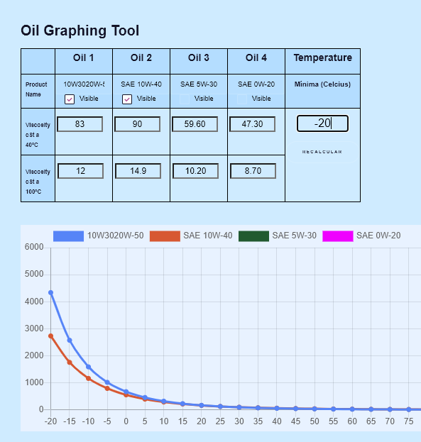

Plot the actual viscosity curves for 10W30 and 5W40. You might find it revealing.
Grade 5W40 covers the extremes of all of Kubota's viscosity recommendations including "all-season" 10W30 in a single oil and does it better.

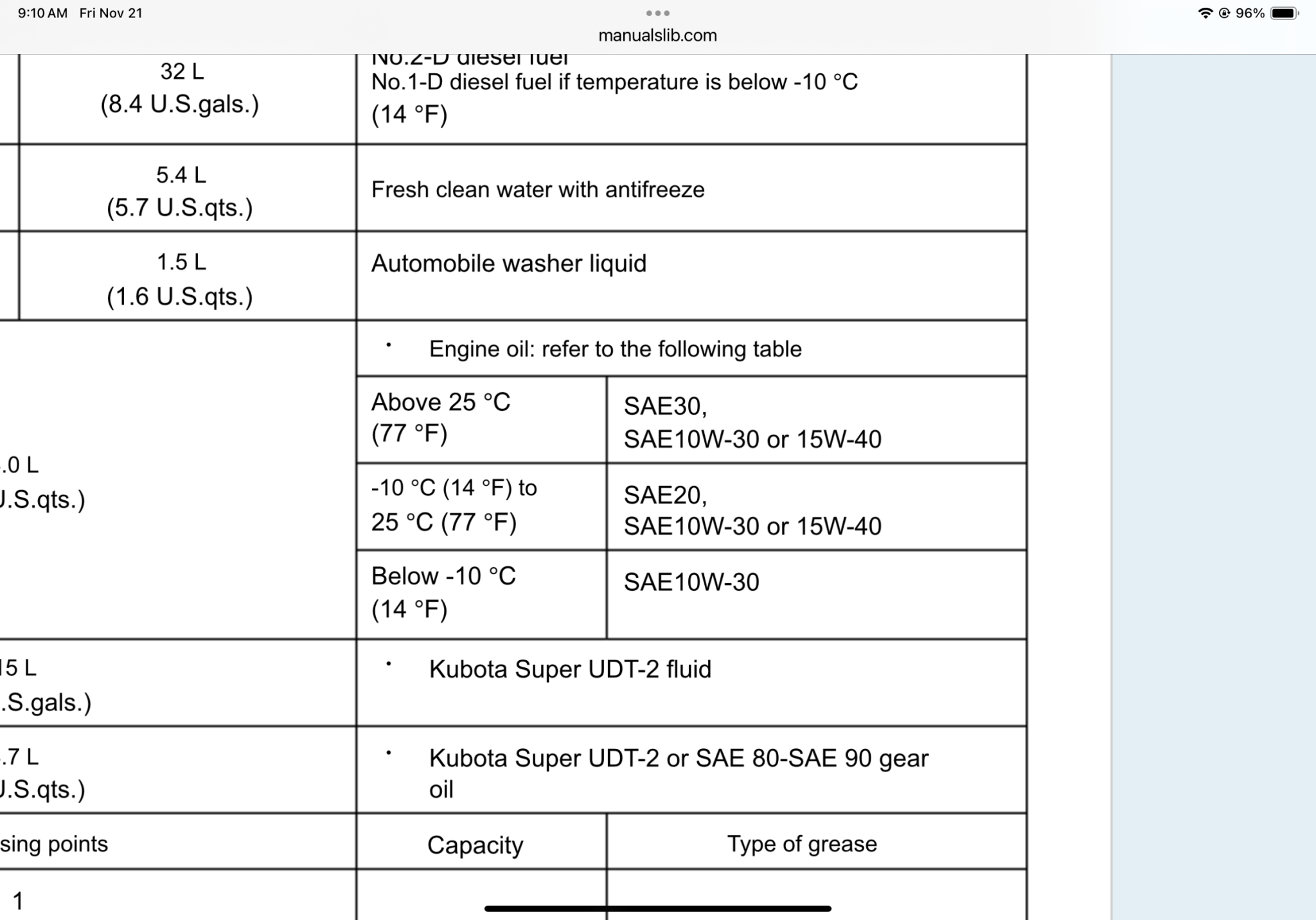

Yeah Yeah Yeah. WE ALL know that. But if YOU have a NEW TRACTOR….with a Warranty….WHY would you try to “outsmart” the OEM and give ANY excuse for them to deny?
GM had a series of autos in the mid-80‘s in which the Owners Manual specified 10W30 and when clever owners substituted what THEY thought was equal-to-or-superior…. they discovered the engine damage was Denied Warranty.
Just sayin’…. if it’s YOUR machine…. YOU get to choose…. but getting on a internet forum to accept some anonymous ”username” s advice as … equal-or-better ….is foolish when the OM directly specifies something else, IMO.

Just more FUD and the graph speaks for itself. Rotella T6 0W40 is nearly identical to Rotella T6 10w30 and a perfectly fine alternative with a bit higher viscosity @100C and significantly lower below freezing. Nobody is ever going to claim it voids a warranty..
Kubota's listed viscosity grades are a guideline based on ambients not a requirement. The warranty requirenent is for a heavy duty diesel engine oil conforming to API CK4 specifications.
