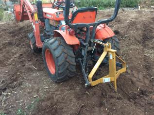

Construction traffic likely compacted the soil. I would run a subsoiler first then work the surface to be loose and level before planting.
Plus one on that. Especially if you have any clay in your soil. More than one way to go for the rest of the job but make sure you have good drainage to start with.
