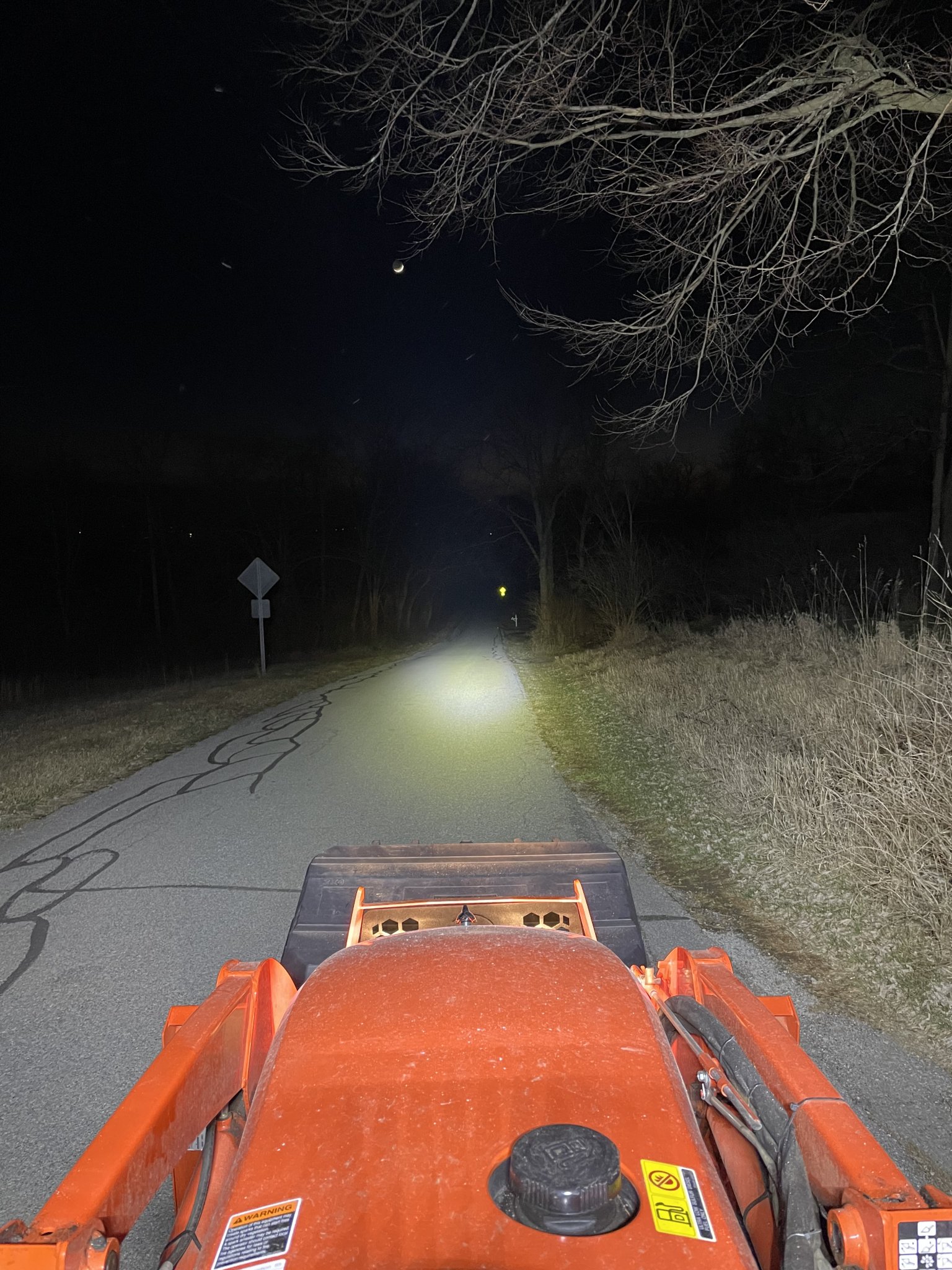

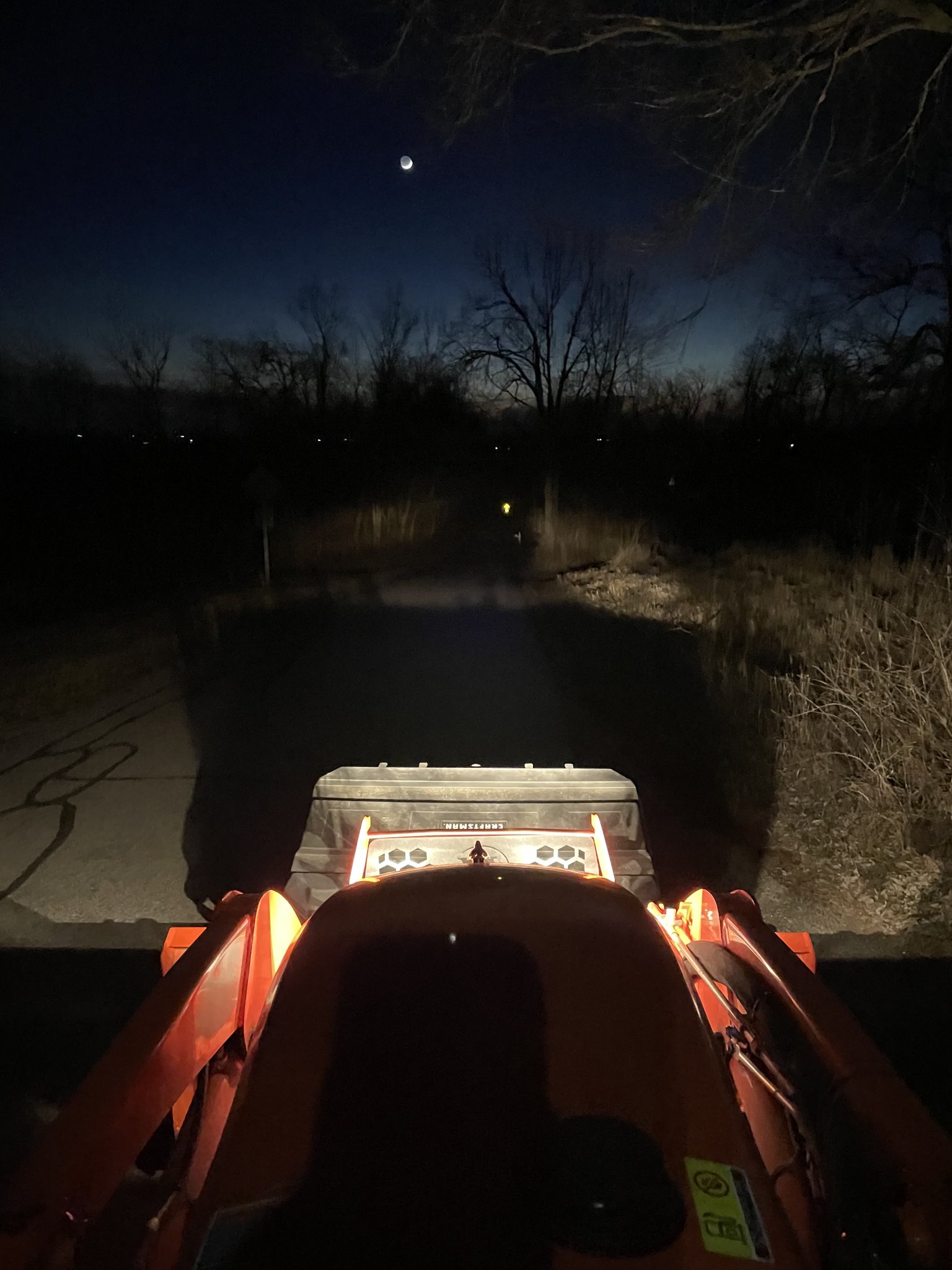

For my B, I added the magnetic light bar from Tractor Mikes that plugs into the cigarette lighter…and damn, it’s bright.
They are almost too bright actually that my eyes can’t adjust quickly when I need to back up. Ive purchased some cubes for reverse but have not installed yet. But as is I can mow the yard after dark…it’s not common but I’ve done it several times.
not really cheap, but the install could not have been simpler.
Here is before and after…
