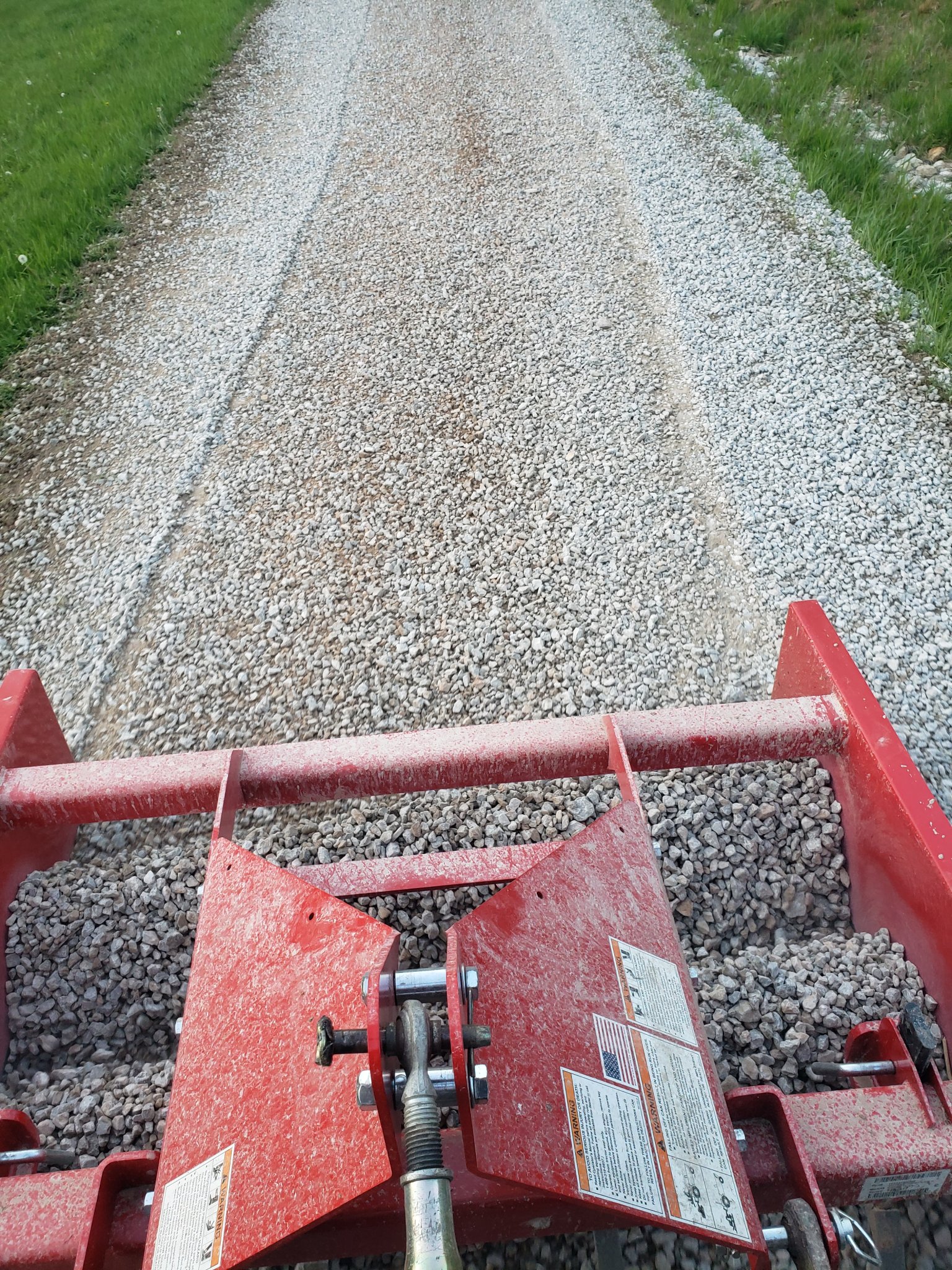

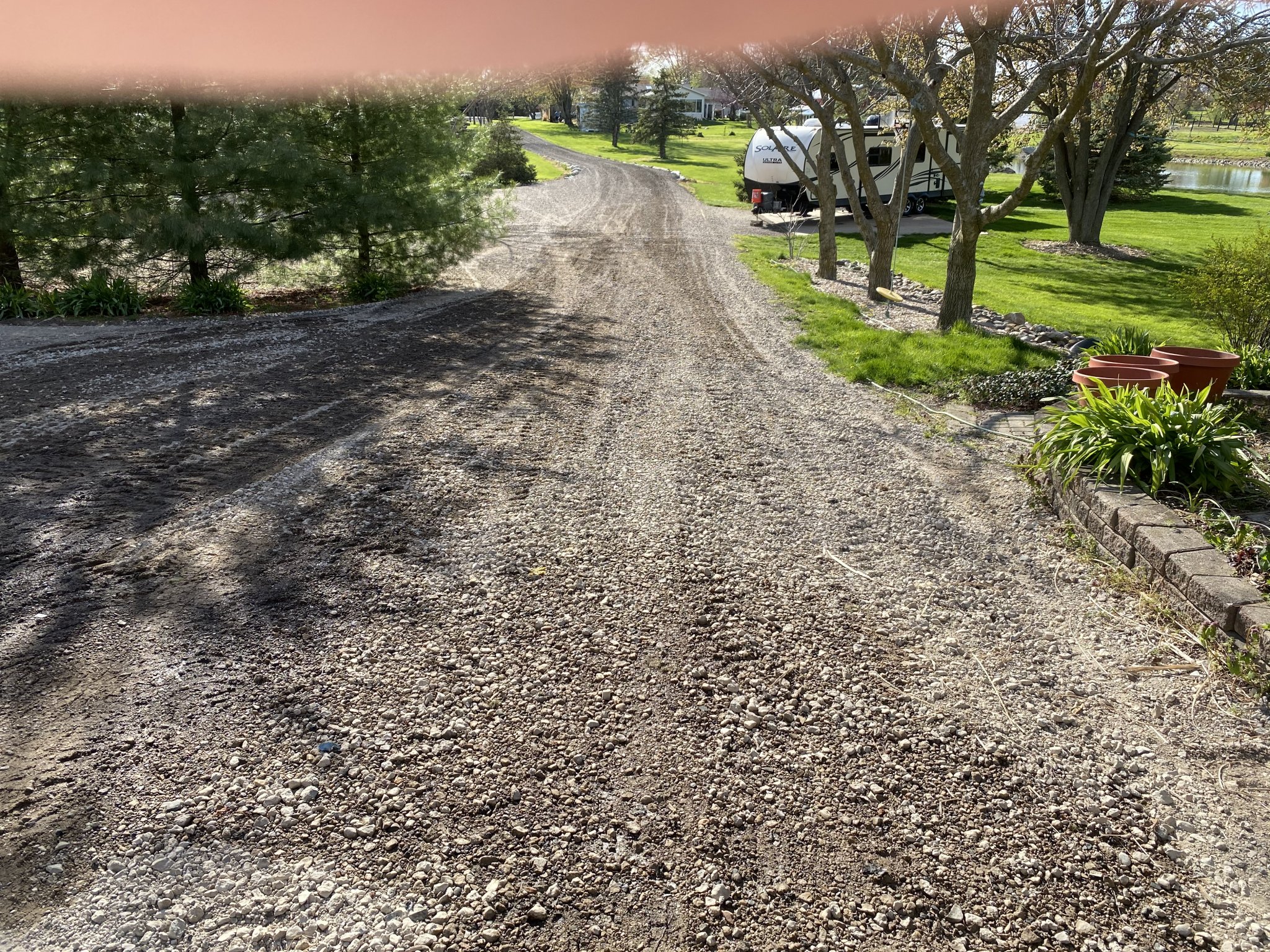

I just put my parking area back together today and took a couple passes down the drive before applying some dust control
Another thing you need if you want the land plane to work well is material. If you dont have material spilling over the blade, you are wasting time and simply moving material from one place to another.

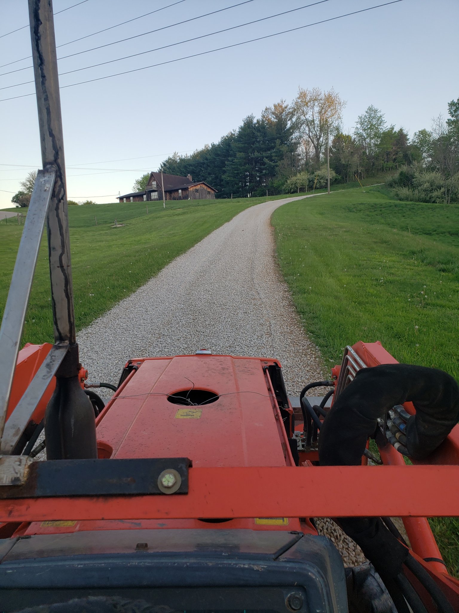

As you can see i got a pretty good size hill on the front part of the driveway. Feel like i got most of the washboard cut out of it. Made 6 or 7 passes up with the blades below the sides shoes then set it back down level with the sides to try and finish it. Is it better to start at the bottom and pull up both side as to try to bring material up the hill rather than pull it all down? Also as you can see, will there always be side shoe marks in it when finishing. I tried adjusting the top link to where it tilted the box back but it still was leaving the marks when it was all the way down. If i floated it up a little bit they went away.

My first thought is its because you're running down the center of your drive. There is normally a crown there and the plane will build a crown simply by the nature of the angle of the blades.
Looks like what happening is material is building up in front of the first blade faster than it can spill over and its spilling out the sides. My suggestion would be to run either side of the drive and dont run down the center.
You can also lengthen the top link a little more so material isn't building up in front of the first blade so fast.
