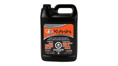

I recently flushed and changed the coolant in my L3940 and used the pre-mix Kubota coolant. I'm assuming it has the additives already added.
Kubota makes an ELC or extended lift coolant. If that's what you used, and you change it at least every two years as the manual states, you should have nothing to worry about. It's the lack of maintenance that causes issues more than anything. Clean the radiator regularly, make sure the radiator is full, and replace the coolant at least every two years and you'll most likely never have an overheating issue that some seem to experience here.

Thanks for the comments. I did use the Kubota ELC 50/50 prediluted coolant. I think I'll skip the addition of the SCA and just go with coolant only.
