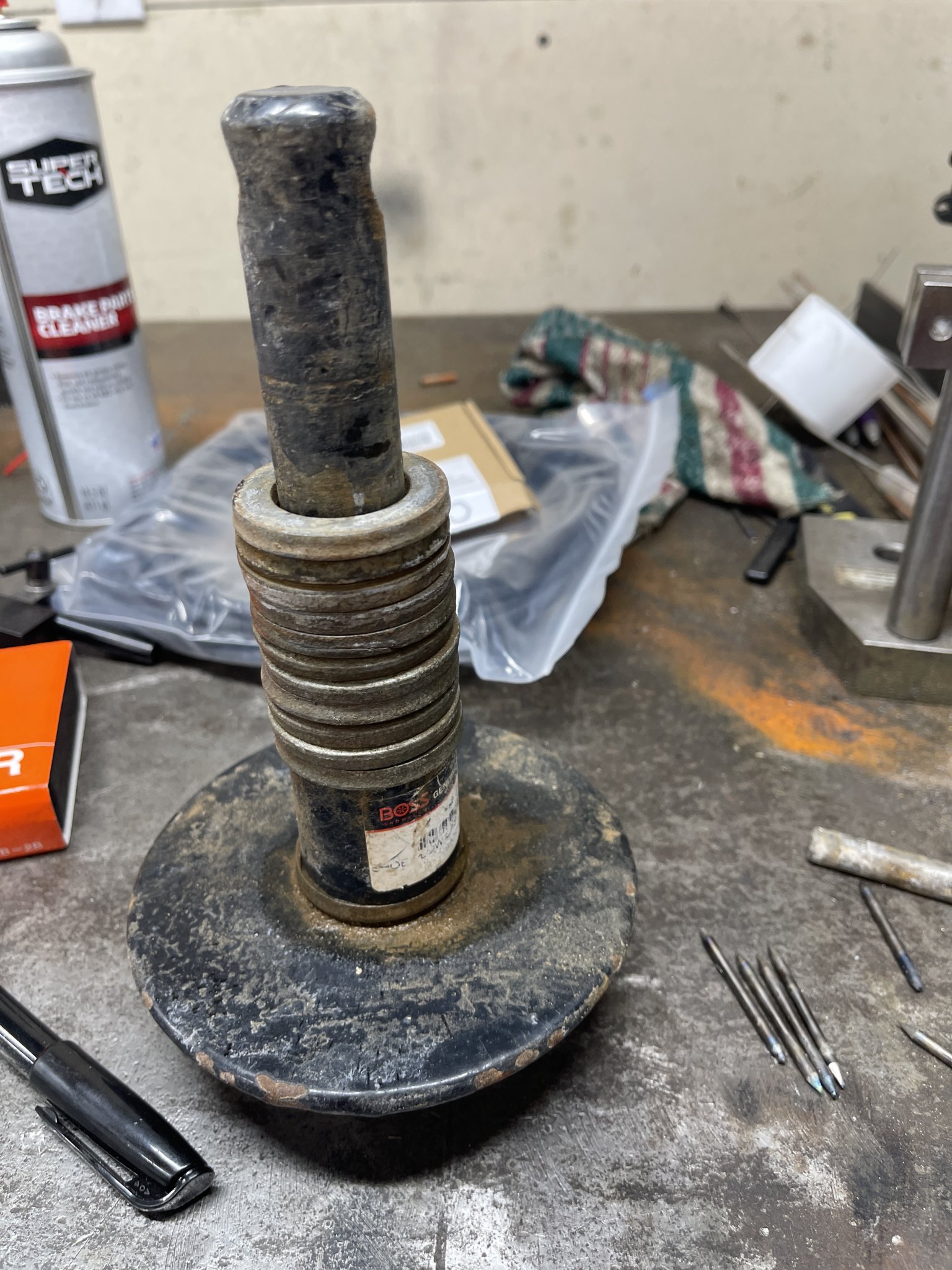

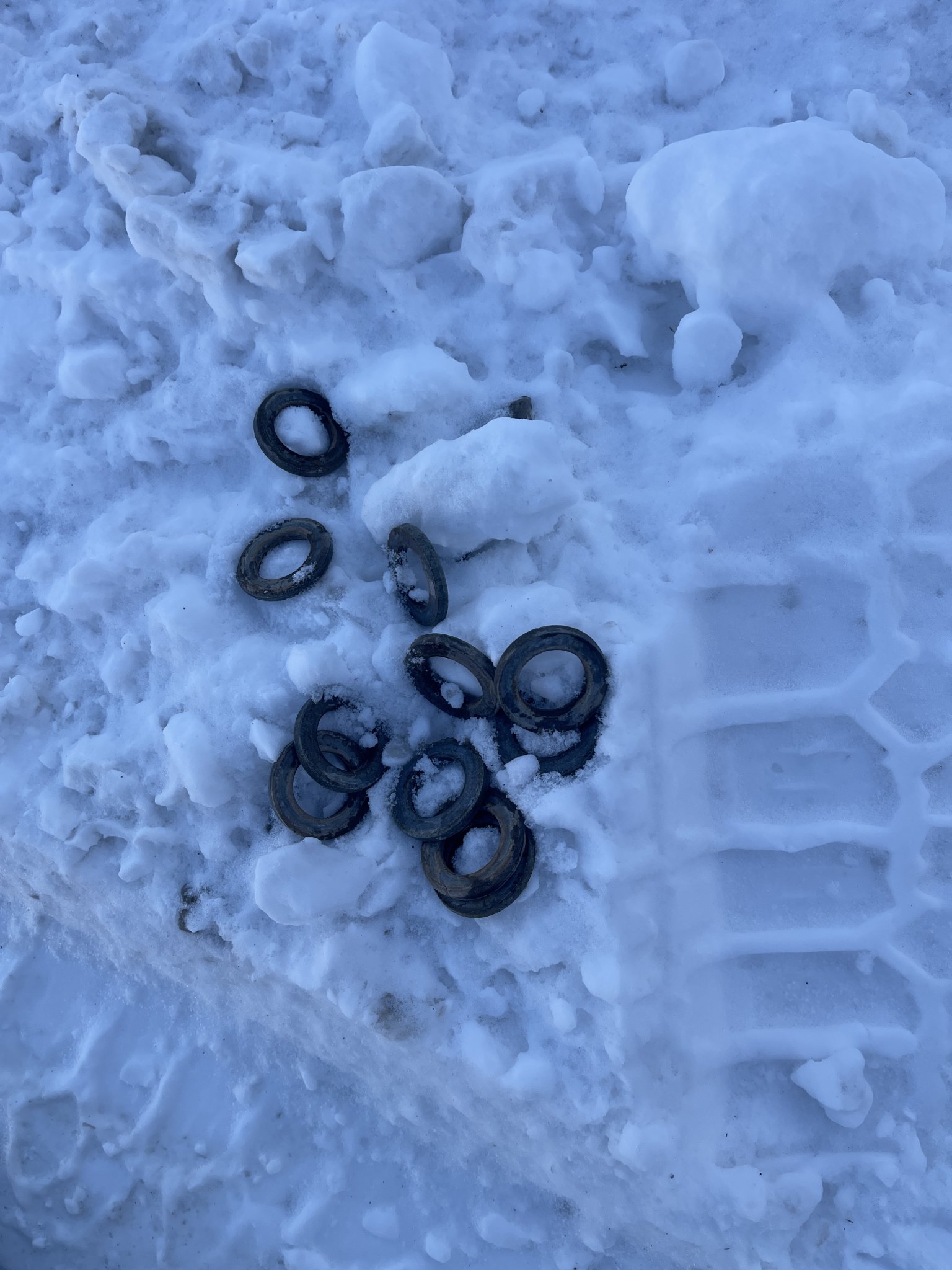

So there I am plowing out the kids, and I have to remove the “gravel shoes” for the plow….
Its set up like this…..
Well for the 323,597th time the M_^%%%#$#@g stack of washers they gave me as “spacers” winds up like so…..
It’s 300 degrees below zero, I cant find my gloves so my fingers feel like frozen fish sticks……. so like Popeye says….."I’ve had all I can stands, I can’t stands no more!!!!!"
I’m making “custom spacers” damn it.

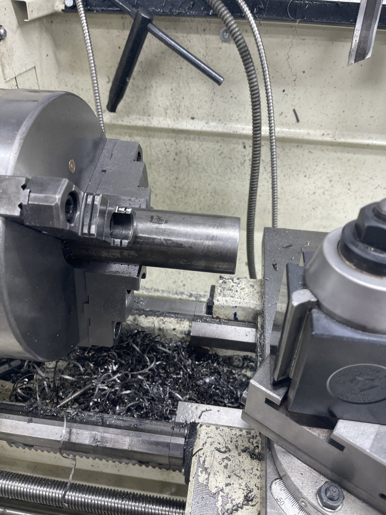

I sure wish this bar was a little longer, but sometimes you gotta do, what you gotta do…...
Off to the lathe Gentelmen!!!!!!!!!

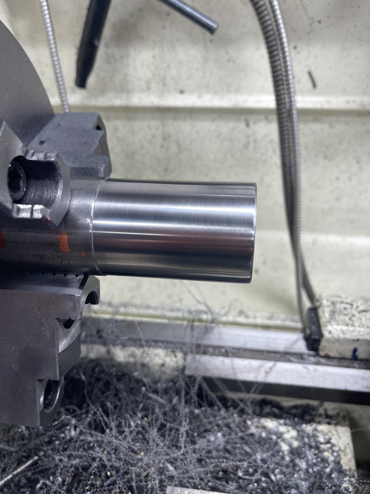

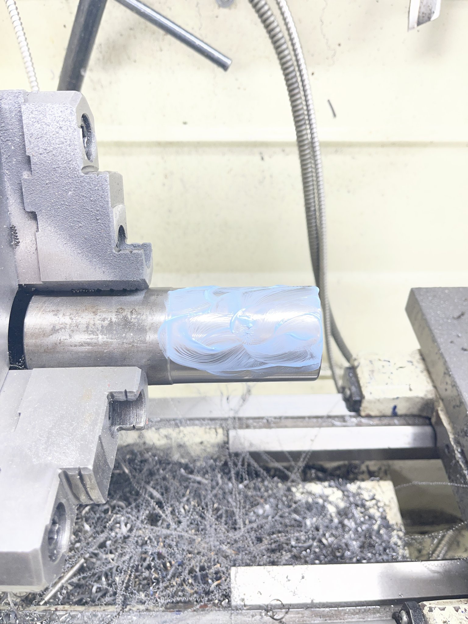

This must have been “chopped off” with some sort of bigass machine, so I will clean it up (mostly)

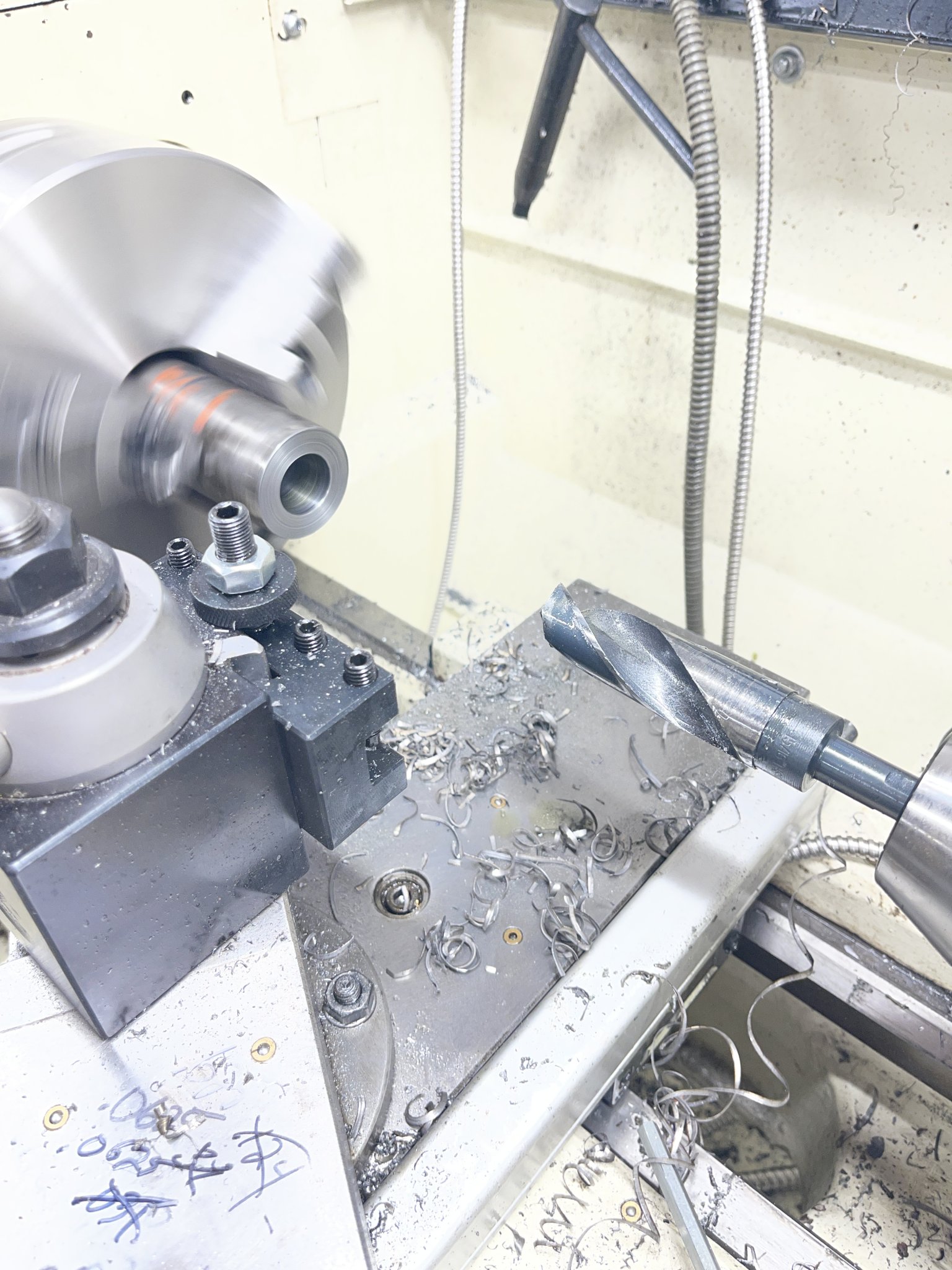

So according to Mr. Pie, the secret is to drill a small’ish hole, then bore it straight THEN ream it, then start stepping up in drill sizes to the finished diameter.
Well………... thats what I remember anywho , so lets try it.

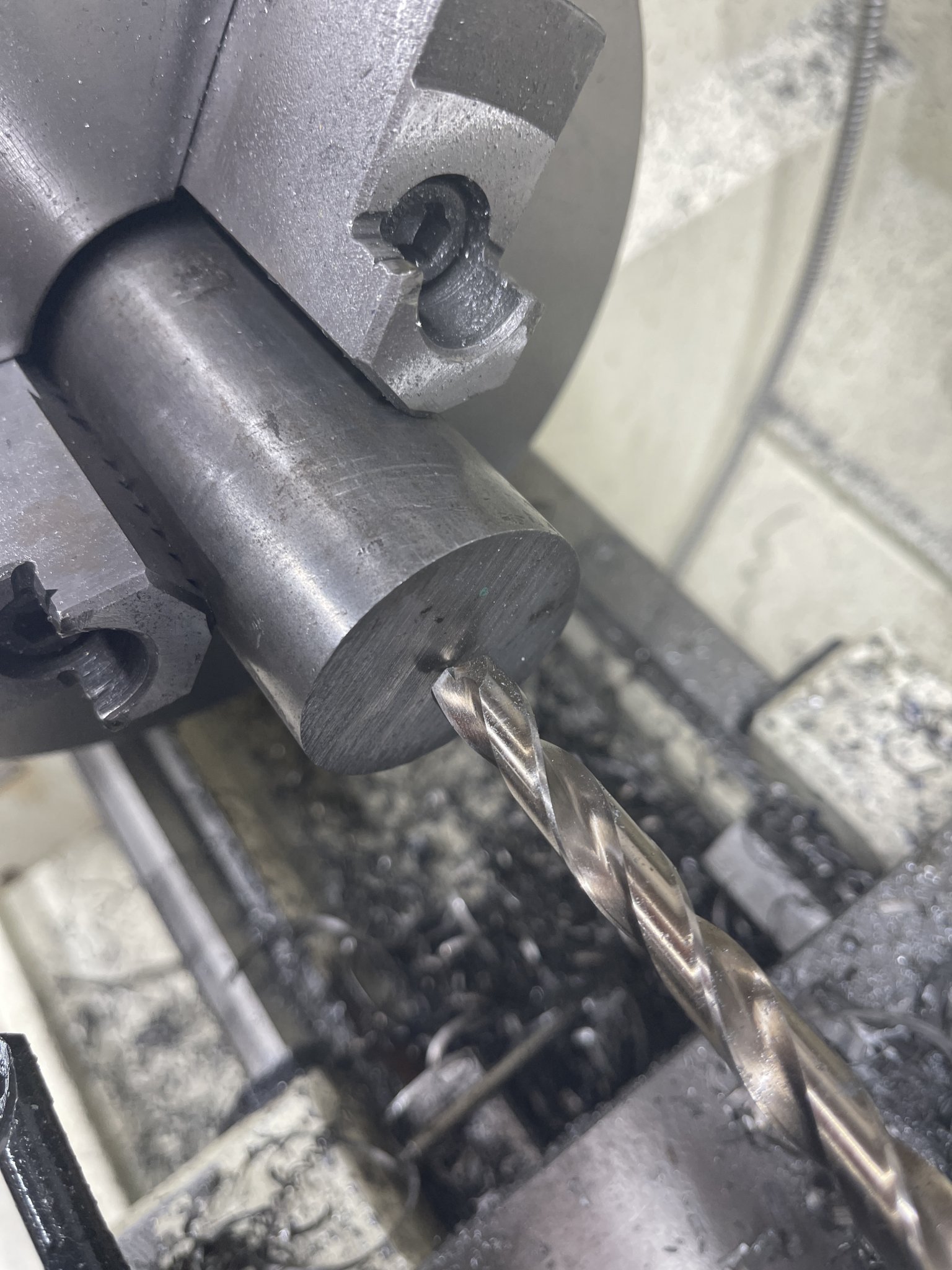

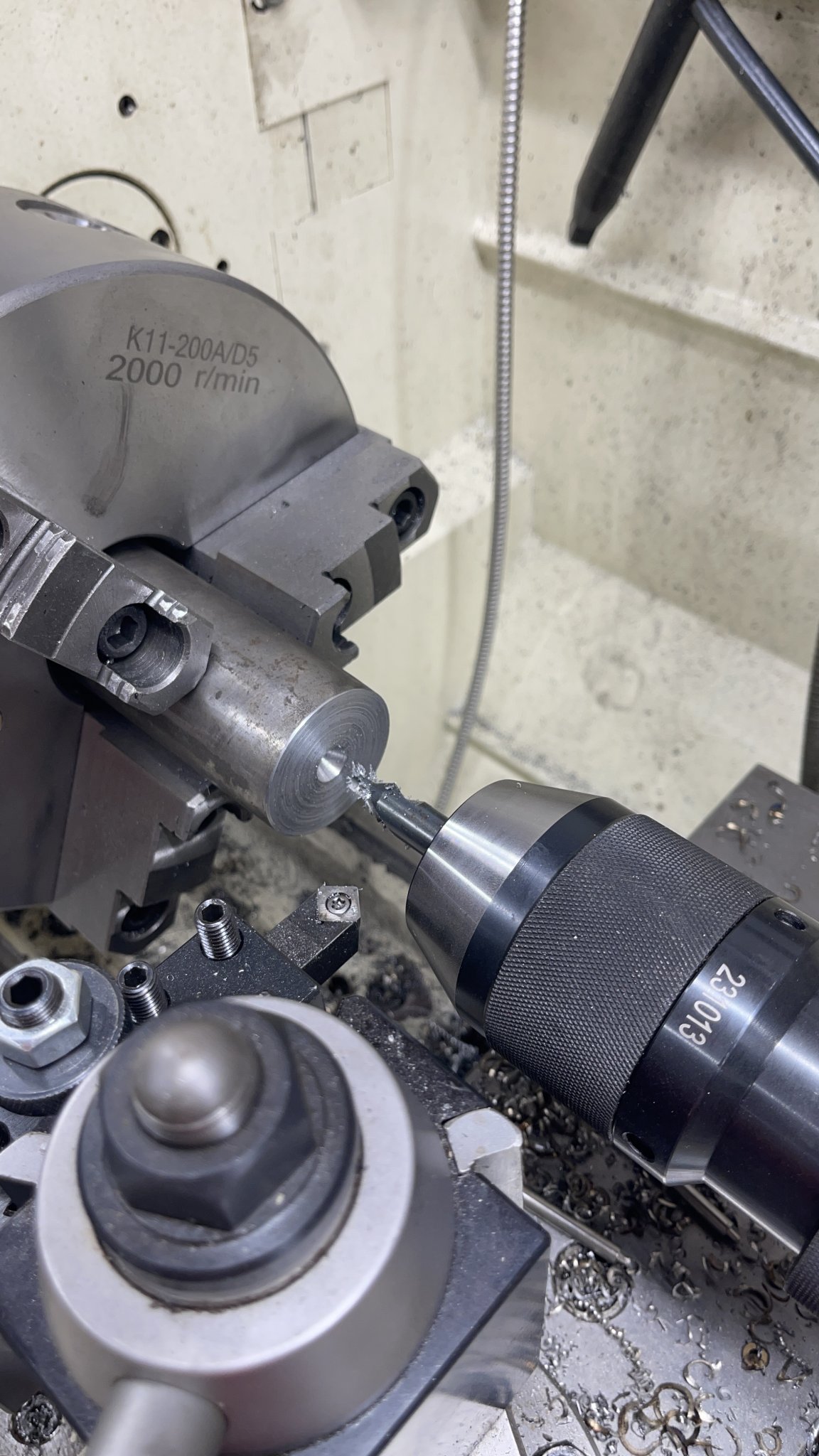

I face it off, then spot drill it...

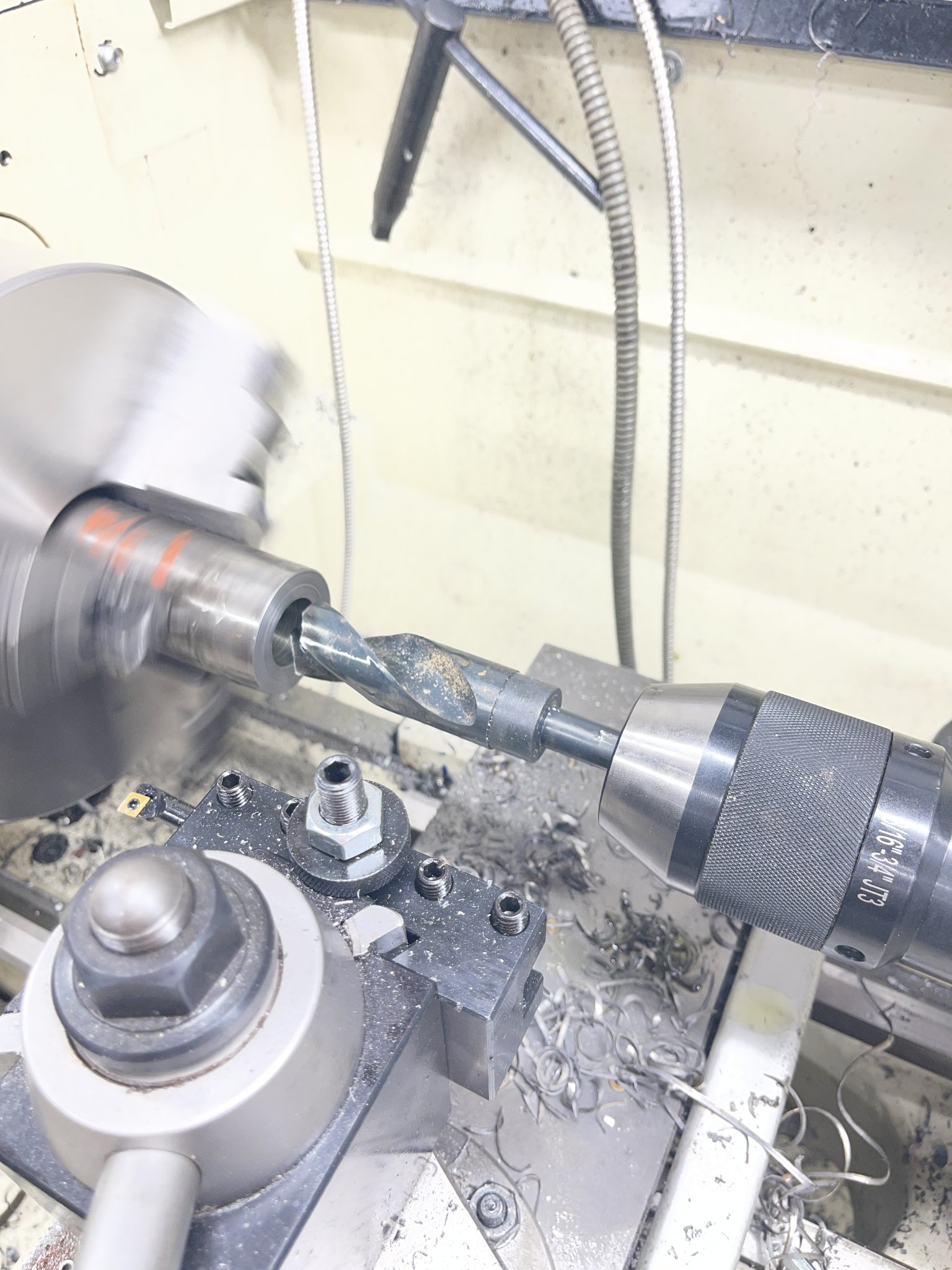

Now I drill it with a regular drill bit, then I go up a few sizes until I can get a boring bar in there.

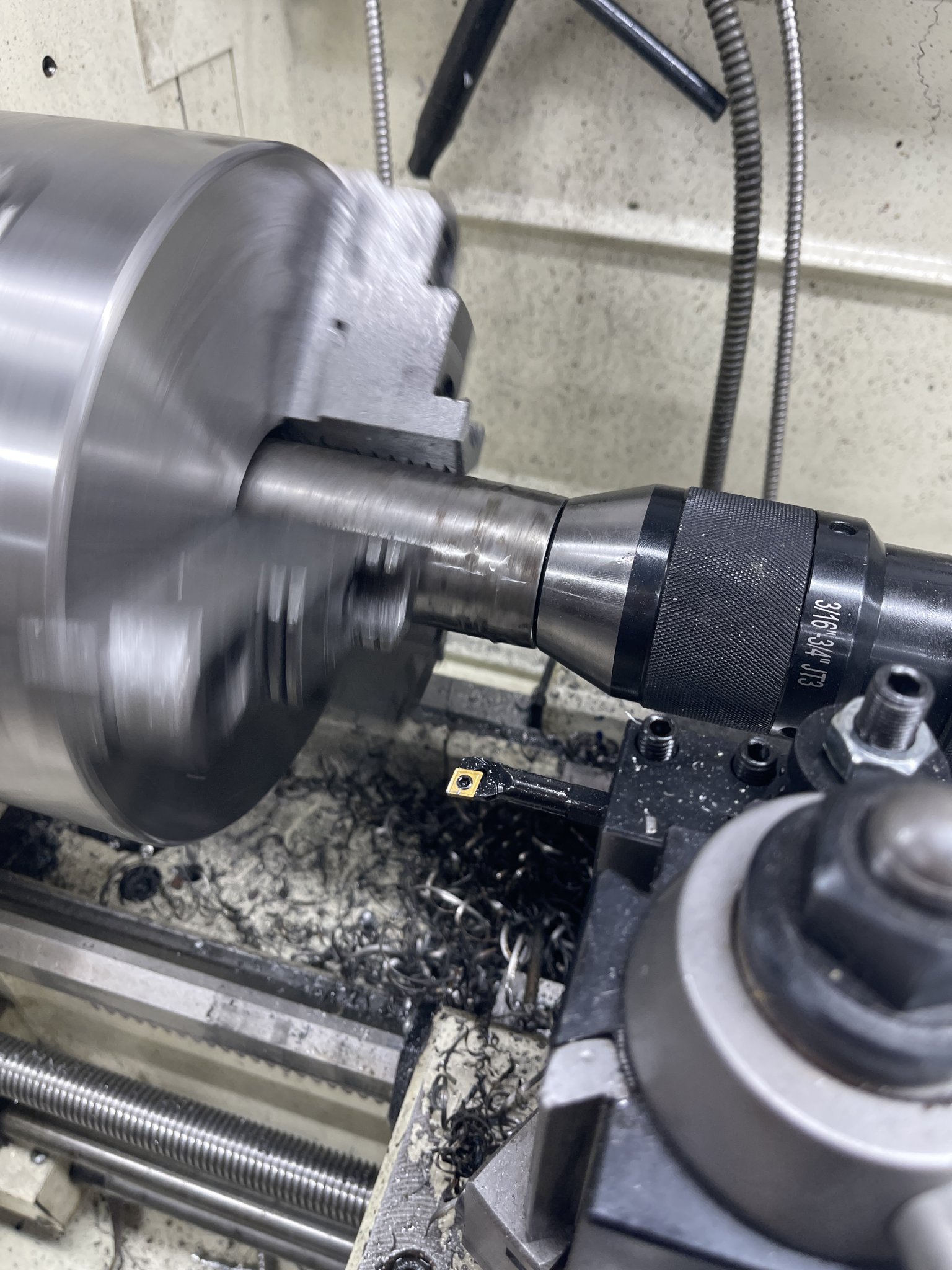

Now to start stepping up the bit sizes.
It’s a bit of a long process, and it takes lots of cutting fluid…...
I go all the way up to 1 inch.
I got that bad boy “F’ING BURIED” in this hole.
I have never drilled such a big hole so deep before.

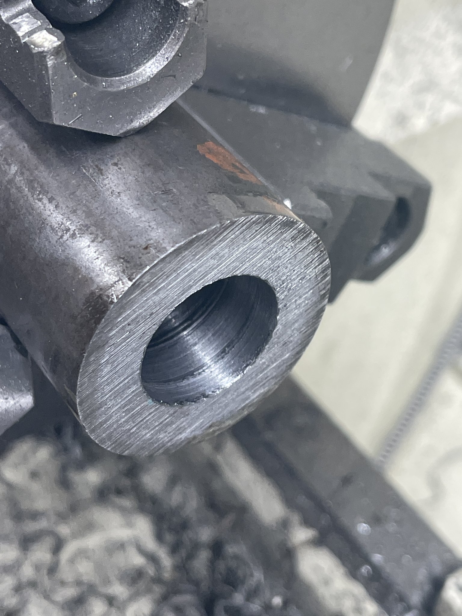

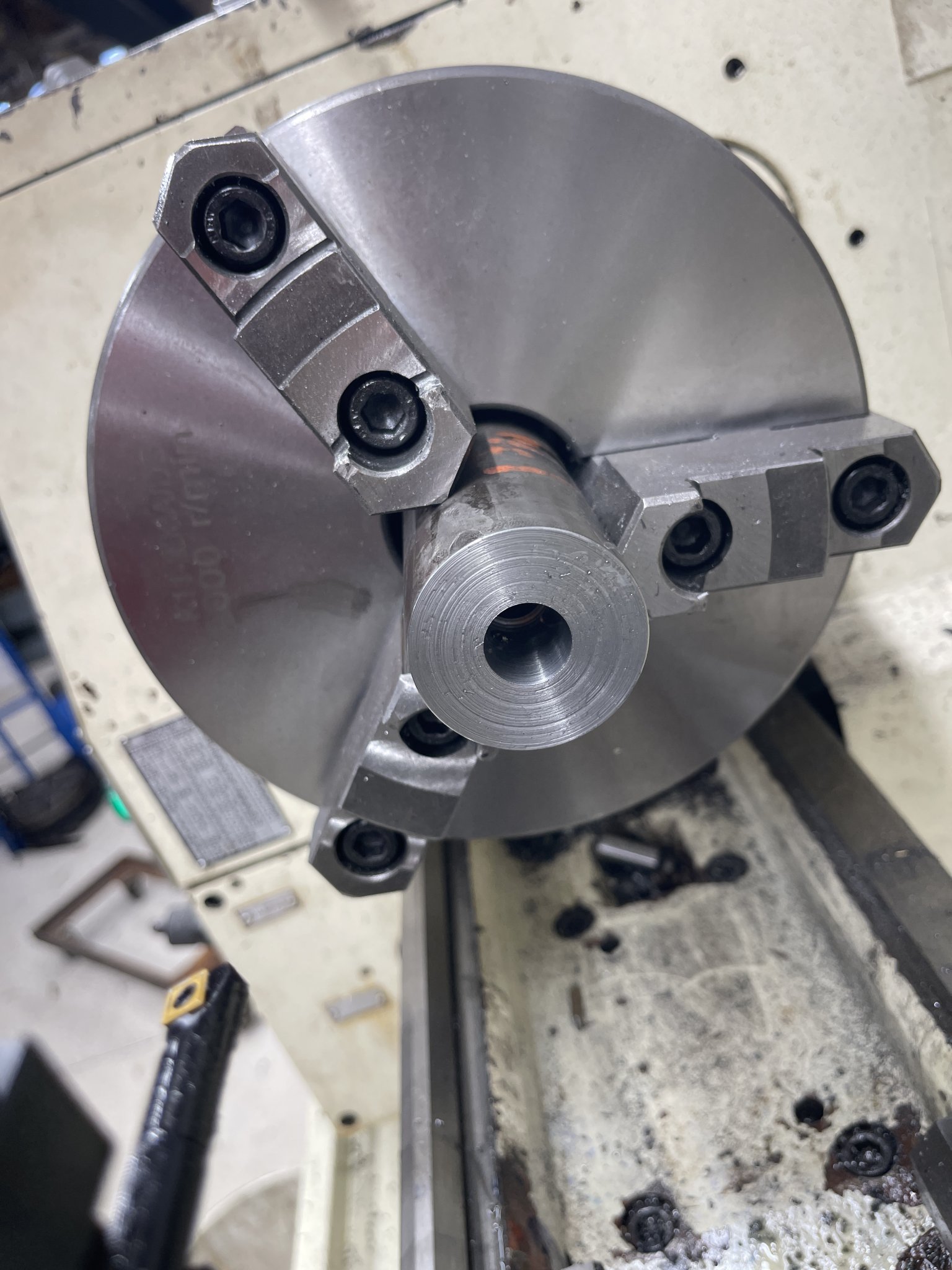

I chuck it up backwards, and begin opening it up.
And here is the 1 incher……….it’s probably not “absolutely perfect”, but I’m pretty happy with it...

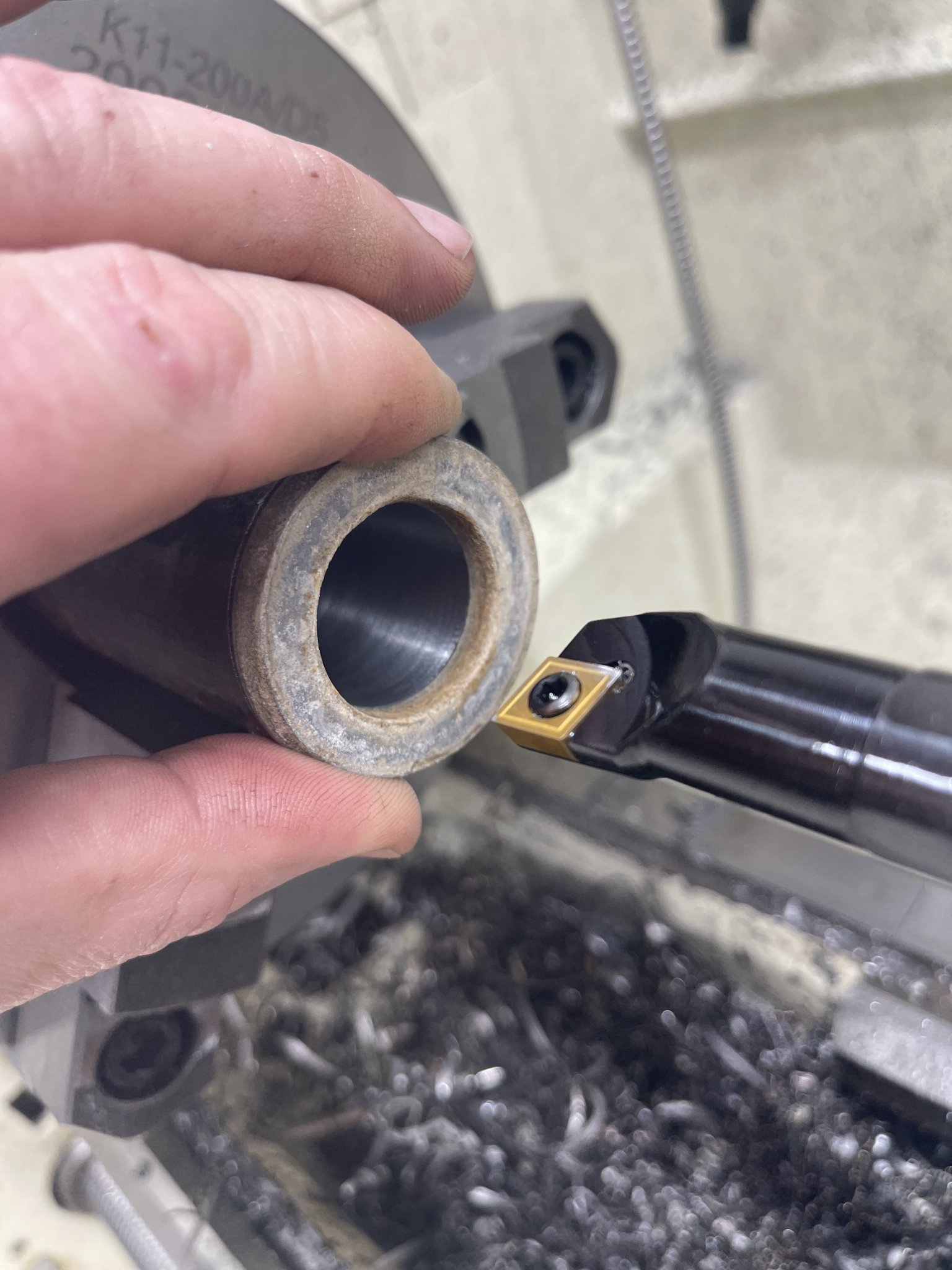

Next I rig up my “Biggest boring bar” ………….It’s pretty long, so I make lots of passes and bore it out another .058 inchs.

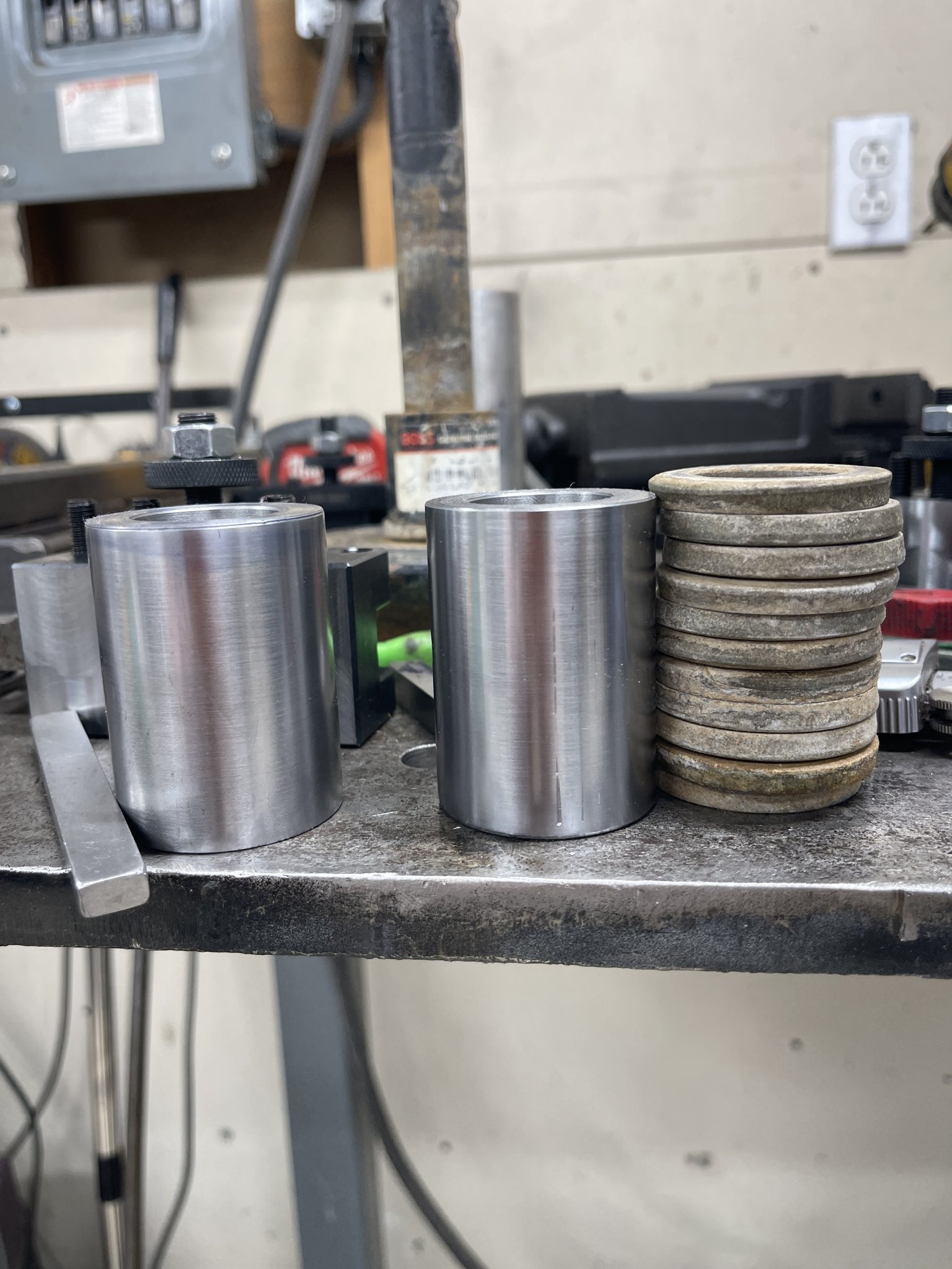

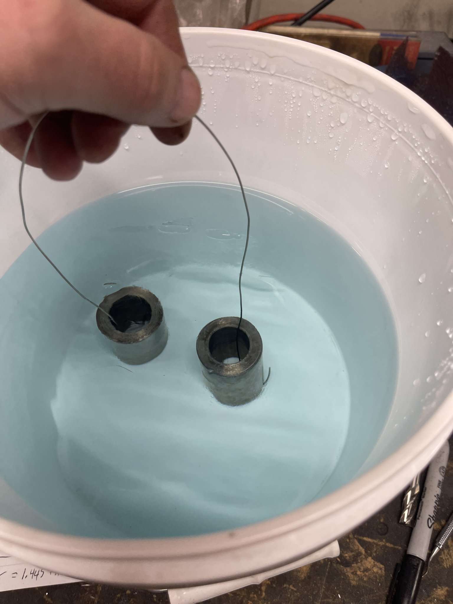

Now I am “proud as punch”, so I decide to “spiff it up”…..for absolutly NO GOOD REASON AT ALL"
I ended up turning the OD and ‘went stupid” with the emery cloth and polish.
I’m pretty happy with them,
so it’s off to the “black oxide” bath…..LOL
They are drying as of this posting……..
The End……………….
