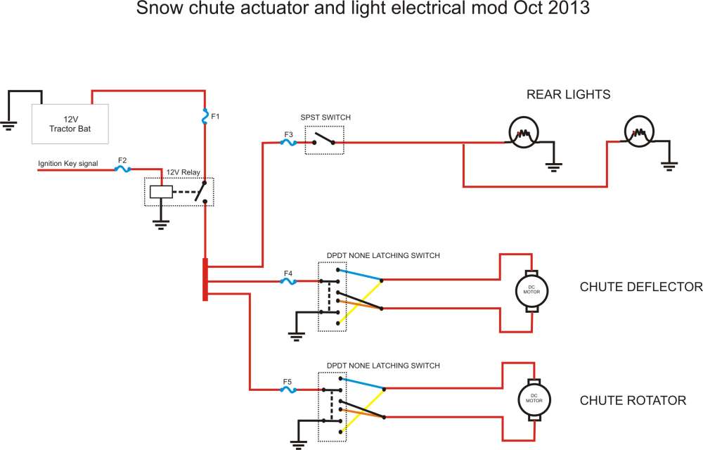

Hi Greg, here is what I did on my BX2370, works great. See a few more pics here. As stated above, it is crucial that the case of the motors be isolated from the elec connections.
Cheers
Rob

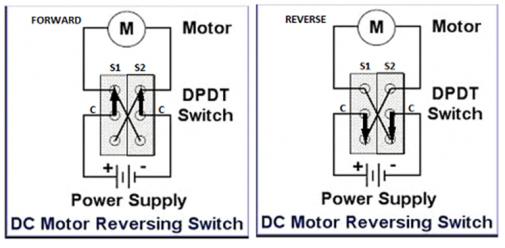

A Double Pole Double Throw(DPDT) is essentially two separate switches ganged together to be operated by the same mechanical actuator. In the drawing S1 and S2 are not electrically connected together.

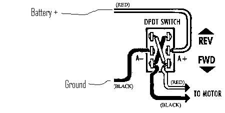

Your drawing actually makes more sense I thought you always supplied the center (neutral position) of a switch with the input power but the wires that run from corner to corner were not that clear. Thanks for the diagram i actually see now how that makes it change.
36,828
11,516
just like Kennys drawing but in living color.lol
Learned something new today. thanks
Now the question is what type of motors will run either direction.
Just about any DC motor will run both directions.
Window motors are some of the best to use, the key reason for using a window motor is that they already have the gear reduction built in, gives you power and slow spin.
