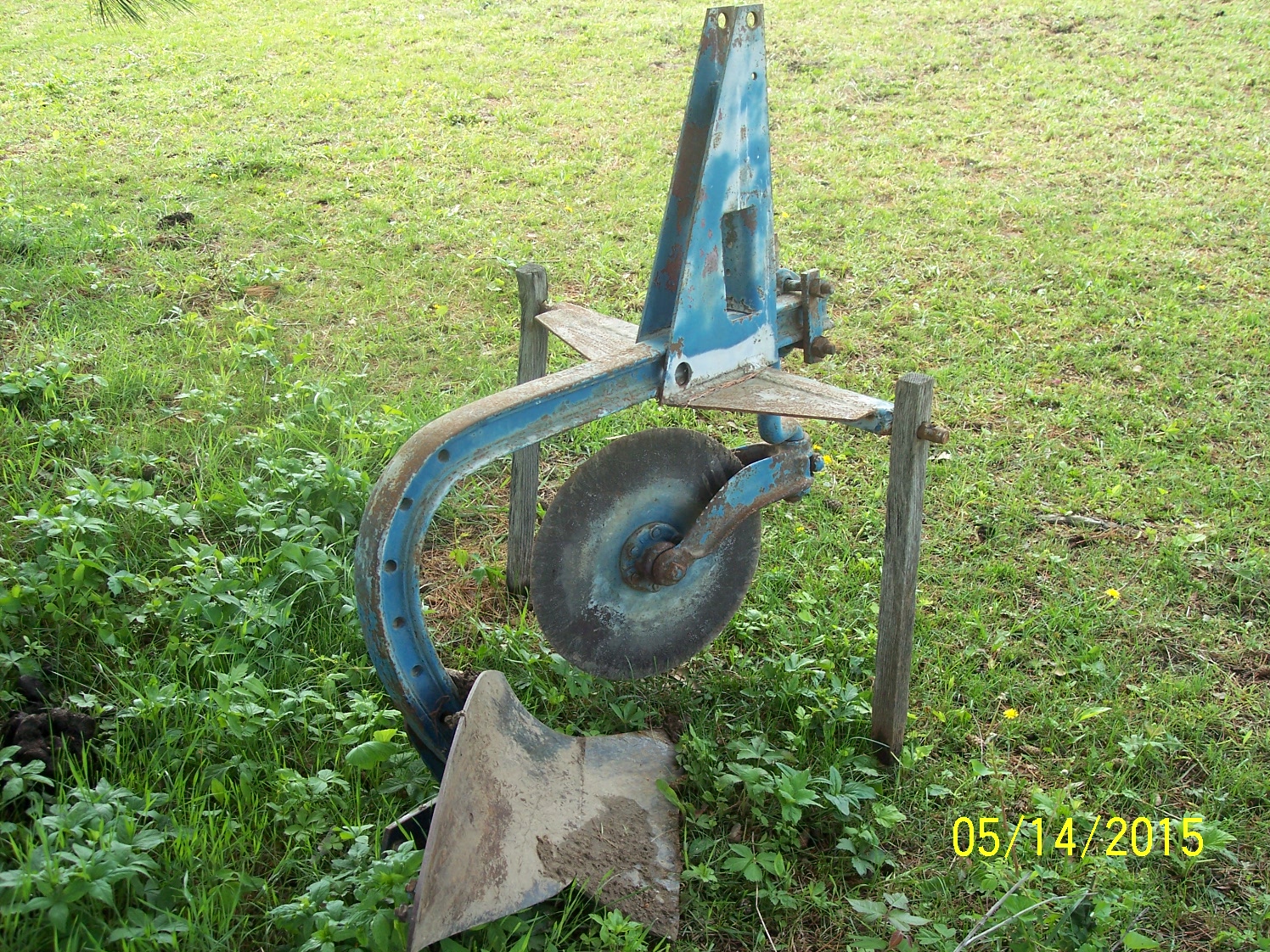

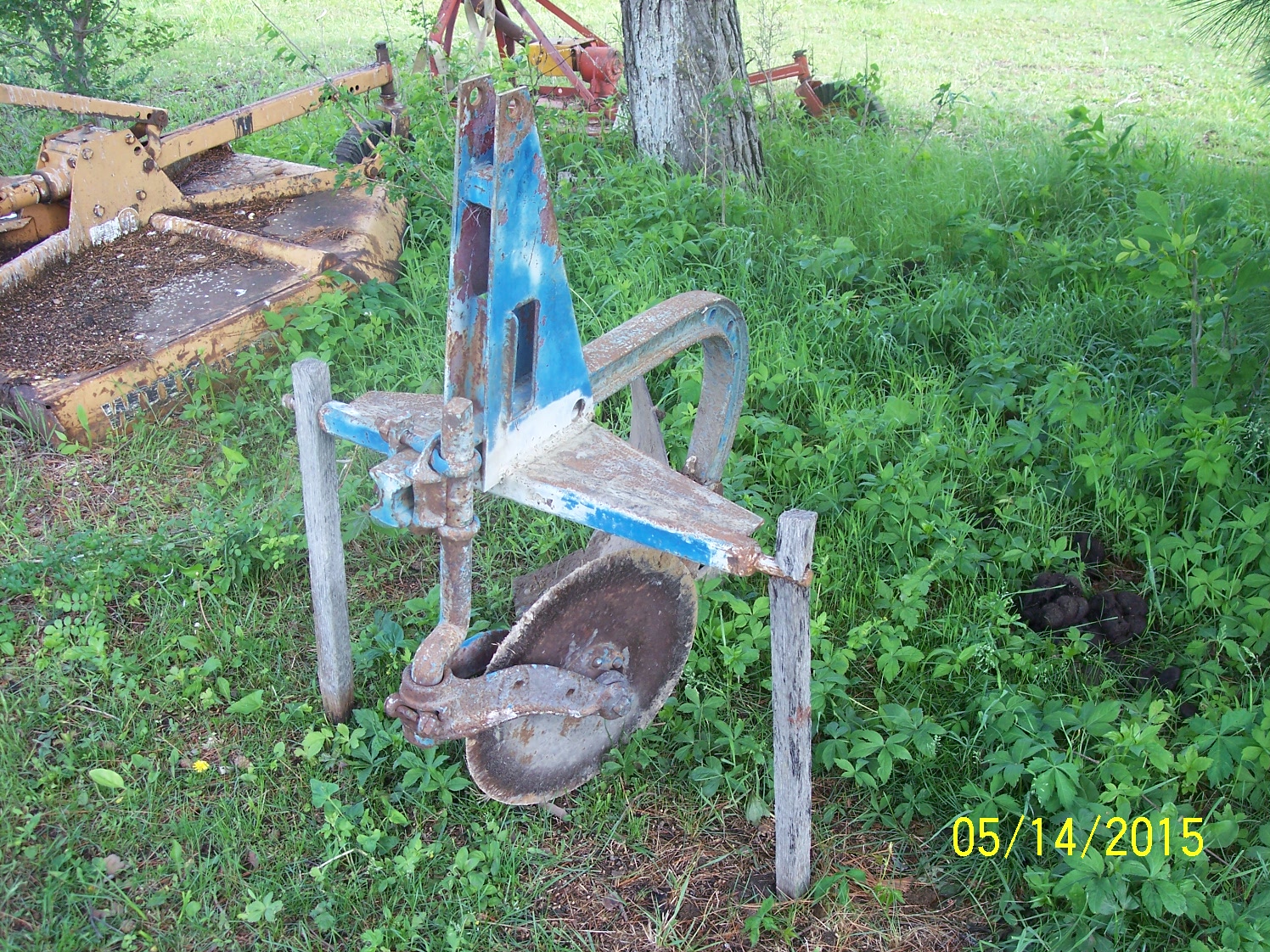

I had an old 2 bottom JD plow. Removed one beam with the plow and rolling couiler, then welded the 3 pt arms back on with bracket for top link. Been using it for 30 years!
