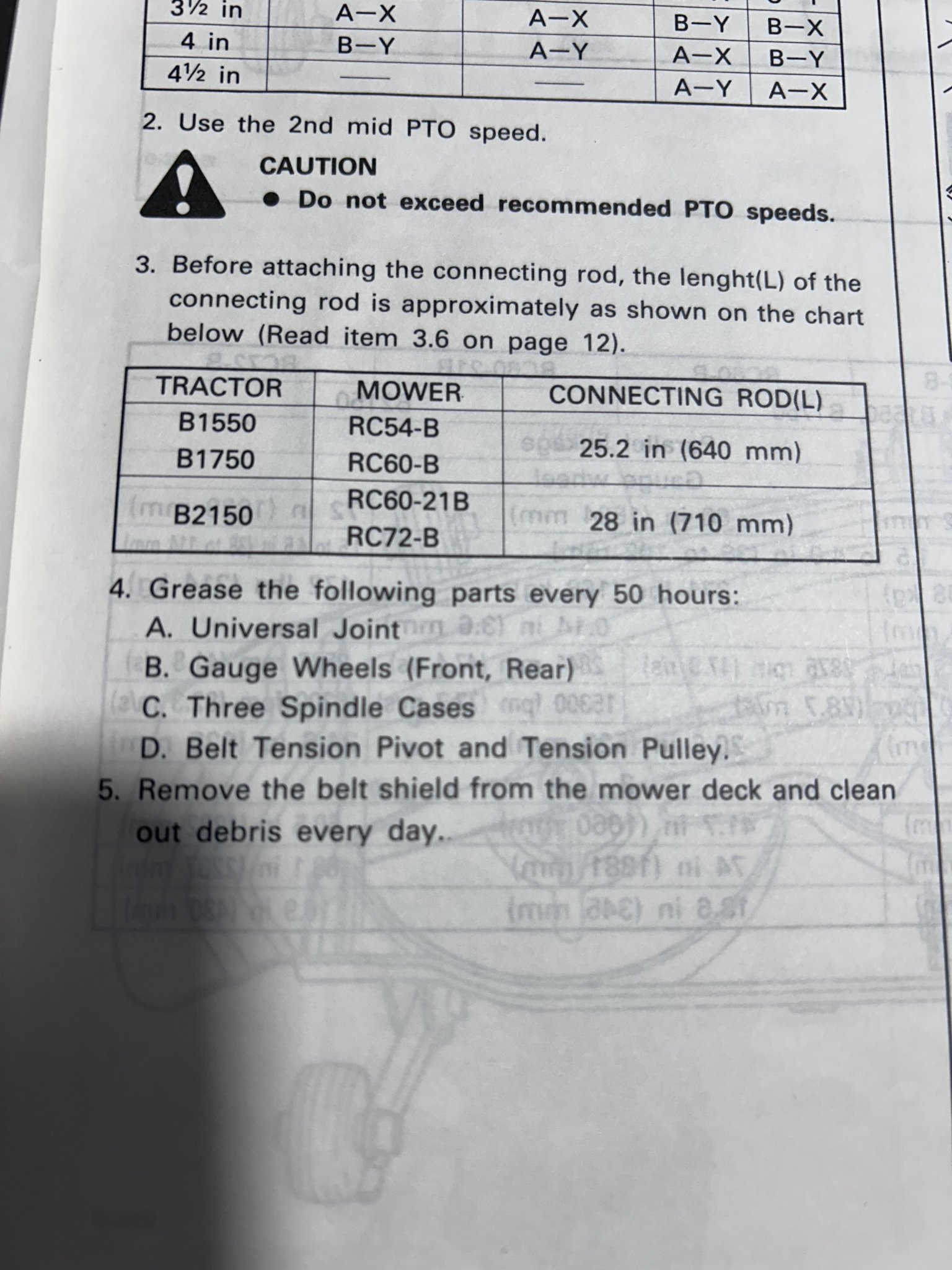

I am trying to help my brother buy another mid mount mower for his B1750. The deck he is replacing is a RC60-B. Does anyone know if the RC60-21B will fit? The deck sure looks similar in the picture. Even if he had to interchange some of the attachment connections on the decks, would the basic deck be the same?

I wish someone answered this over the last 5 years i now have the same question.
Local to me is someone selling a rc60-21b they said it came off a b1750 but according to the manual rc60-21b is for b2150s.
