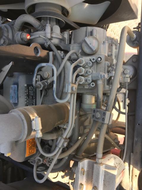

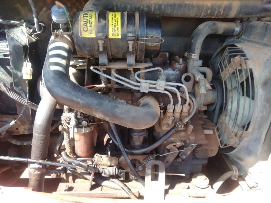

Hi there. Anyhow I have a excavator that's around a 1995 model. Has a D1105 engine in it. It has very low compression will not start. I have a friend who has a 2007 toro groundmaster with a d1105 in it. My question is will a 2007 D1105 exchange with a 1995 D1105. Engines do look different. But I'm wondering if the blocks are the same. Where I can exchange parts from the two. Posted 2 pics of the motors

Yep they are the same engine, just external parts have been changed.
You should be able to swap over all the parts that you need between the two.
You might not need to change some, one example, like the front gear case cover has an oil fill where the other has the oil fill on the valve cover, if you need the one with the valve cover fill, just swap the valve cover and forget about the gear case cover swap. ;)
If you have to change the oil pan, check the pick up tube to make sure it's the same, or swap it too.

They might be the same...or they might not.
A D1105 has a lot of different variations. The basic short block is basically the same. But in some cases that's where the similarities end.
Similarly, I'm looking at a K008 mini-excavator, with a D722 engine. It makes ~10hp, and is governed to 2050 RPM. But a D722 in my G1900 turns 3500 RPM on the governor and makes about 18hp. BIG difference; if I were to put the G1900 engine on the excavator, it's possible that the hydraulic fluid would be overheated, wheel motors turning too fast, way too much fluid volume, fuel usage goes way up, the little radiator may or may not be able to cool the engine with elevated RPM, the engine turns too fast-among a bunch of other issues.
If at all possible, just rebuild what you have. If not possible, swap all the governor and fuel injection pump parts from the excavator to the toro engine, and be sure to re-time the injection via shimming. Not hard, but slightly tedious-or it "can" be anyway.
I've known guys who've bought D1105's from excavator and then put it into an RTV1100....to find out that it only will go about 10 mph and take forever to get there, because the governor is different. All that work, just to yank it back apart...and on an RTV1100, it's not an easy task to have to do!

I also took what lugbolt is saying and factored that into my saying that it should work.
I guess i could have asked more questions, like exact models of each, but on average the Mini Excavators and Toro Groundsmasters of each of their eras both share the same running parameters.
One thing to not is that I think the Toro is running a turbo on their engine where the Original is not.
I personally would swap it over to be a turbo engine over the stock natural aspiration. ;)
2 motor models that are particularly problematic in swaps are the D722 and the D902 as they varied a lot from model to model, and as Lugbolt said there are a ton of other parameters that can change with these motors.
If the OP runs into swap issues, I would like to hear about it, and would help him work through it. ;)

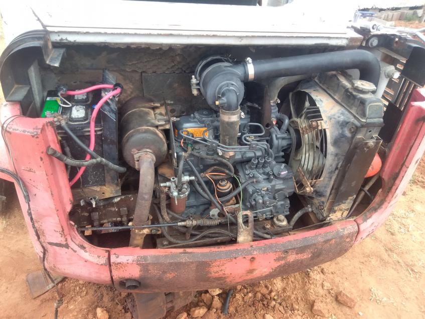

I have the toro hear at home already. Also I pulled the engine from the toro already. Gonna pull engine from the excavator soon. See what all I have to change. I think the excavator engine is a 3000 rpm and it says on a tag 21 horse power. I think the newer toro has few more horse power then 21. The toro is a 2007 toro groundmaster 3100D. Will upload some pics
