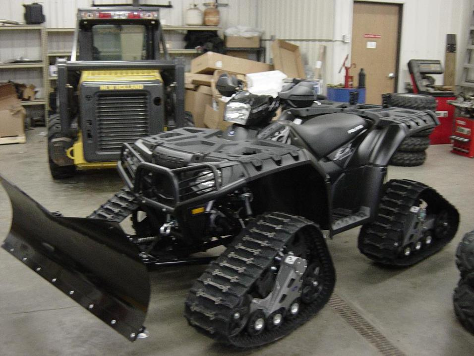

like this... independent suspension with 4 tracks! watching those quadtrac and rowtracs working the fields is very impressive... so why not a kubota quadtrac CUT with independent suspension?
my bro n law has this same set up on his
polaris for snow removal round the house... dirty road and hill he's gotta deuce-and-a-half with plow for that iowa snow.

People are crying about the price of tractors and then ask for tracks and independent suspension on all four. I give up.
