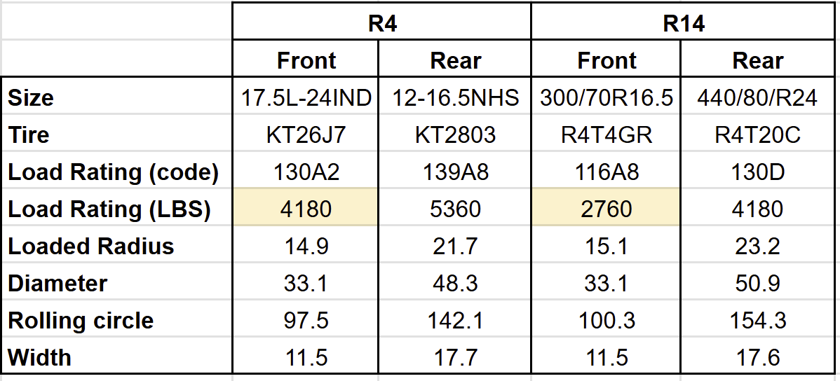

Looked up the actual tires on the tractors.. And wow, the load rating of the fronts differs significantly. Does this matter in practice? No idea.

Depending on what you plan to do with your machine, those specs you identified could be important.
Another spec item I would wonder before making decision are the outside tire diameters. IMO bigger diameter smooth the ride. Although if the R14s are a little softer that might be a push or very negligible at best.
if planning to fill with fluid for ballast, tire volume would give ability to add more ballast in tires if that matters. Not sure I have seen a spec for volume but diameter and width should be a good indicator.
According to the specs, the R4 are a little shorter actually. I updated the table above.
I don't mind shorter because I have a lot of hills, so lower center of gravity is good.

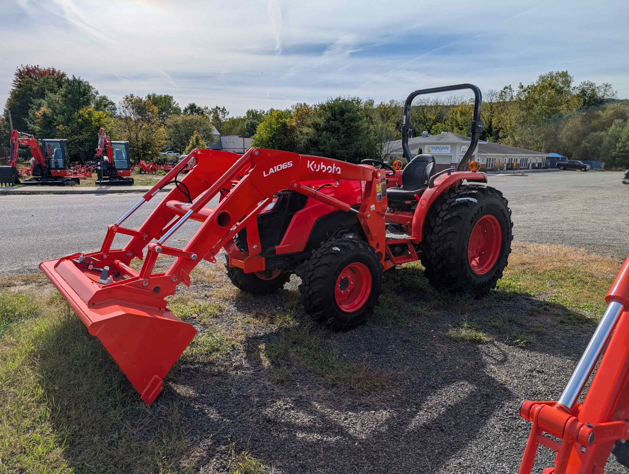

speaking for myself I am ready to see some pics of your machine. Happy shopping.
This is it! It has R14 now but they will swap the R4 off the cab MX they also have if I want them.

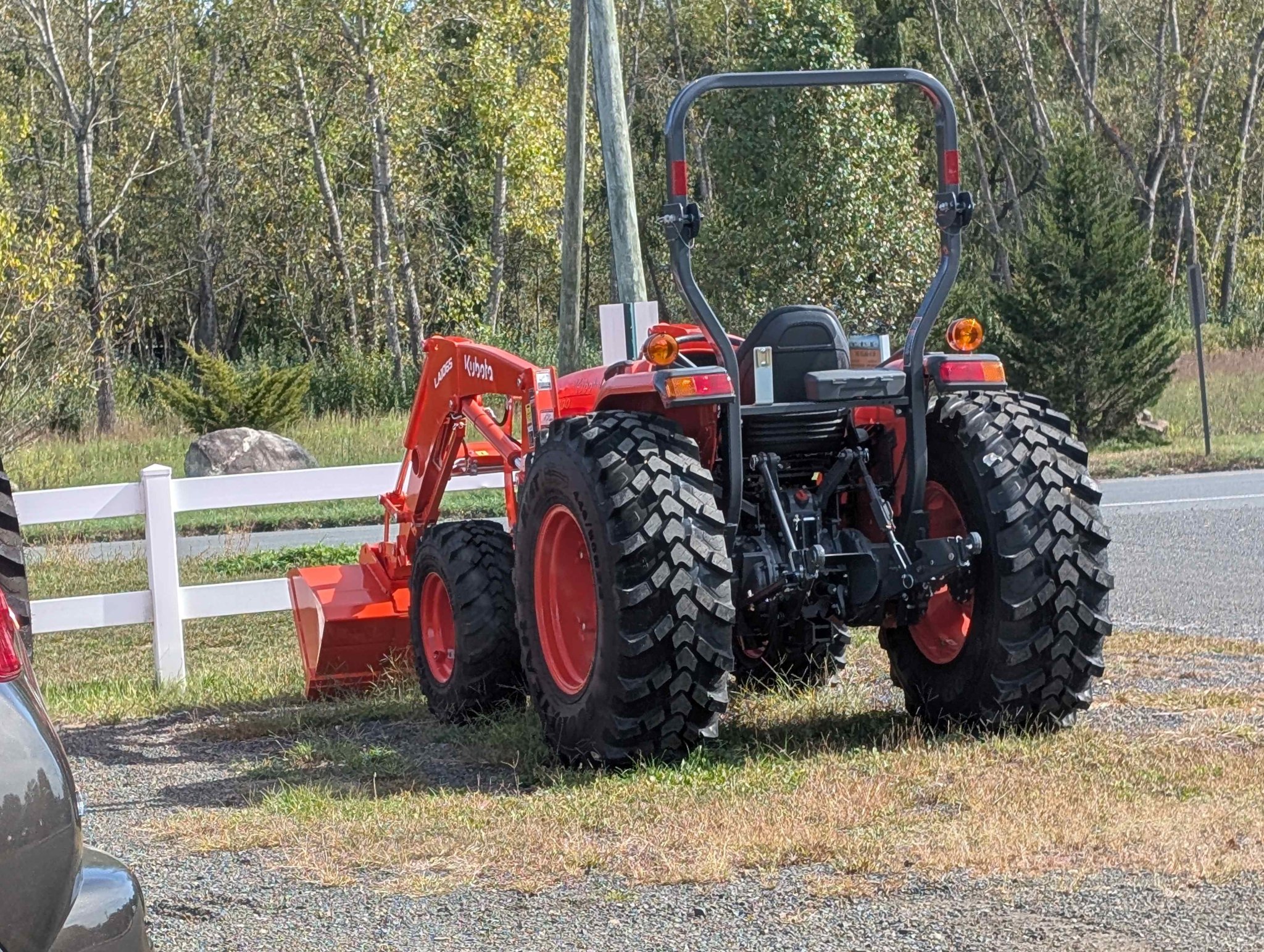

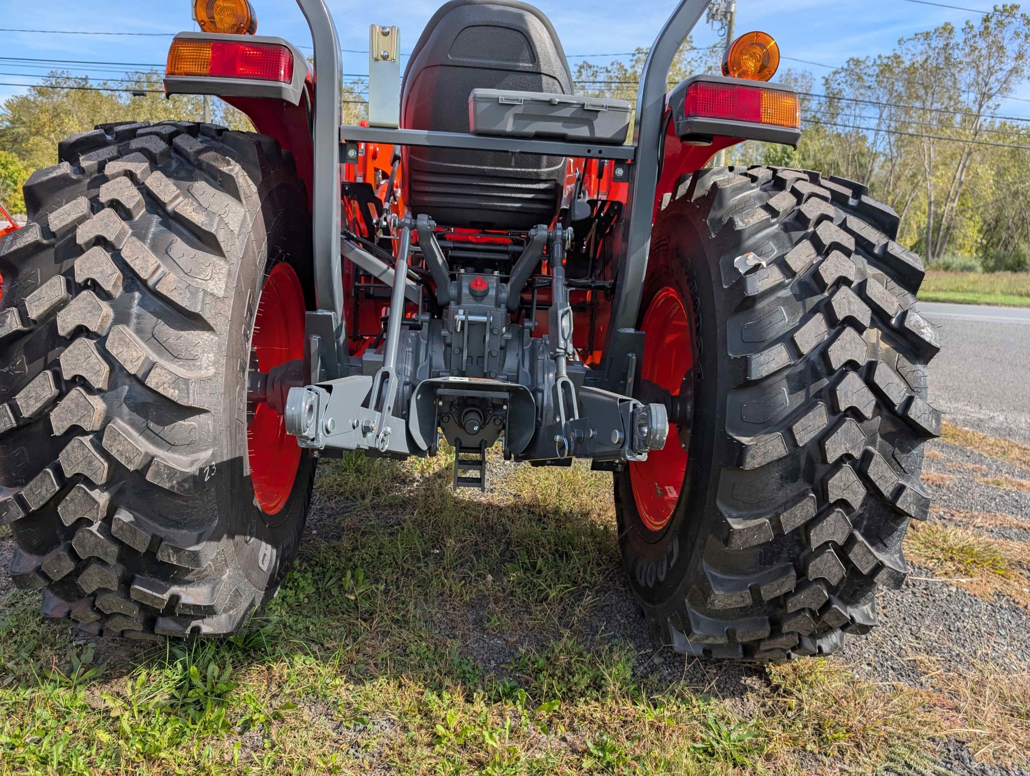

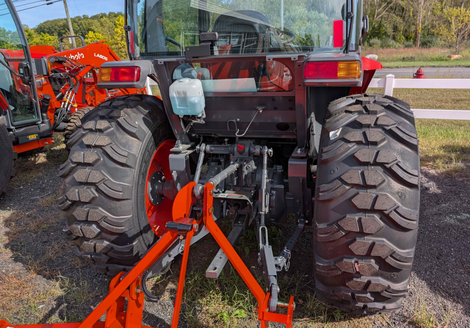

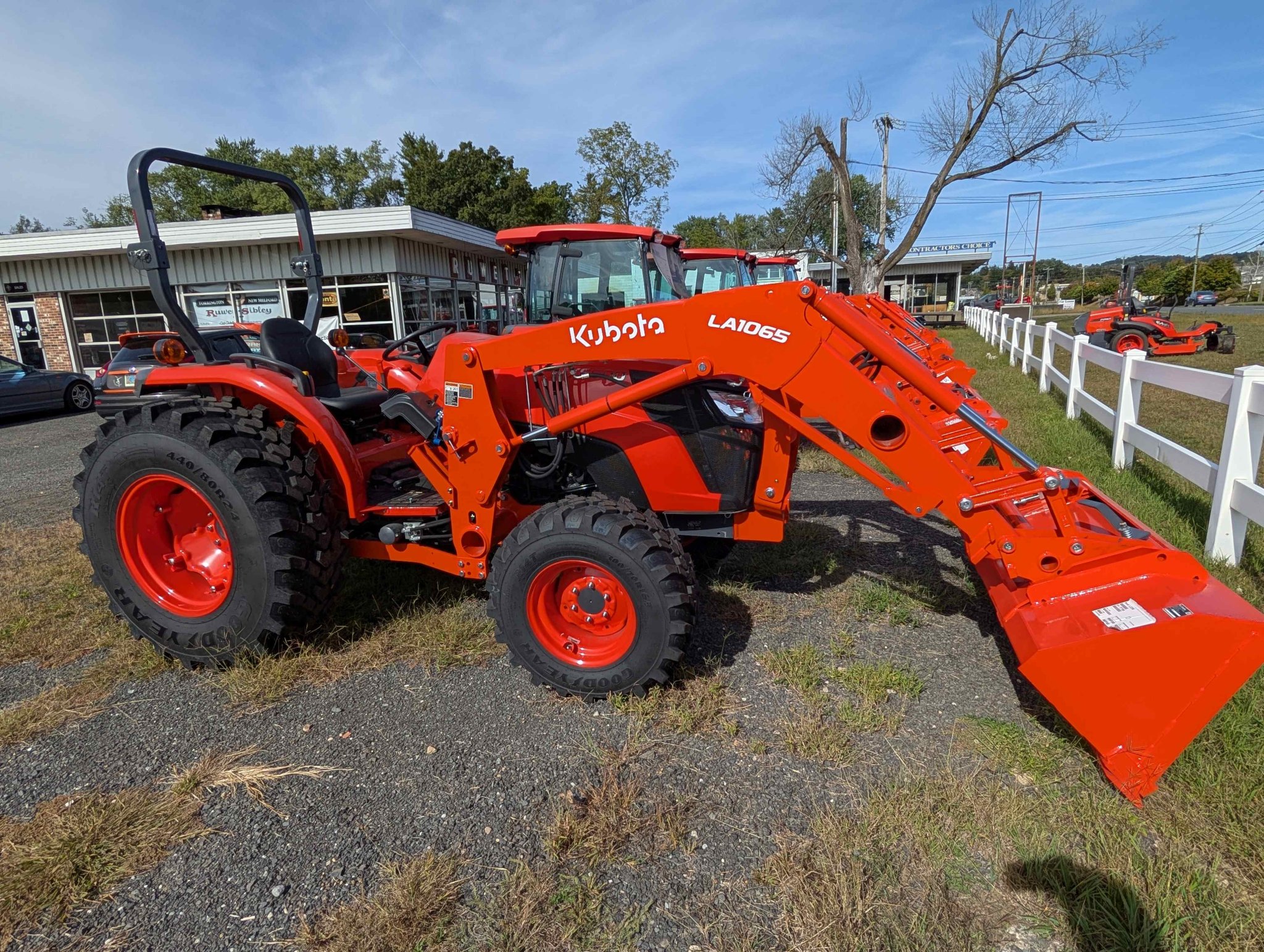

View attachment 163511 View attachment 163512 View attachment 163513 View attachment 163515 View attachment 163518
Did you drive both? Might be interesting to see if they feel much difference going down the road. I’d want to drive and feel if any difference before decision.
You aren’t comparing the same size tires. That’s going to lead to some load capacity differences. Also, if you are going to use the tractor that hard to blow out the tires, then you are buying the wrong tractor for the job. You something that is more rugged. R4 tires suck in mud or slimmy situations compared to other types of tires.
