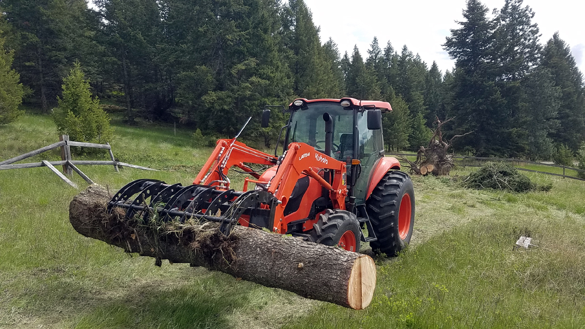

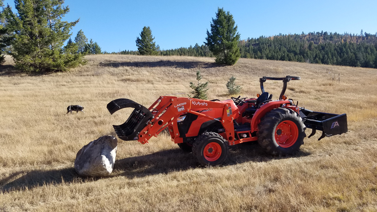

If you primarily use a grapple to move brush around or do light work, just about any grapple will do, but obviously some are better suited to picking up large piles of sticks and stuff than others. If you move a lot of rocks around as I do then you might want the strongest and lightest grapple you can find. So far the EA Wicked 60 has been the ticket for me moving large rocks, big tree trunks and old railroad ties. If I'd known that I was going to end up with an M6060 I would have chosen the Wicked 66 but I wasn't born with the "gift" of prognostication.
