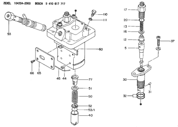

All, I recently had to clean the injection pump for my G2160 - got a lot of c**p in the pump. The pump is a Zexel pump for D782 engine.
Now, the O-rings are worn, and I accidentally broke the bearing pin (a little cylinderical dowel) as well.
I checked my local Kubota dealer and they can only sell me the whole pump at $1,047. I also tried several online dealers including Messicks, and nobody can sell the O-rings or the pin, and ironically they don't even see the exploded view of the injector!
Please help!
Injection pump for D782
Zexel pump 16006-51020
6,015
3,252
Item 31 is the pin

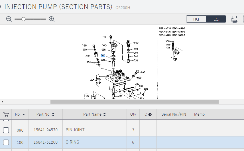

Any idea where to get item 32 for a G5200 or a D600 if they are all the same? I have delivery valves leaking....
Also, where is that part diagram from??
